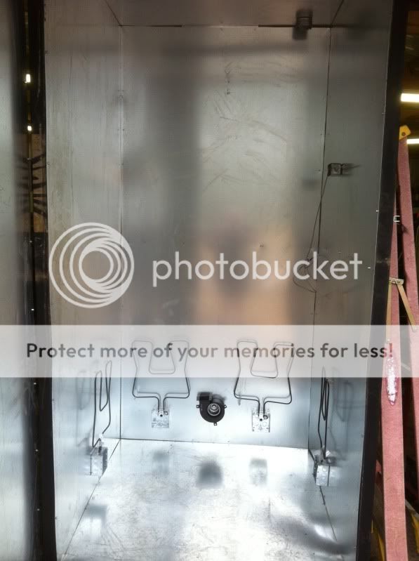

I got my elements and temp probe installed this morning. I will insulate the rest of it tomorrow.

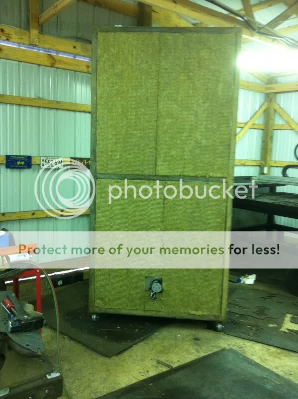

I got it all insulated today, gotta fine tune it around the fan motor. I hope to get the last 3 out side panels on tomorrow.

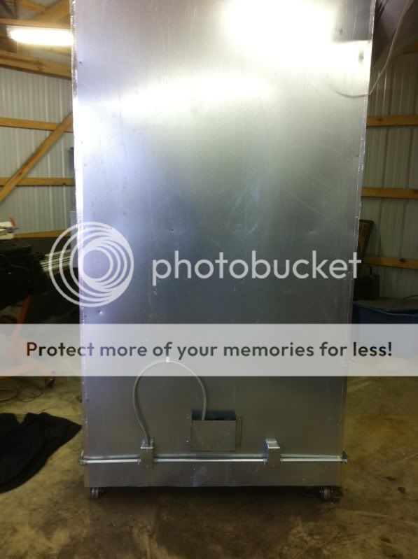

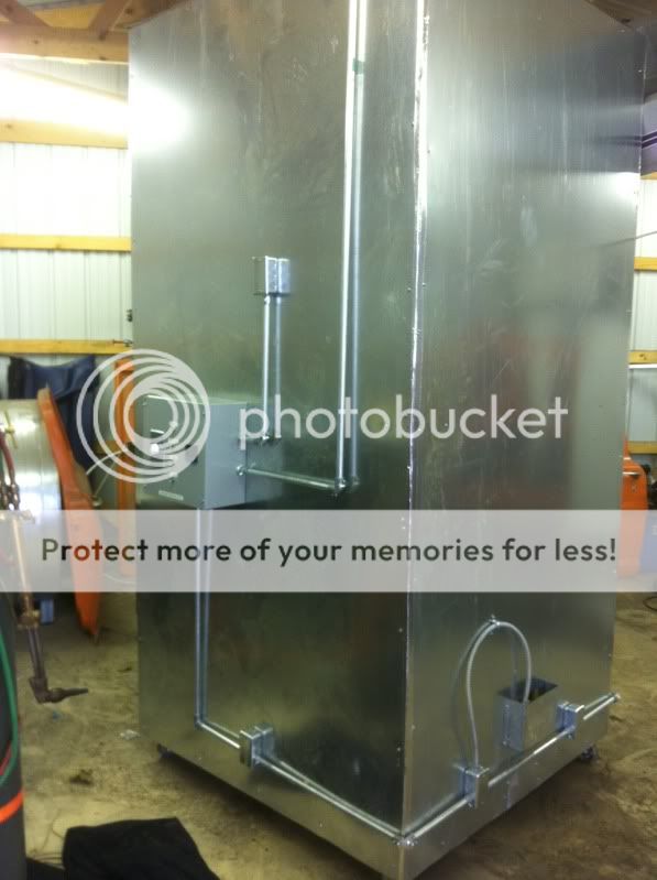

wickedinhere

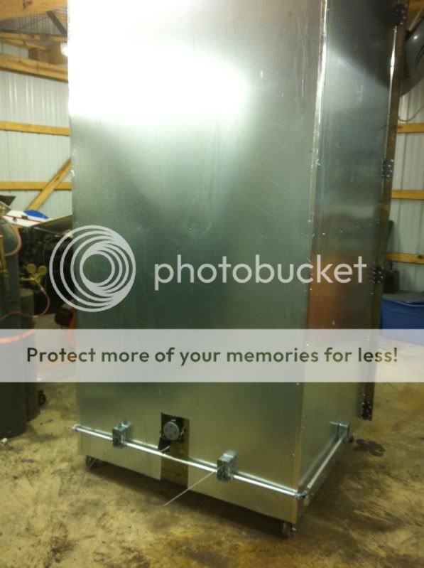

I got the oven all wired up this morning all i have to do is seal it all up and install the door seal.

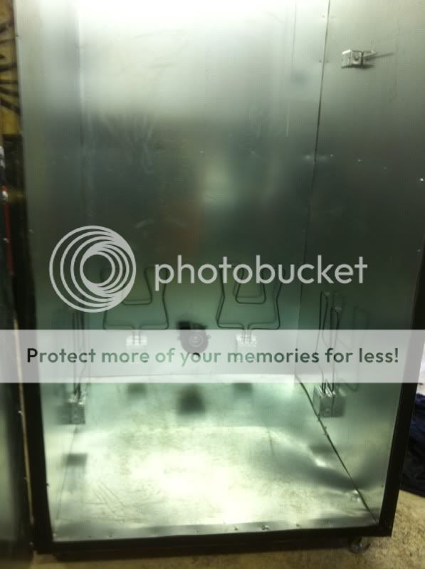

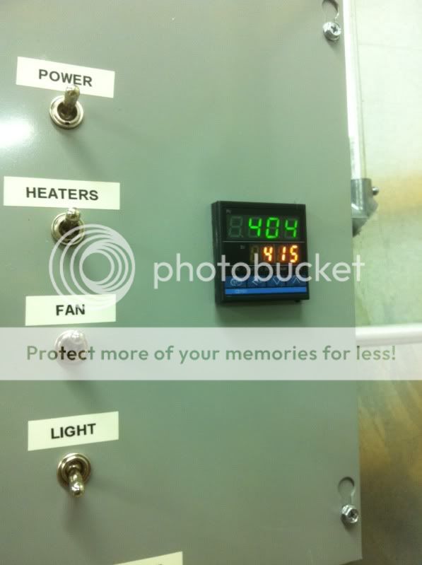

wickedinhere

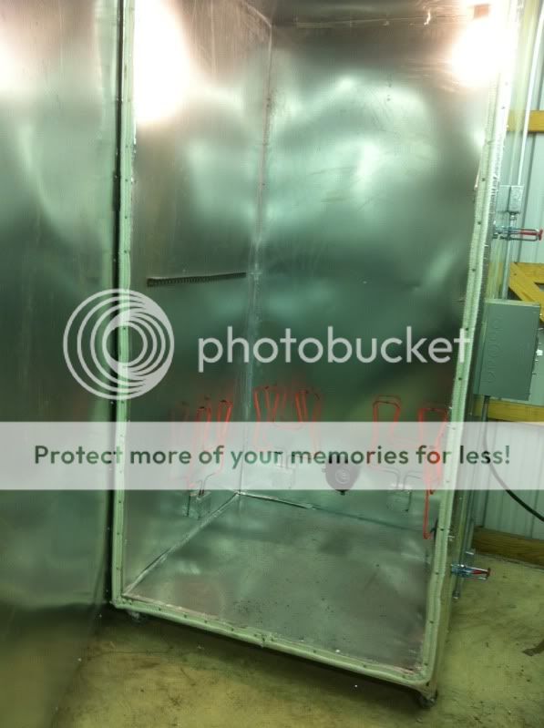

I got her fired up today she hit 400 degrees in about 17 minutes. I had to bump the controller a little over 400 to make it hit 400 but i am not exactly sure how it works because i did get any instructions with it.

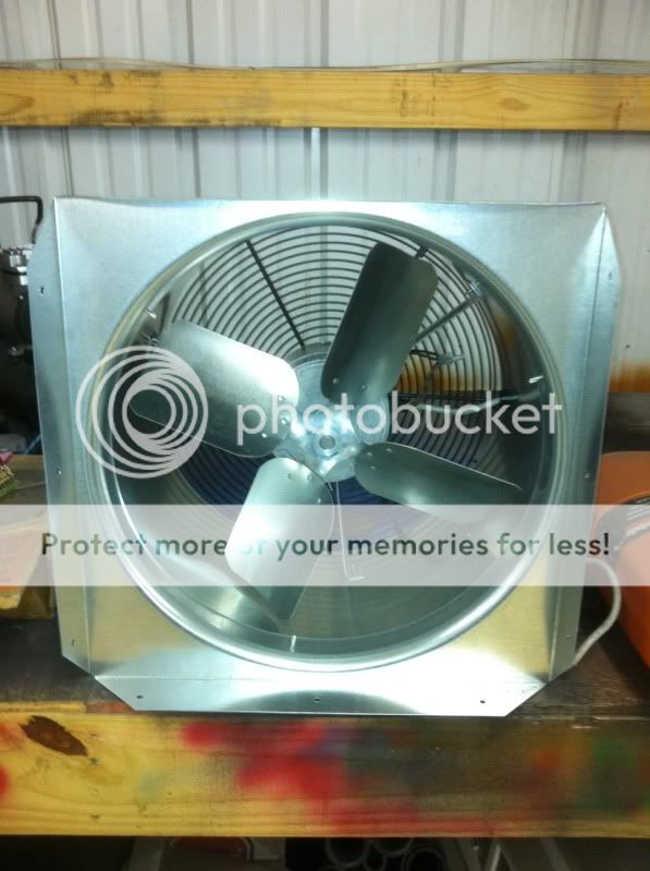

wickedinhere

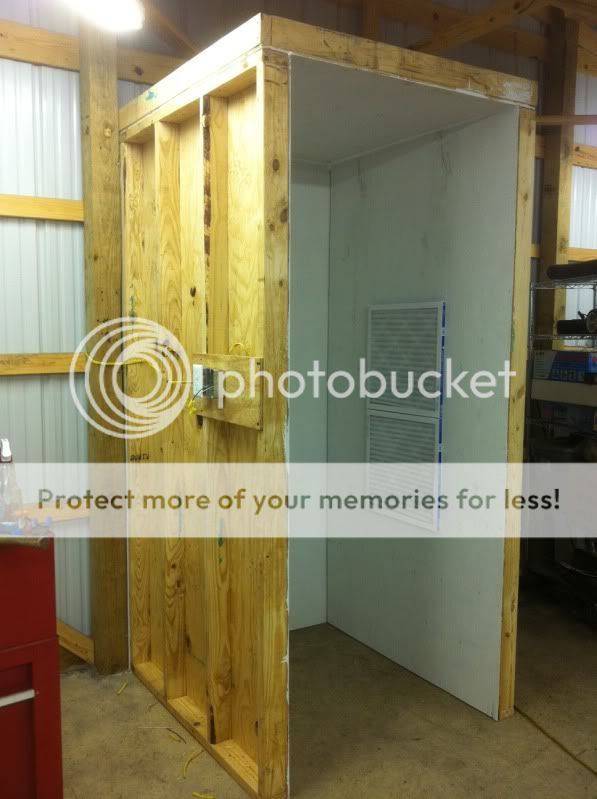

I got a couple of the powder booth walls built and painted this morning. I hope they dry by this evening so i can stand them up. I put a fan pic up i will be using 2-20x20x1 filters more to come.

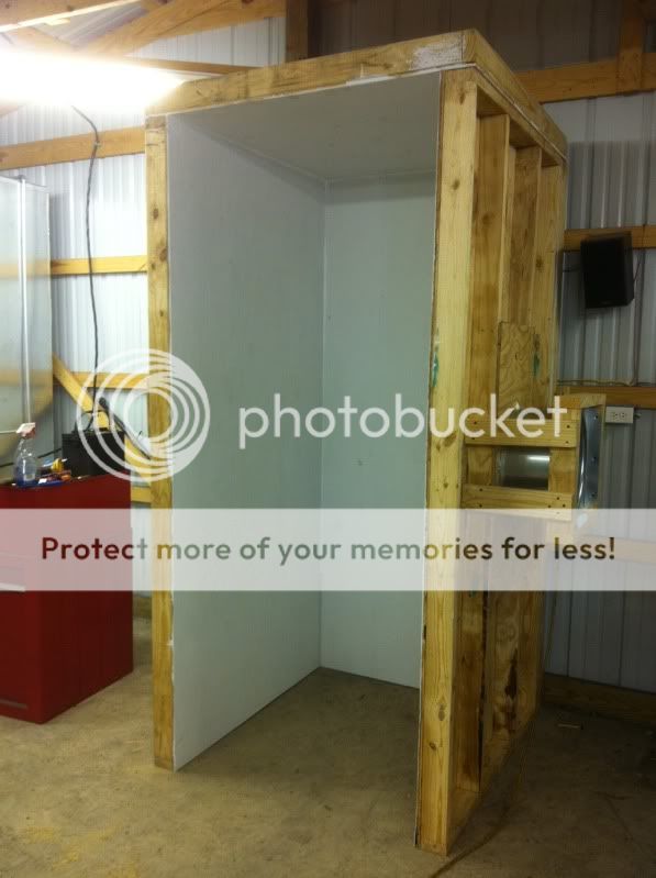

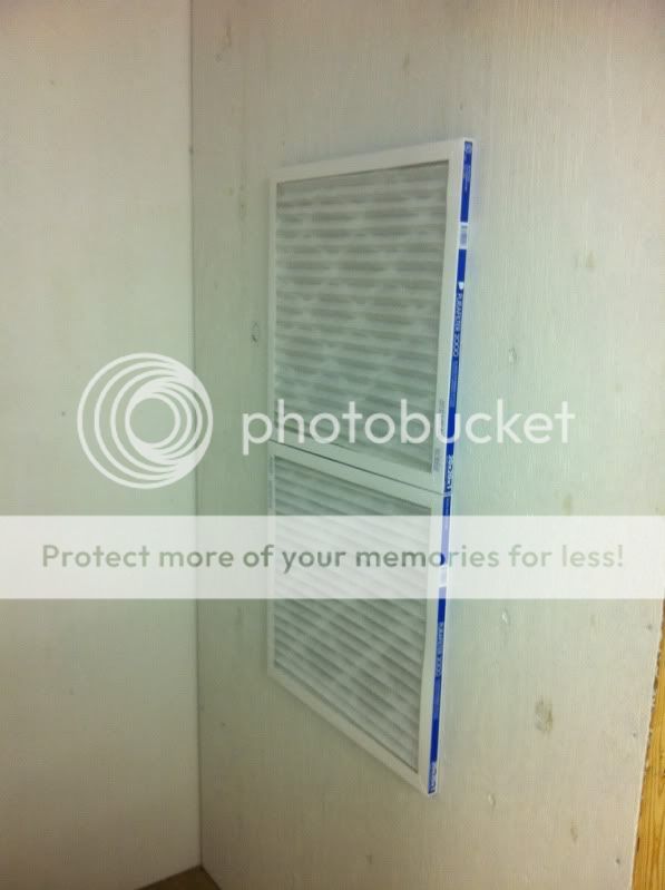

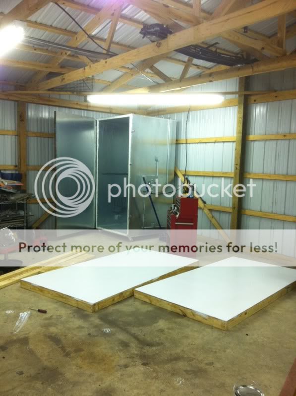

wickedinhere
Got 2 walls up and got the last wall built i just have to cut the opening for the filters then paint it and stand it up. Then start on the top then get the fan setup.

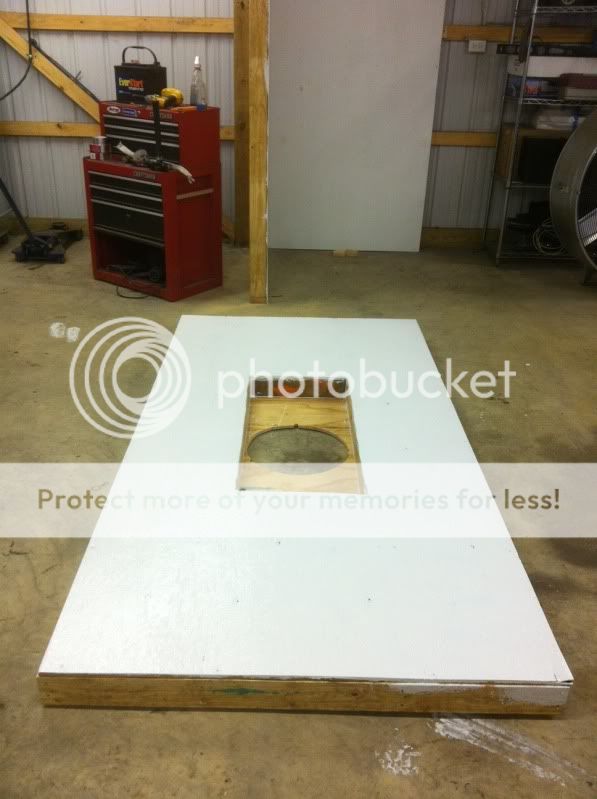

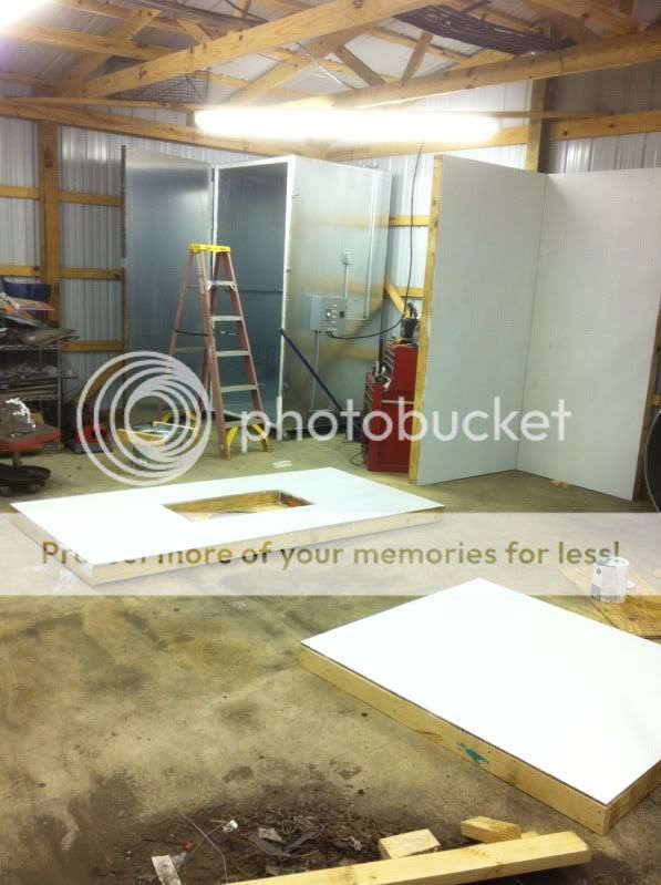

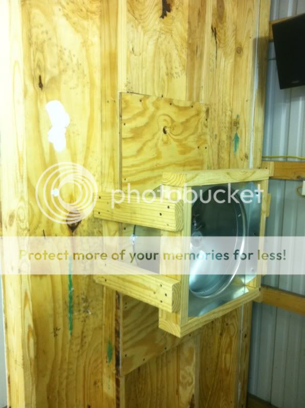

wickedinhere
I got my filter box built and the top done and painted just waiting on paint to dry.LOL It will probably take all day to dry cause its been raining like crazy.
[IMG]http://i20.photobucket.com/albums/b235/wickedinhere/photo350.jpg[/IMG]
[IMG]http://i20.photobucket.com/albums/b235/wickedinhere/photo349.jpg[/IMG]

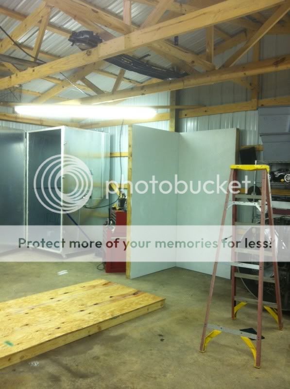

I did a little work this morning. I need to go pick up some more stuff to finish it, lights and some more electrical boxes and silicone.
[IMG]http://i20.photobucket.com/albums/b235/wickedinhere/photo354.jpg[/IMG]
[IMG]http://i20.photobucket.com/albums/b235/wickedinhere/photo353.jpg[/IMG]
[IMG]http://i20.photobucket.com/albums/b235/wickedinhere/photo352.jpg[/IMG]
[IMG]http://i20.photobucket.com/albums/b235/wickedinhere/photo351.jpg[/IMG]

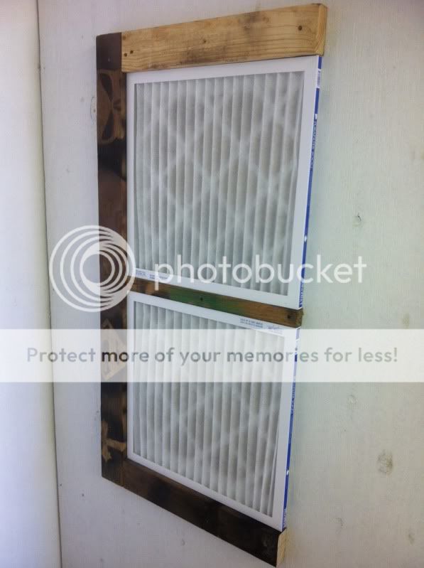

I almost finished but came up 4 foot short on my 2x4 count. LOL here is the filter setup just short one board oh well.
[IMG]http://i20.photobucket.com/albums/b235/wickedinhere/photo355.jpg[/IMG]

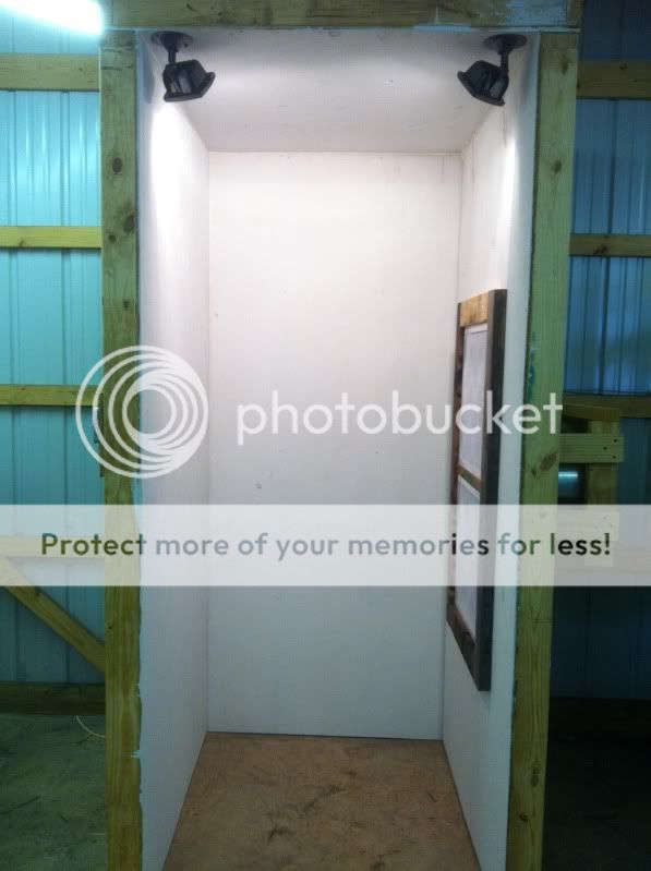

Well almost finished got the lights up just need to run air to the booth and put my hanging rod in and i will be coating. :D

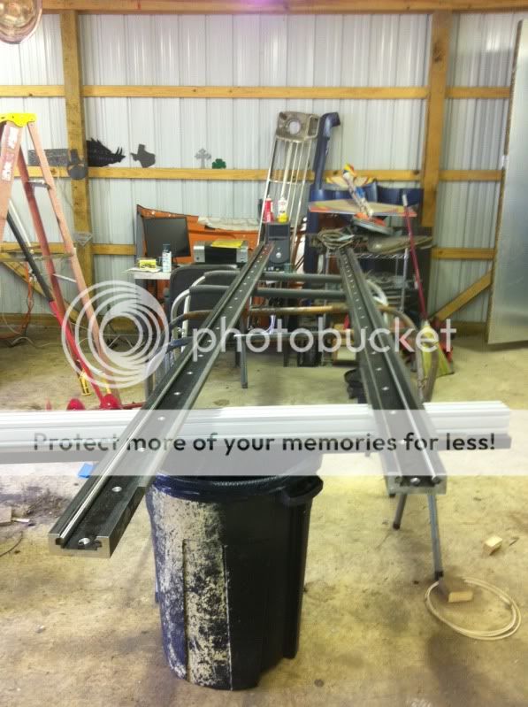

wickedinhere
I got my rails in today man these are beefy!
[IMG]http://i20.photobucket.com/albums/b235/wickedinhere/photo374.jpg[/IMG]
Yes and heavy...and expensive!
Charlene
I know, we were very impressed with them.
wickedinhere
I need to get some steel and get to work.
Yes and make sure its grade A not the cheapest twisted metal tubing for under $.50 a pound ;)
wickedinhere
I hear ya, my metal yard dont sell that cheap stuff.

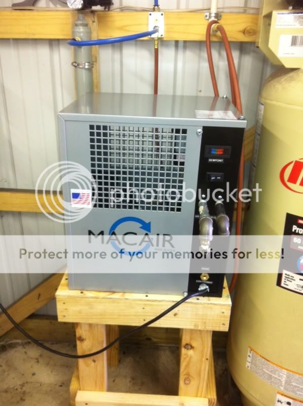

wickedinhere
Had this little jewel show up today.
