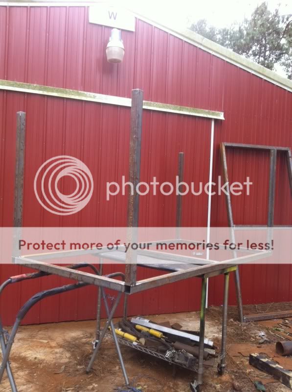

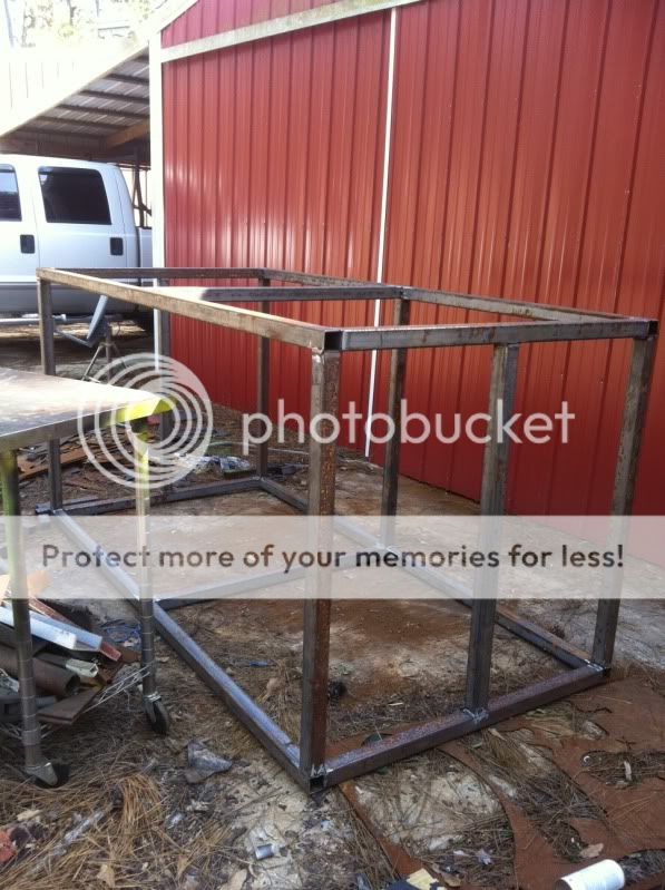

Started welding up the frame of my powder coating oven gonna be 4x4x8
pics of course when i get this done i will jump on my 5x10 table.

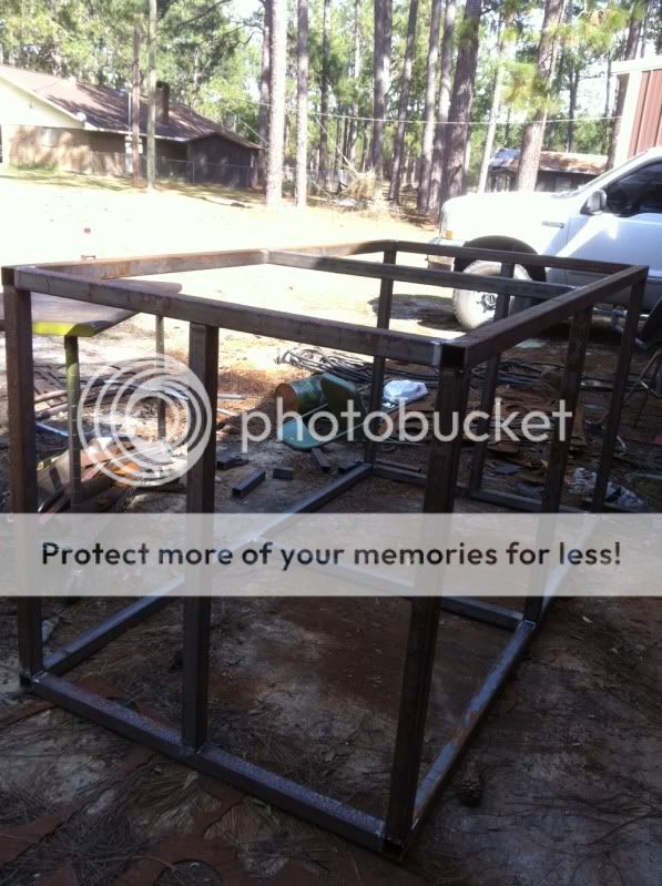

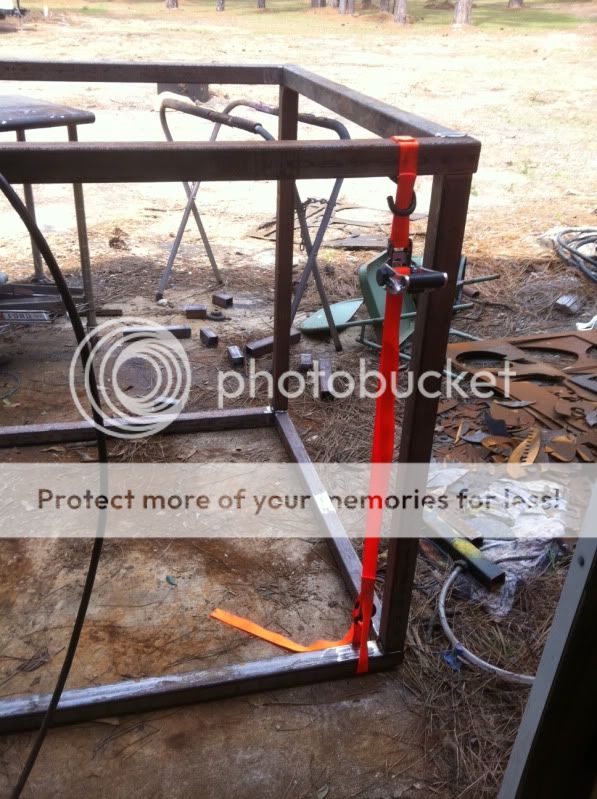

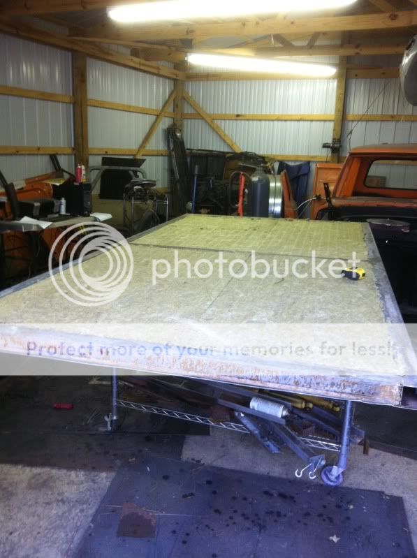

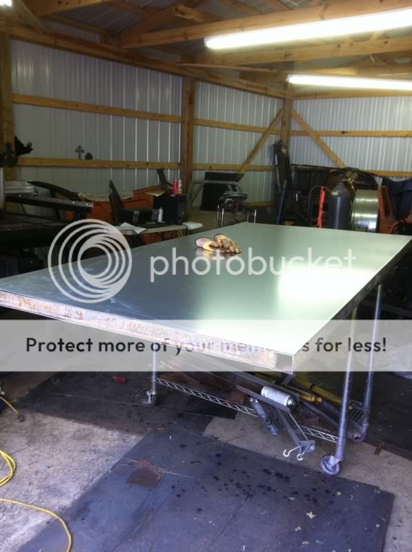

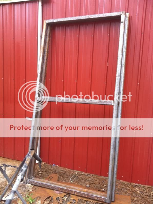

I got the frame finished gonna put the door and wheels on tomorrow then put some picklex 20 on the frame then hopefully start to sheet it monday.
I had to use a orange strap to tweak the frame a little bit.LOL Dont mind my mess.

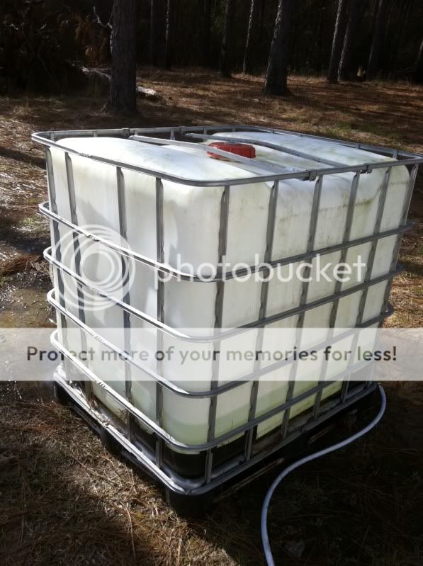

I scored a new much larger container for acid diping my parts this morning. I am checking for leaks it will be nice to dip bigger parts now.

This made us think of a question. What do you do with the old acid bath? How do you dispose of it? Or, do you just keep adding to the old stuff?
wickedinhere
It doesnt really get dirty, i havent had to change mine yet. I only dip parts that i use steel fx on cause you have to get the mil scale off to get a nice finish.

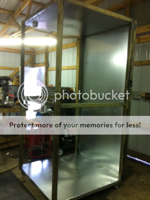

wickedinhere

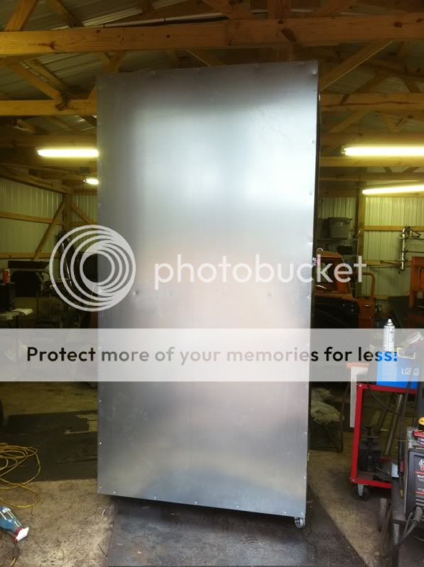

Got the door on and stood this monster up.

ssray
[QUOTE=wickedinhere;131621]Got the door on and stood this monster up.
[/QUOTE]

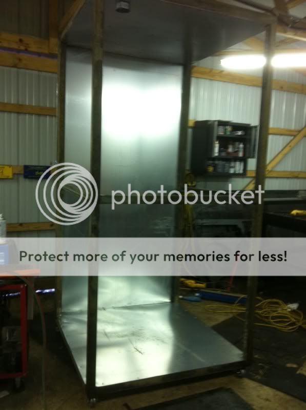

Lookin good! I assume the yellow in the pic is insulation. What did you come up with for insulation? I'd like to build an oven someday as well. Maybe not as big but I suppose some part or item would show up that's bigger than what the oven is. The thought crossed my mind that a divider could be built to section the oven by 1/2 or 1/3 so you wouldn't have to heat the whole thing for smaller parts or batches. Just use the heating elements in that part of the oven as well as the thermostatic control.
Scott
wickedinhere
I started to do a smaller oven but i figured i better go as big as i could or i would be building another one. I used 2 inch mineral wool for insulation, i went with 4-3000 watt elements for heat.

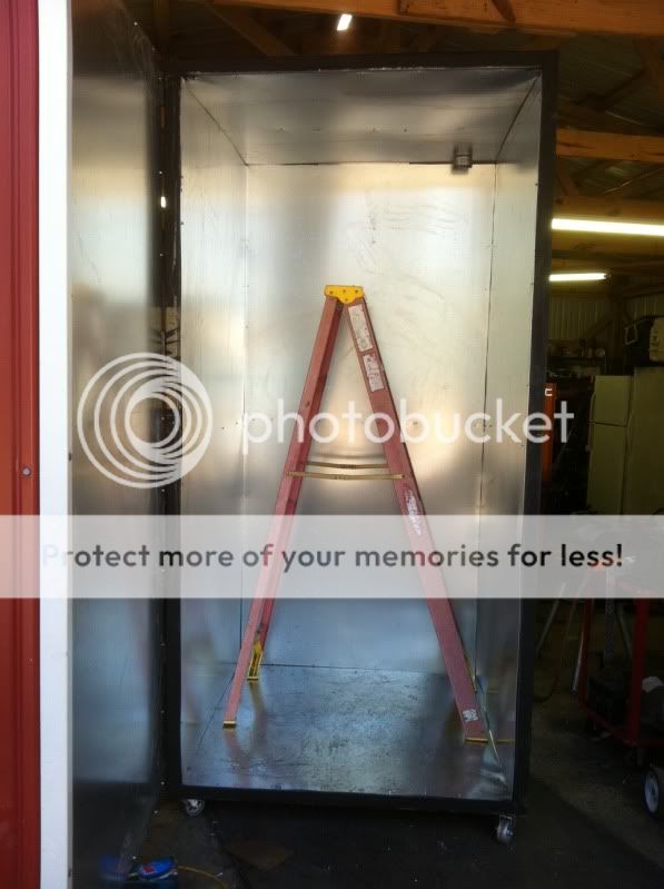

wickedinhere
Got the inside sheeted came out pretty good, only a few gaps that i will fill with flue tape.

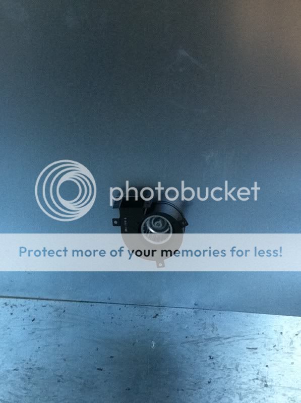

wickedinhere

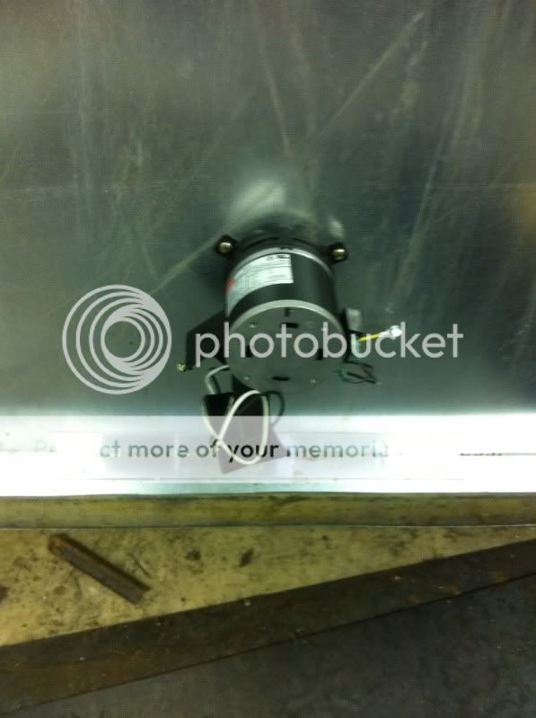

I got the circulation fan installed, i tested it to make sure it runs and it did plus its very quiet and moves alot of air for its size.
