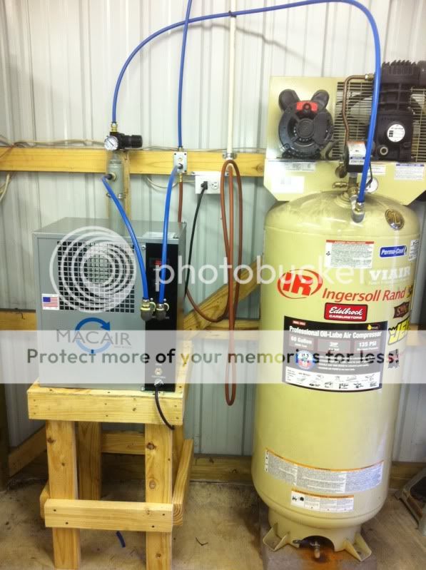

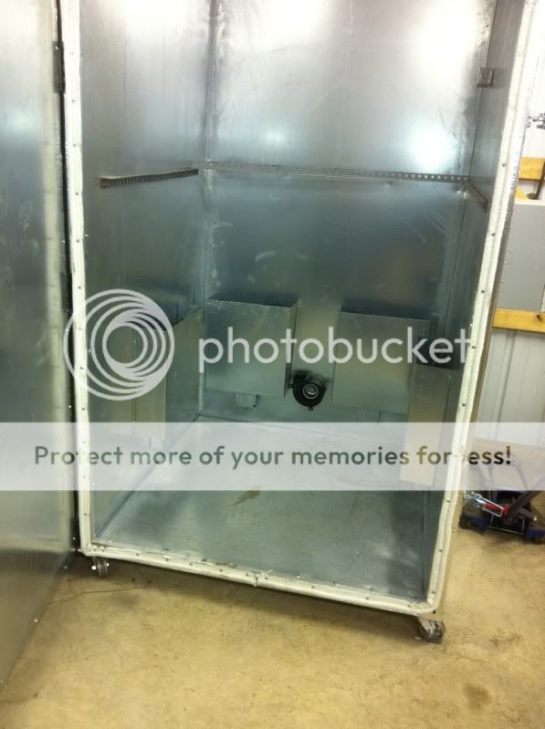

Well i got my element covers made and installed on my oven and i got the air dryer plumbed in. I went with the rapid air system for the whole shop, its real easy to install and works great.

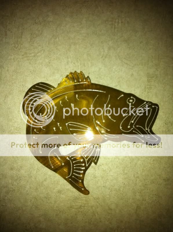

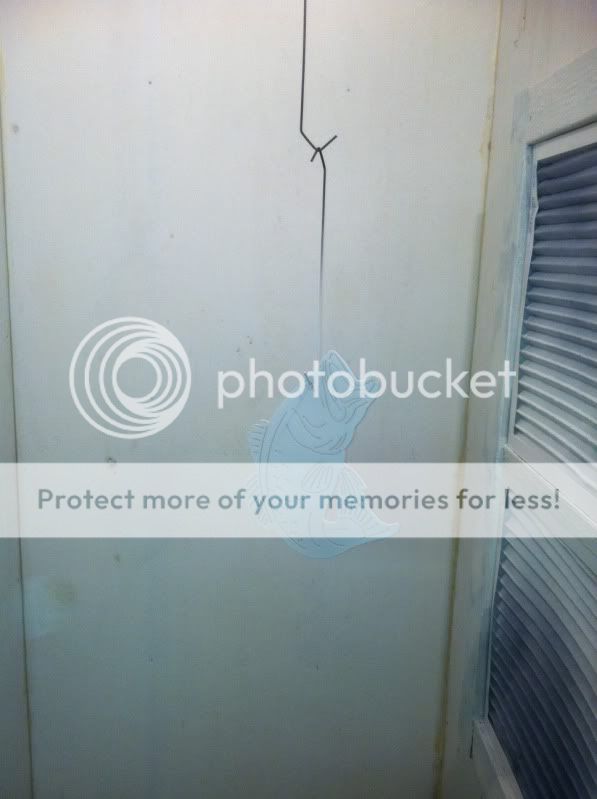

Well i fired up the booth and oven up this morning and coated my first piece i put on a bronze stain hit it with a scotch brite pad to make it more green and the coated it with 80% clear. It came out really good for my first piece I even got good coverage in the cuts, the money i spent is really gonna pay off. NO FIRE OR EXPLOSION so i guess i did it right.

That looks really good. I am glad that we have this thread to go by when it is our turn to do this. I can definitely see how it would pay for itself really quickly.

Thanks, the main reason for the powder coating setup was to use the clears over the copper and other stuff from steel fx. It looks like its gonna work out great and the weather wont be an issue anymore when finishing pieces. The clear powder only takes 10 minutes in the oven then its done.

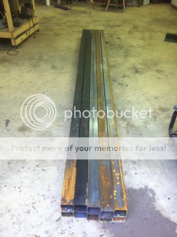

I finally went and got some tubing for my new table. I finally got a break in the weather this morning its been raining everyday since Saturday more to come.

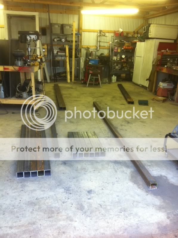

Well i got it all cut up this morning, the worst part is done.

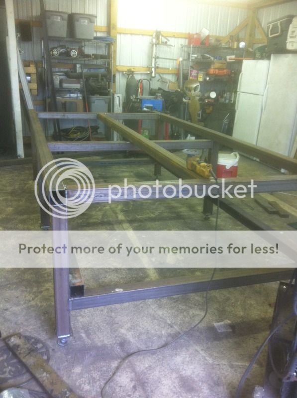

[ATTACH=CONFIG]220[/ATTACH]I got some welding done this morning.
Alright! You got the hard part done now everything below the top is non critical.

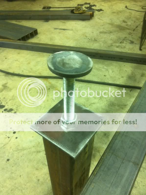

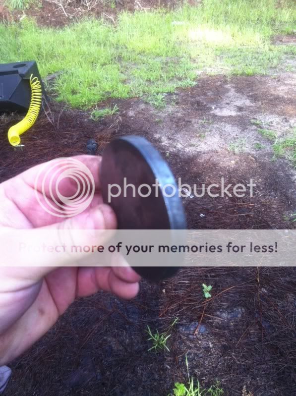

I finally got to cut some 1/4 on my table to make my adjustable feet for my 5x10. It took a little fine tuning but the cuts came out great i just had to slow it down from 60ipm to 50ipm from the book specs. Here are some pics of my cuts and my adjustable leg setup.

Nice! I have found that I really like working with the thicker material. It cuts like "buttah"!

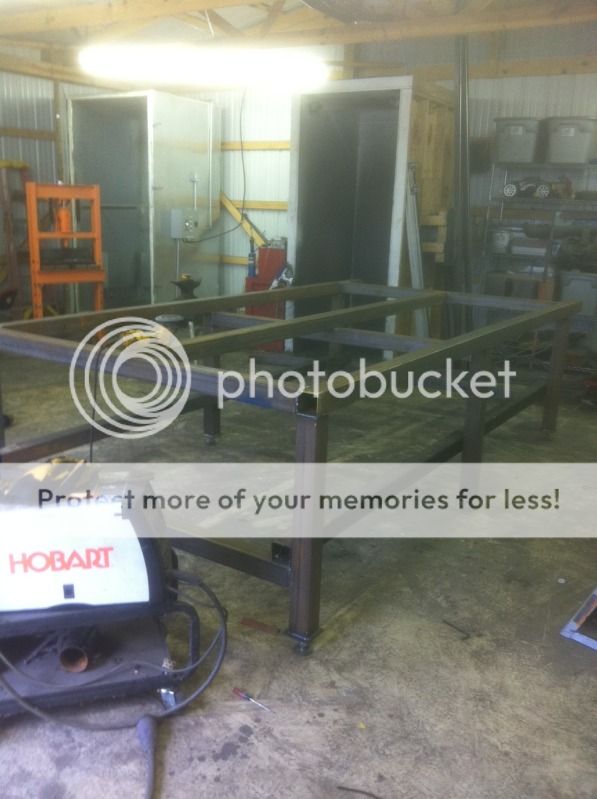

wickedinhere
I finally got all the Christmas orders out so i had some time to work on my 5x10 its gettin close.
