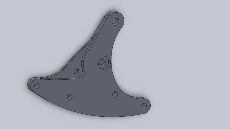

[ATTACH=CONFIG]292[/ATTACH]
Made a change to clear any and all bolt issues and power steering pulley issues for all shafts (even rebuilt units that are off)

Clocked the power steering bracket for 20 degrees left towards the water pump

Having a difficult time with pully alinement, going to change some pully lengths.

Spacers look ok find out after supercharger is in. I see the bracket that holds the water pump idle pully on needs some grinding for the lower radiator hose clearance, idle pully bolt cut on the back side also.

Still could not get alinement right , took it all apart again. Found that hump on the lower front of power steering pump barely toching the bracket. Ground a little off the bracket, thats history. Now I came to the conclusion that the two bolt holes for the long water pump bolts in bracket not alined to holes in water pump.Going to get friends for a second opinion.

The best day yet, opened up the bolt holes and Wow looks good maybe supercharger pully could go back a fraction ? But I think I will stop here, have to remake some water pump spacers.
