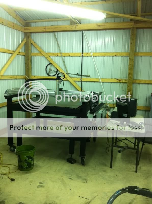

Got my slat holders in it wont be long now.

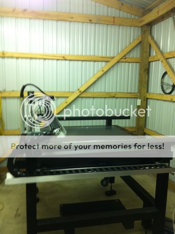

wickedinhere

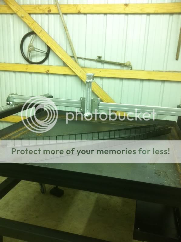

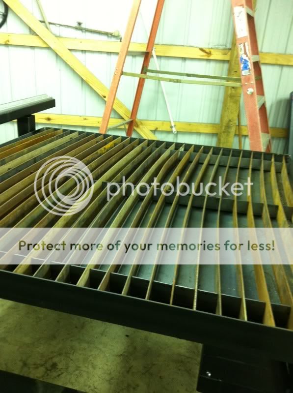

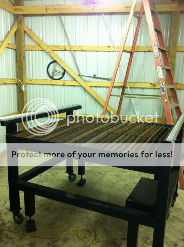

I got my water tray welded to the table and finally got the slats installed. I will start on my cable trays this coming week and hopefully get some electronics hooked up. I did my slats this way so the metal will slide in a little easier hopefully.

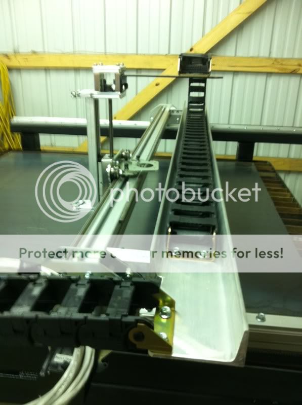

wickedinhere

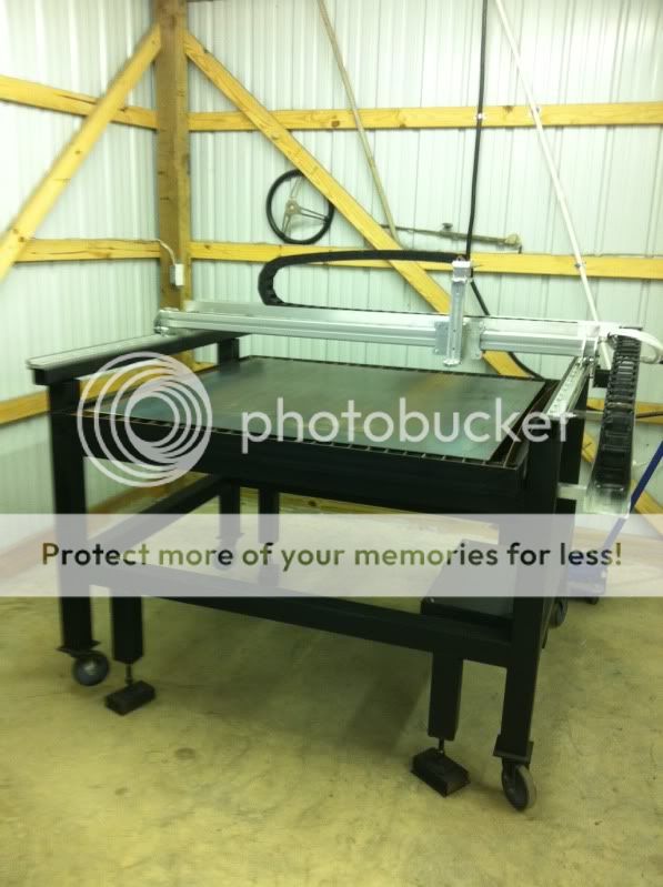

I got a little done this morning then i cut my finger pretty good on the band saw but nothing a little super glue wont fix. Pic of the cable carrier install its getting close.

wickedinhere

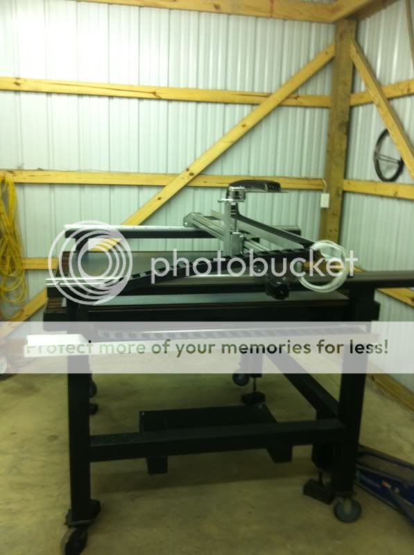

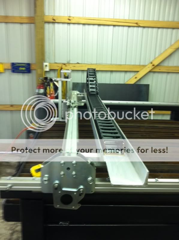

Had some nice weather this morning 71 with 40 % humidity thats cool for august in louisiana. I got my cable trays finished this morning so its finally time for some electronics.

Aaahp someone screwed up and sent you too much cable carrier. LOL You dont need that much for the one side. Table looks fantastic though!
wickedinhere
YEah after i looked at the pics i went and took about a foot off of each one and it looked alot better.

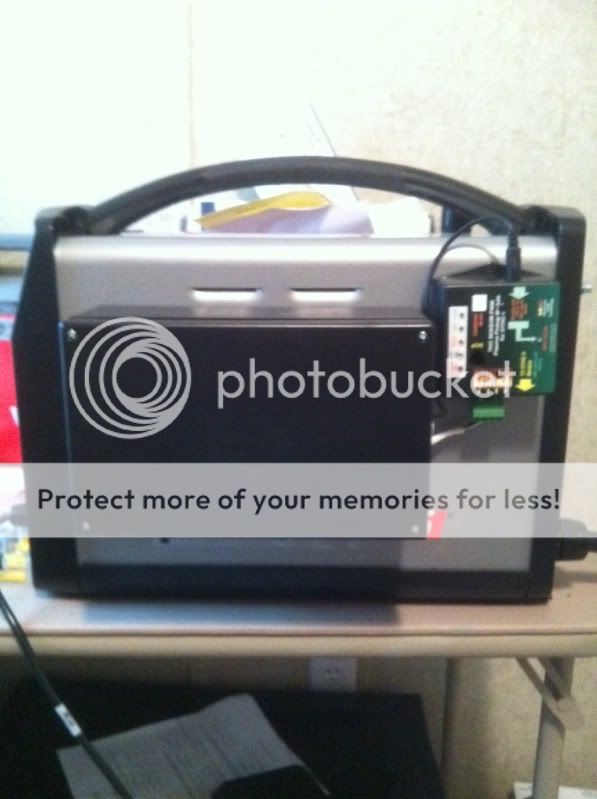

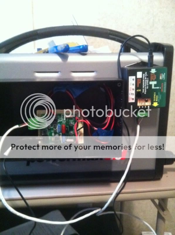

wickedinhere
Well got the motors in and got the wires ran in the cable carriers. I hope to get the control box and plasma installed tomorrow and be cutting by the weekend. The machine torch looks great !

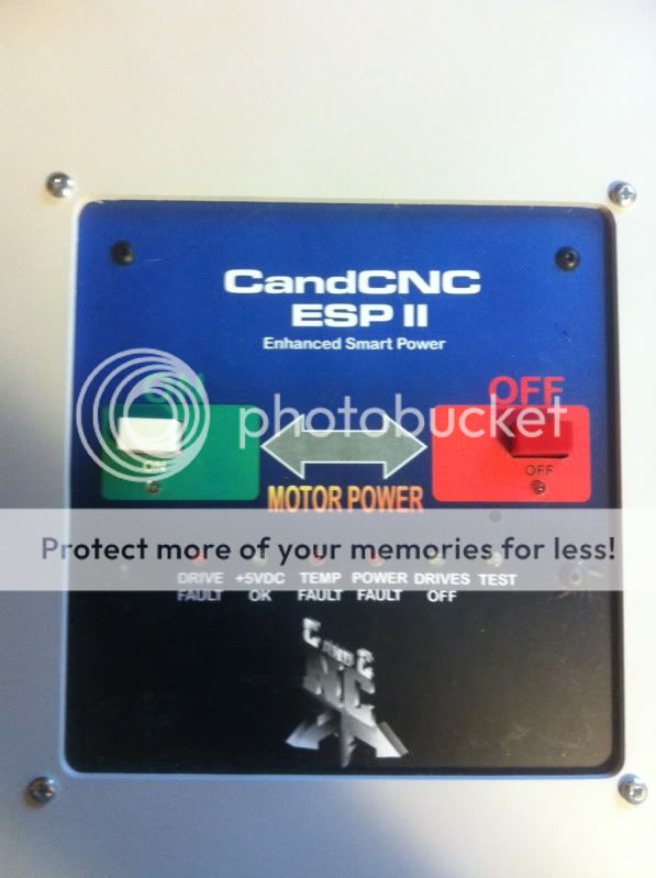

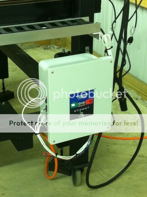

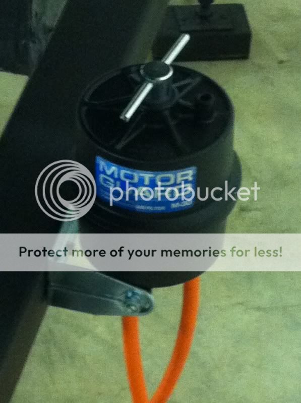

I got the control box and the air filter installed this morning i used some old orange air line i had just for mav LOL. Its getting real close, i filled the water tray half way so i could check for leaks one more time.

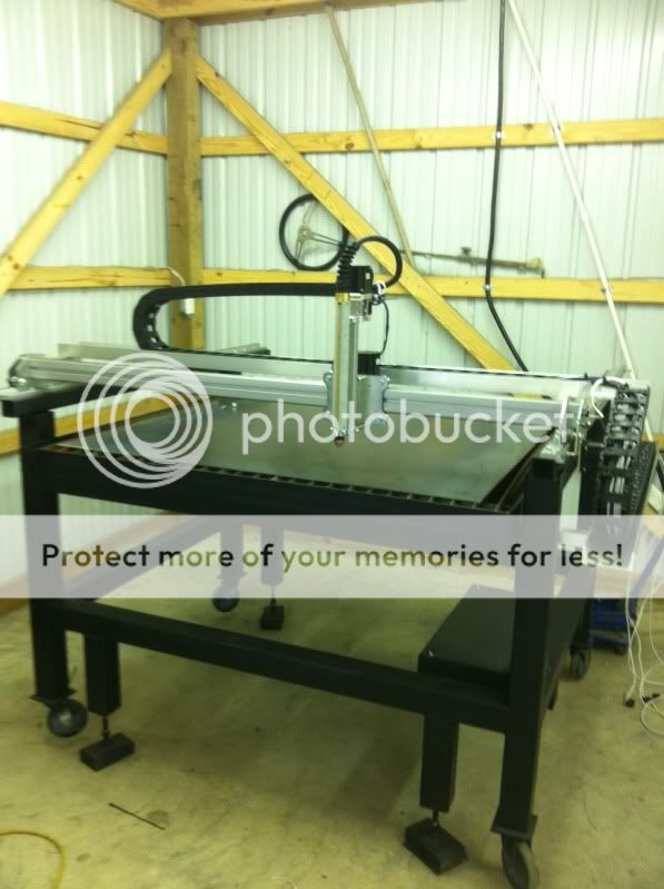

wickedinhere
Well got it all hooked up, I will load all the software in the morning i have to get my generator running in case that storm in the gulf heads our way.

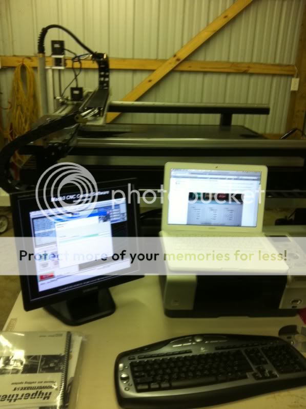

wickedinhere
Well i tried to load some software but my computer needed some major updates cause it hasnt had any in over 5 years. I got mach 3 loaded no problem but sheetcam didnt do so good. I am installing service packs and hopefully that will fix it. I had my mac in the shop looking at the setup thread because for some reason the dell refuses to connect to the internet. Maybe tomorrow......

wickedinhere
Well its been updated and still wont load sheetcam. When i try to load it it starts then says C++ visual runtime errors. I have tried all kind of fixes but nothing works.
wickedinhere
I got it finally found the fix on the sheetcam site go figure. LOL
