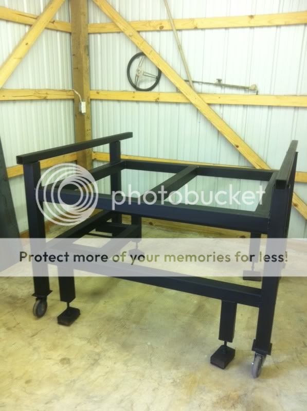

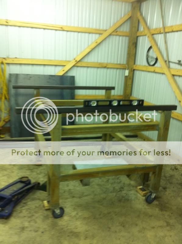

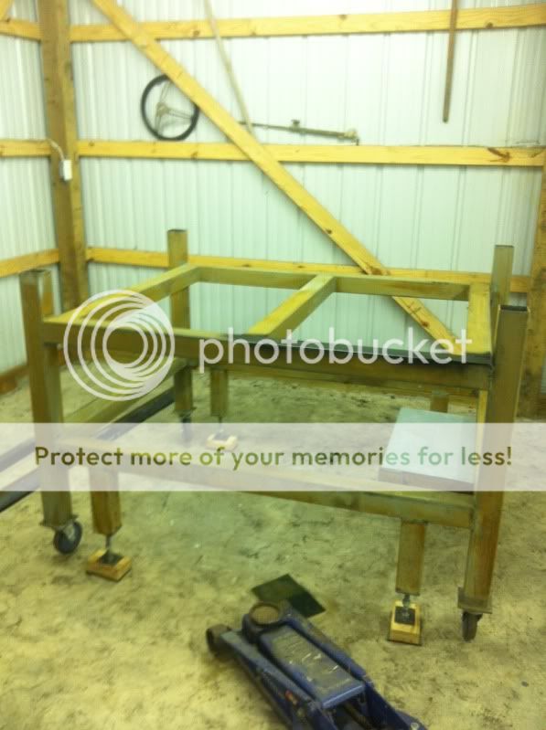

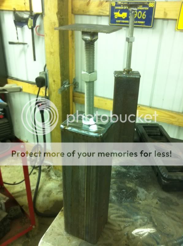

Got the leveling/stop legs built this morning.
[IMG]http://i20.photobucket.com/albums/b235/wickedinhere/photo97.jpg[/IMG]

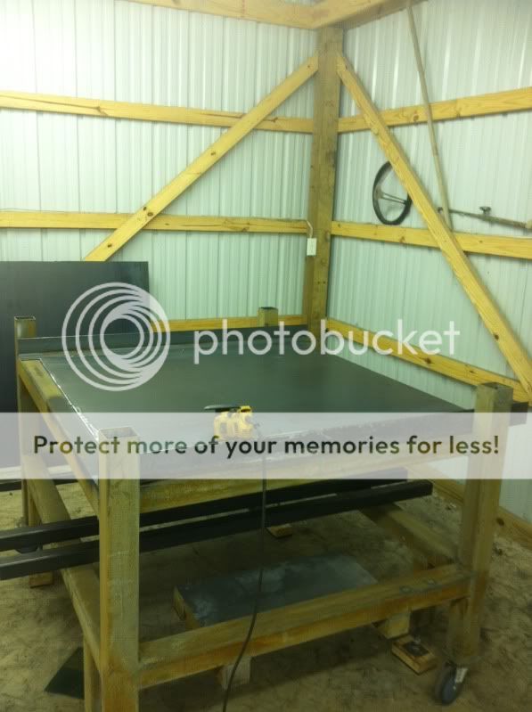

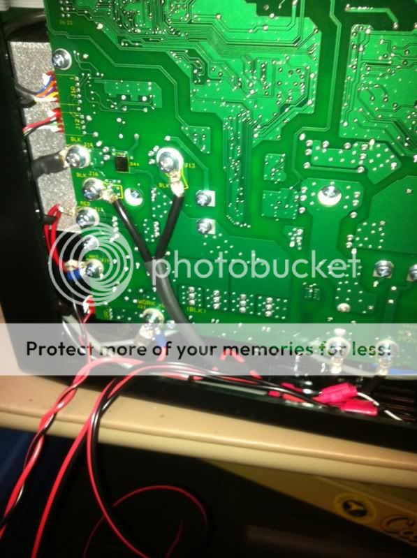

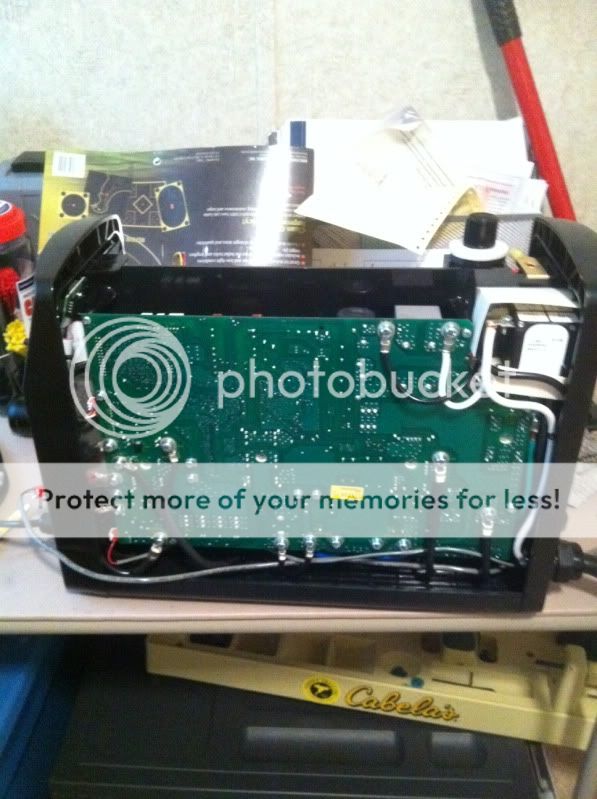

Well got some more work done, levelers are on i built a shelf for the plasma cutter to sit on. I leveled the table then put the rails on and they were level as could be. I put a coat of picklex20 metal treatment on the table it turned the rust into the yellow powder. I opened up the PM45 to take a look at what wires i have to tap into. I hope to paint it this weekend.

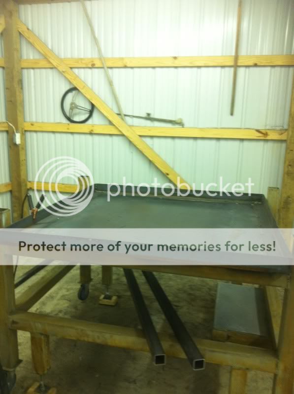

Started working on the water tray today got it all cut and welded together in the corners gonna let it cool down and finish welding it up tomorrow.

I got my plasma wired up today, i just have to drill a hole in the cover and mount my electronics box for the card. I made all the connection inside so the only exposed wire will be from the computer to the card. I got the water pan finished up and painted i should have the table painted this week and start putting it all together.

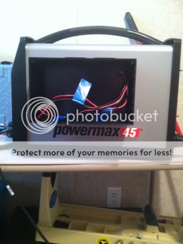

I got a little work done today, Got my box for the card installed on the pm45.

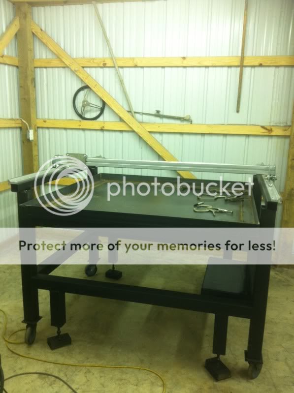

Got some paint on my table today i painted it with john deere blitz black i had on hand.

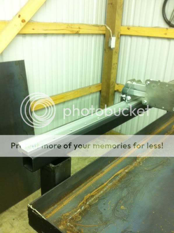

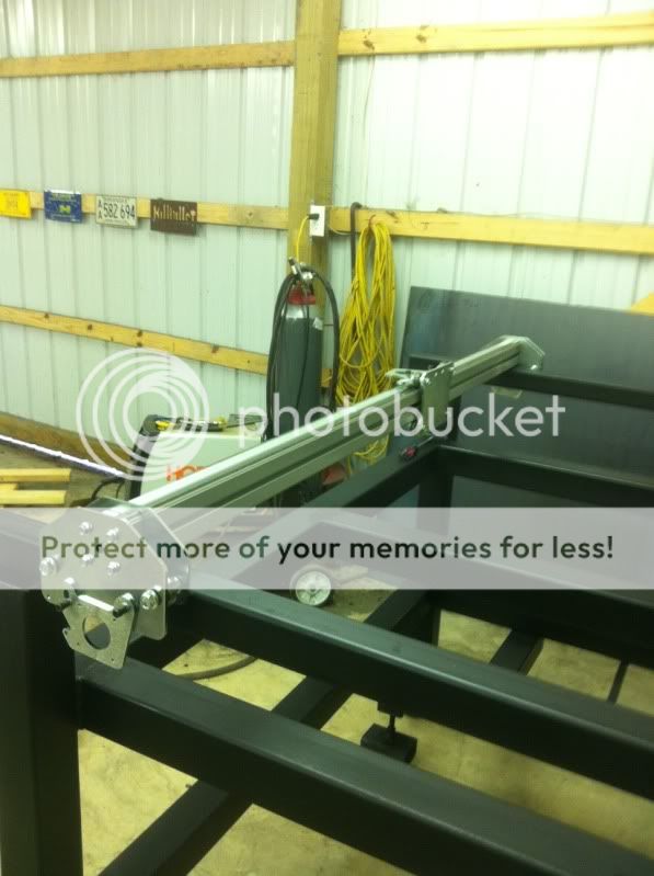

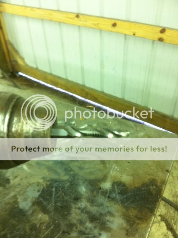

Well i got the gantry moving and its smooth as glass, my water table is slightly warped nothing a few c clamps wont fix. I tried out my drill/tap bit combo from greenlee and it works great i did 4 holes so far and i am very surprised how easy it was.PICS!

THanks man, I got my top rails all welded up and drilled and tapped. My drill/tap bit combo worked great till the last few holes where it snapped thanks god i ordered a few extra cause i sure needed it. The drill jig worked great. This project is going alot easier than i ever thought it would.
