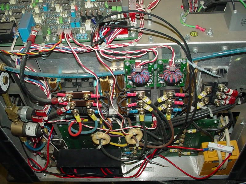

Just so you know here is where the torch leads are coming out and here is the current transformer hooked up. The leads to the DTHC card are black going into the J8 plug.
[img]http://i2.photobucket.com/albums/y29/bulltear/BTAplasma005.jpg[/img]
10W15Ohm resistor across the current transformer only requires the wire go through once. We used a 10W20ohm resistor and went twice for this application.

Brian where the wires you spliced into rigth of the torch purple and orange? ....think Im about ready to trad this thing in on a thermal dynamics![/quote]
