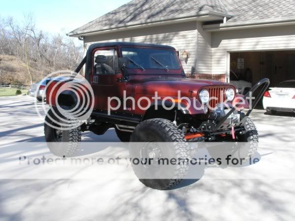

I was able to go back home to Kansas for two days around Thanksgiving so I figured I'd better get the Scrambler out and snap some current photos! :t:
[img]http://i6.photobucket.com/albums/y202/JeepScrambler/1985%20CJ8%20Scrambler/7.jpg[/img]
[img]http://i6.photobucket.com/albums/y202/JeepScrambler/1985%20CJ8%20Scrambler/3.jpg[/img]
JeepScrambler
