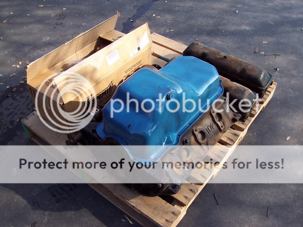

Hey thanks for the info guys! I appreciate it. I, finally got my 401 here a couple of weeks ago. I'm going to have the machining work done to the block, crank, and heads sometime later next week or the following week. So far here are the following oiling upgrades I plan on doing(I plan to get the parts through bulltear):
-pushrods with .015 smaller feedholes
-cam bearings (increased pressure setup)
-midplate
A couple of other questions:
-which oil pump would y'all recommend, the AMC "HRC" oil pump gears, or the (HP) Oil pump kit through bulltear?
-are the pushrods with the smaller feedholes compatible with guideplates?
-would 9.8:1 compression pistons be to much to run on pump gas or should I stick with something under 9.5:1?
-I think I have my cam choices narrowed down, either the ENGLE 5054, comp cam 270H, or the summit K8600. Just have to decide which will work best for my setup?
Again, thanks for all the help and info so far!

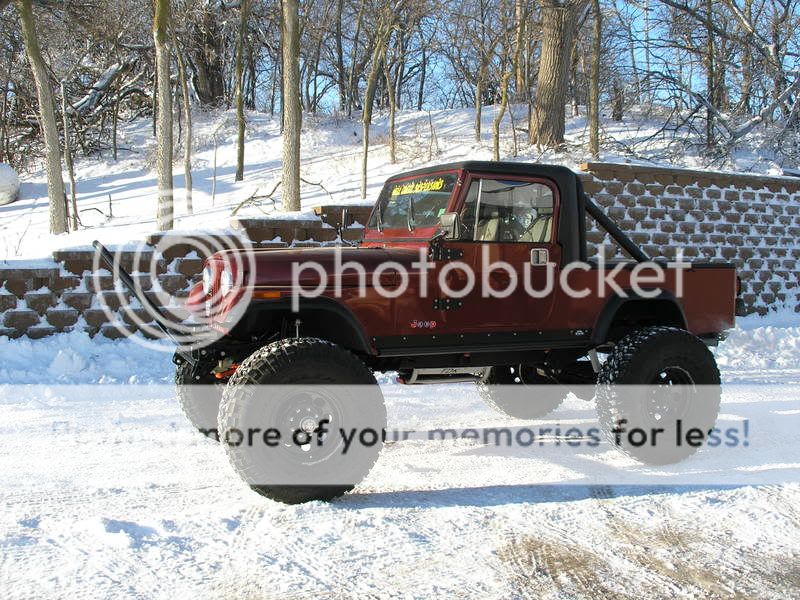

Here's a picture of the 401 and the Jeep CJ8 it will be going in:
[img]http://i6.photobucket.com/albums/y202/JeepScrambler/401_0011.jpg[/img]

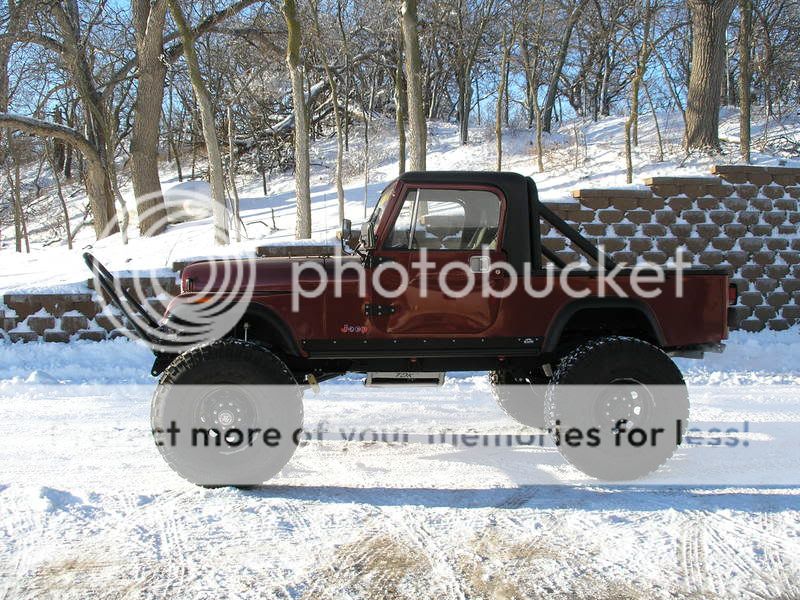

Sorry, pictures of the '8 are over a year old, they don't show the warn 9.5ti winch mounted, the rear end (dana 70) narrowed slightly to match the front dana 60 width, and decals on the windshield removed! I need to get some updated photos:
[img]http://i6.photobucket.com/albums/y202/JeepScrambler/1985%20CJ8%20Scrambler/PC180008.jpg[/img]
[img]http://i6.photobucket.com/albums/y202/JeepScrambler/1985%20CJ8%20Scrambler/PC180001.jpg[/img]
Look at the body on that one! :shock:

Jeepsr4ever, yep the body is and has always been completely rust free! My family has owned the Jeep since 1990 when we bought it with 33K miles where it was used primarily to drive around our trails on our ground in the sandhills, haul firewood, etc., it rarely left 4-Low and was garaged every night. I did the frame off build about 7 years ago when the CJ8 had 44K miles. And now it has just over 48K. It spends it winters in a heated warehouse and comes out only during nice weather! But when it is nice I drive it as often as I can! Lots of sentimental value with this Jeep since we have had it since I was four years old.
