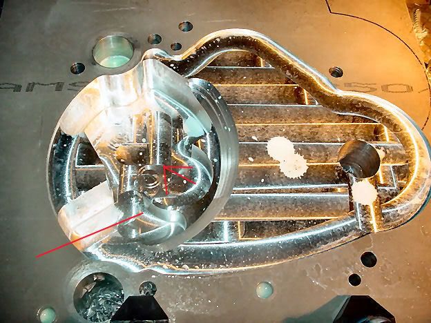

Design work and distributor gear oiling has lead us to a oil cup for the distributor gear. This will be a milled circle with approximately .25" clearance for the cam gear and will surround the circumferance of the gear where the distributor gear does not. This allows more oil to be in contact with the cam gear and allow for even greater loads and never a dry spell on the cam gear. By doing this we also limit the size of the cavity and the dead space in the timing cover and therefor limiting the amount of precious oil it will hold and keep from the bearings. This new timing cover will be a precourser to the next generation of Bulltear parts and the ultimate billet timing cover assembly is well on its way!

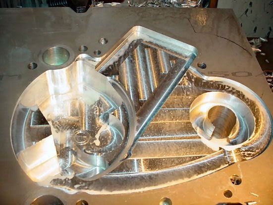

Pics are coming slowly. Noted in red is a cup for camshaft gear oiling. These covers are going to rock!
[img]http://i2.photobucket.com/albums/y29/bulltear/eatitjack.jpg[/img]

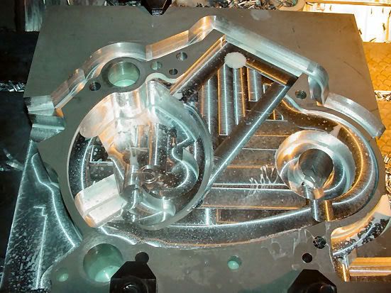

:? Top cover is taking shape!
[img]http://i2.photobucket.com/albums/y29/bulltear/tease1.jpg[/img]
[img]http://i2.photobucket.com/albums/y29/bulltear/tease2.jpg[/img]

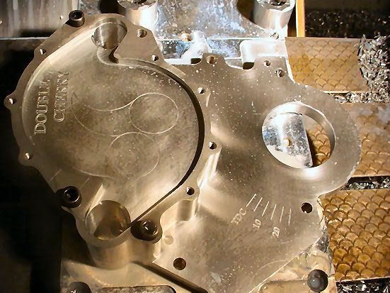

[img]http://i2.photobucket.com/albums/y29/bulltear/tease3.jpg[/img]

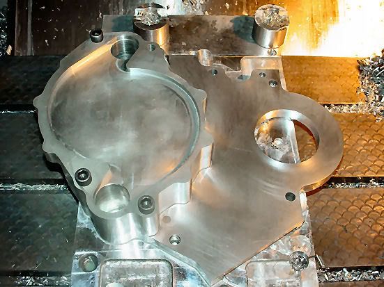

[img]http://i2.photobucket.com/albums/y29/bulltear/tease4.jpg[/img]
Now with timing marks and a little "blown bonus" :lo1l:

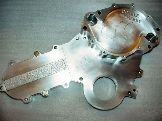

[img]http://i2.photobucket.com/albums/y29/bulltear/tease6.jpg[/img]
Patf10
saweeeet
76-cj7
It's so perty!!! :lo1l:
Lifted79CJ7
You two just amaze me with your handiwork.....

Sometimes nothing need be said and the quality of the work says much of the Master.........
DAMN!!! Looks like the key to Jeff's heart [img]http://smilies.vidahost.com/otn/love/1luvu.gif[/img]
