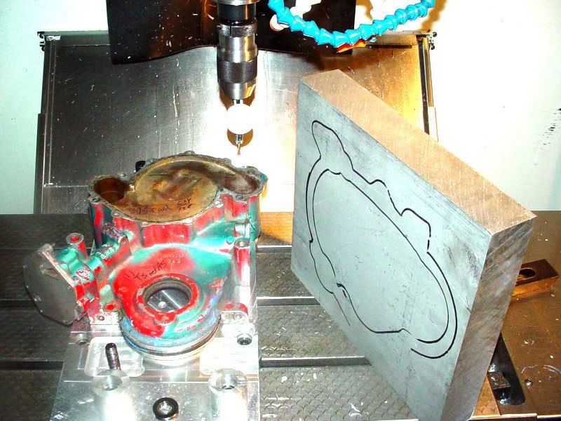

Finding accurate timing (Unlike certain import timing covers...uhumm), mapping the water pump bolt pattern and mounting surface. The stock timing cover is pinned down into location. The mighty block of aluminum on the side is heat treated cast plate (Good for this project). It measures 12"x16"x2.5"...thats 2.5"s thick! Thats a nice big chunk of aluminum :wink: After mapping the parts we need off the stock cover then we attack the large plate at about 10,000rpm.

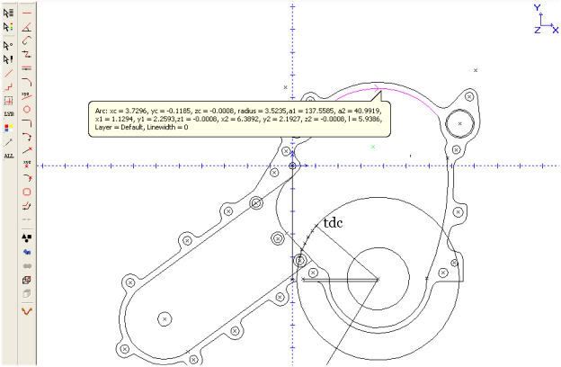

[img]http://i2.photobucket.com/albums/y29/bulltear/jc334.jpg[/img]
Timing is done...Jeff we can add alot of degree marks here, how many do you want?. You can see 0(TDC),5,10,15,20,25
