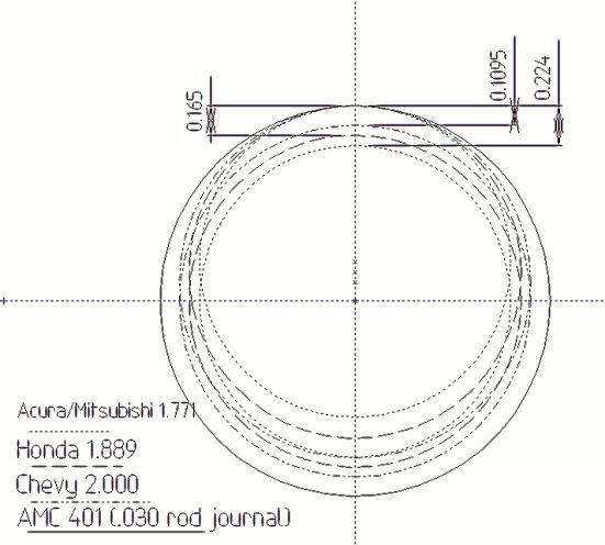

To achieve this kind of power you will need major head work. Flow should be around 310-320 @ .700lift on the intake and near 235-240 @ 700 on the exhaust. The crank shaft should be offset cut and ground to accept 2.00" chevy journal. Read this about stroking your motor

4.128 stroke Acura/Mitsubishi bearing 1.771 id

4.010 stroke Honda bearing 1.889 id

3.899 stroke Chevy bearing 2.000 id

These are based off the std 401 bore of 4.165 and using a 401 crank that started at a good cleanup @.030 (after offset grinding) at the top of the journal. This is just a nice reference for those who are thinking of different combos.
