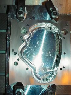

Fixturing is almost done for the backing plate. It will be 1.25" thick and it will stay on the motor. Here is a sneak peek at the machining of the prototypes :idea:
[img]http://i2.photobucket.com/albums/y29/bulltear/backingplate21.jpg[/img]
More as we get closer
