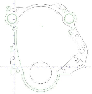

Phase one. Finding the gasket surface and finish design on the backplate
[img]http://i2.photobucket.com/albums/y29/bulltear/part1amct.jpg[/img]
The three lines represent the proper distributor to pin alignment

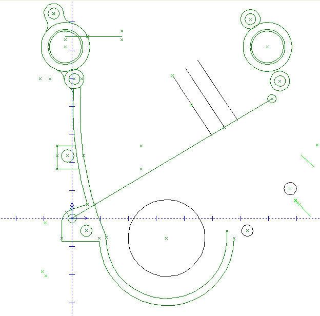

Getting closer... word travels fast on the interweb. Omix already knows about this :?:
[img]http://i2.photobucket.com/albums/y29/bulltear/part2amct.jpg[/img]

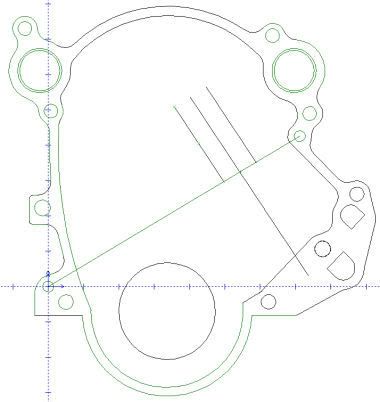

[img]http://i2.photobucket.com/albums/y29/bulltear/part3amct.jpg[/img]
Done I have the back of the timing cover mapped. We had it before but for some reason I couldnt open the file...DOH But it wasnt that bad to map again

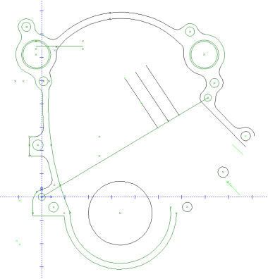

Ok here is a rough draft of the back plate. This plate is designed to "stay in place" while the front will be able to come off for cam/timing changes.
[img]http://i2.photobucket.com/albums/y29/bulltear/part4amct.jpg[/img]

May I ask what CAD drafting software that is ?
