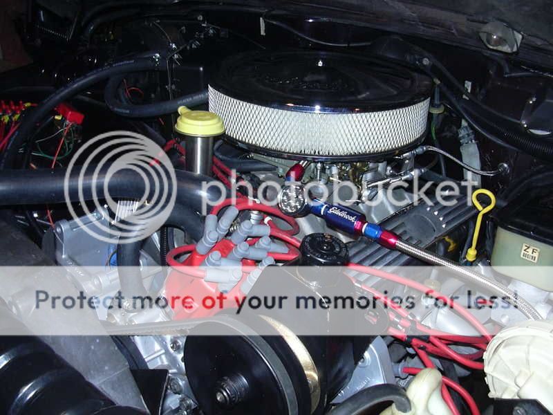

Well it is in. Took me a while to get tranny, fuel, wiring, throttle and kckdown, etc. up to standard.
Damn! This puppy hauls! And it is a two ton truck.

Just a small note. The idle is just a little rough, you know, lopey, lopey. Dosen't bother me, but I thought others would llike to know. Still plenty of vacuum at idle for all the accessories. Heater switches, 4WD actuator, power brakes, etc.
Also of note, I really like the Holley Truck Avenger's vacuum connections. They provide for anything you would need right off the carb base. Plugged all the manifold holes and made a much neater installation.

I guess I need to get some pics of mine installed in a CJ :? I like your fuel line & pressure gauge, really don't know where I want to mount mine yet. I've got the 1406 carb with the fuel inlet on the right rear (via hard pipe), I was thinking just under or around the throttle cable mount??

Mudrat - I have a CJ7 too. On it I ran the fuel line from the tank to the right side with an electric fuel pump on the frame, then up under the battery to the Edelbrock 1406.
donwag wroteMudrat - I have a CJ7 too. On it I ran the fuel line from the tank to the right side with an electric fuel pump on the frame, then up under the battery to the Edelbrock 1406.
I've got a new Carter mechanical on mine, which of course is on the drivers side. I was thinking of going to the braided line behind the PS pump along the valve cover to the fire wall, mounting the press gauge then around to the carb.
