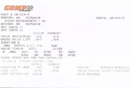

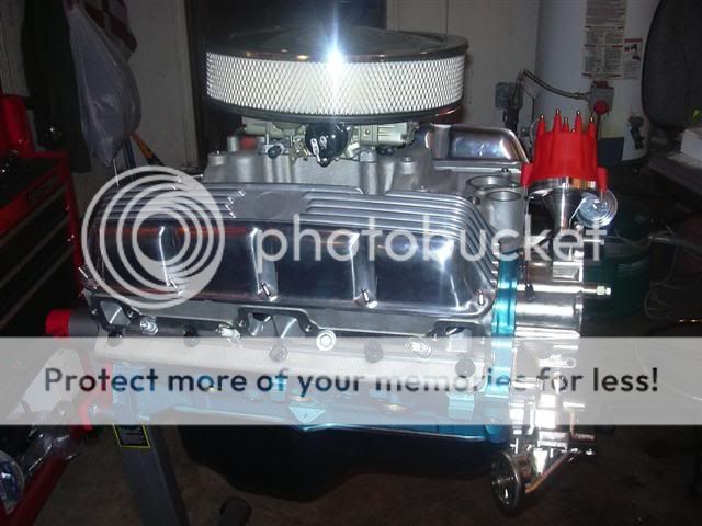

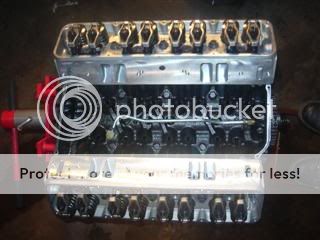

This motor is for a daily driver truck that weighs over two tons. A Jeep Grand Wagoneer with a 727 automatic transmission, 3:31 rear gears, and 30” tires. Don’t want to race anyone, just want something better than stock. So the plan was to build for lots of low-end torque, avoid any drivability issues and run on pump gas. Probably never going to go over and will seldom reach 5,000 rpm’s. Taking advice of the pros, emphasis was placed on induction, exhaust, cam, and valve train. Except for the lifter valley oiling mod the bottom end was left pretty much stock after being balanced.

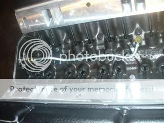

If you look closely you can see where we machined the lifter valley to lay the fabbed up oil line in very low. Tried to use a pre-made kit, just did not like it, too high in the lifter valley.

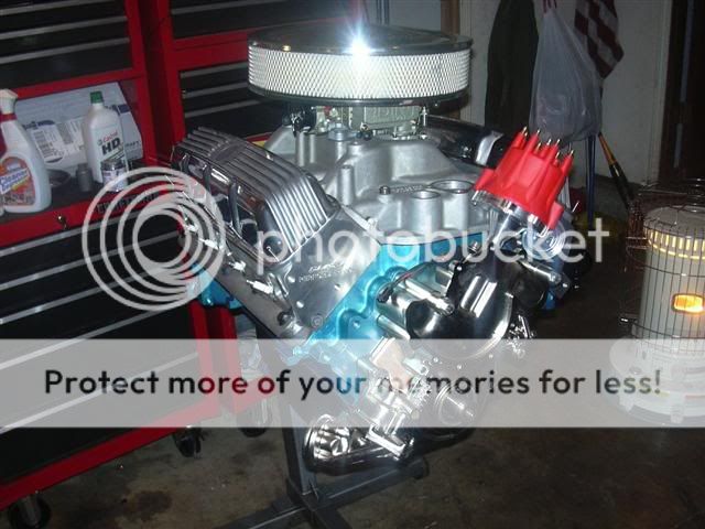

Also notice we cleaned up the intake ports. As received from Edelbrock, they were rough machine cut with ridges. We smoothed them out and port matched them with the intake manifold. In my experience with other engines, this step alone can gain 20-40 horsepower.

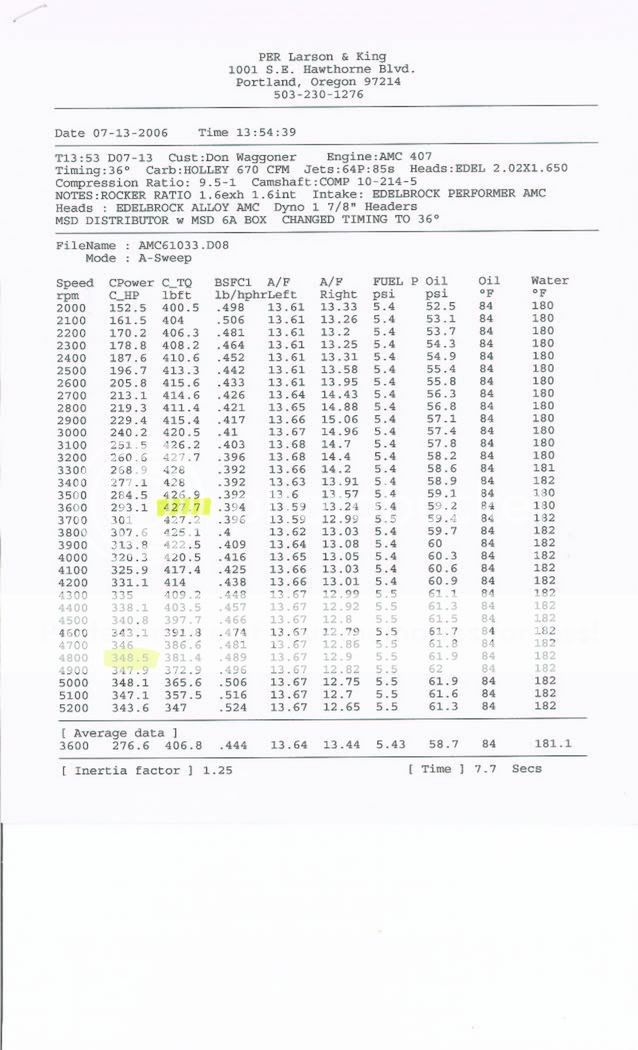

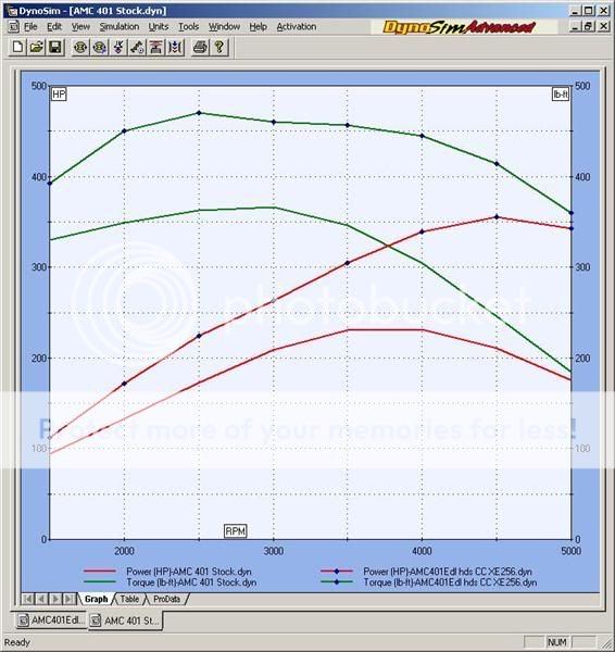

Here is a DeskTop Dyno comparison of stock and the plan. All specs in these calculations are conservative and I expect actual Dyno results to be better.

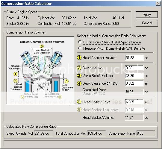

Here is a CR calculation using the factory specs. The piston dish volume is calculated using all the other known items (specs from Performance American Style, 1972)
With this information I am guessing the static compression ratio in this build is likely 8.75 to 9. Stock 8.5, some loss on replacement pistons, some gain on smaller combustion chamber with the Edelbrock heads.
Bottom line is this build increases torque and horsepower by making it flow better than stock and using a cam appropriate for the power range and higher compression is not needed to get there.
