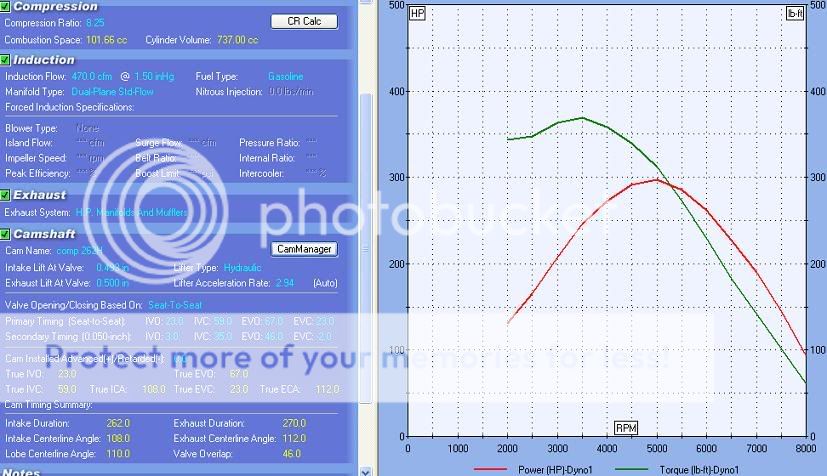

As far as I can tell, TBI engines need cams with a low amount of valve overlap. The 8600 has 53 degrees which is about mid range for an amc cam. The crane 863904 has 42 degrees and is a 260/272 with .456/.484 lift. The comp 262H has 46 degrees and is a 262/270 with .493/.500 lift. According to DD2003 the comp 262H should be a great cam for a stock amc 360 with 502 heads and a 470 cfm throttle body. I've only got comp, crane, and summit cams in my database though. There are others that match the HP of the 262H, but those all have more overlap and less low end torque. And all the ones that have similar low end torque have less HP.
