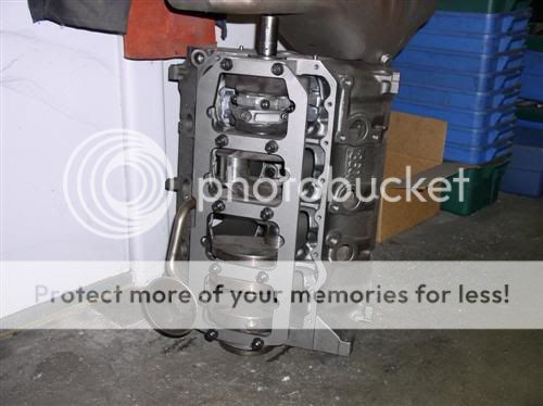

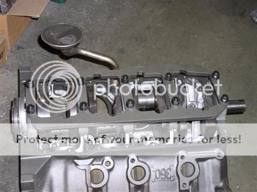

My machinist has made a few that he plans to sell over the internet, as soon as he gets a new computer. Made from 1/2in steel. I'll try to get some pictures.
73hornut
OK, here are a couple pics. These are'nt available just yet. He's still working out pan clearence issue. 1/2in steel, ARP studs. Cost will probably be in the $200.00 range.
[url]http://i5.photobucket.com/albums/y197/Jimspics/P1010158Custom.jpg[/url]
[url]http://i5.photobucket.com/albums/y197/Jimspics/P1010157Custom.jpg[/url]

That looks really good :? I think if I were building enough motor to warrant a main girdle, I would likely ditch the internal pickup and go external. I'm thinking about trying my hand at fabricating an oil pan, I would like to look at a Milodon or Canton and see what kind of baffle arrangment they use. BTW, that is quite possibly the cleanest block I have ever seen

The block was shot peened. Destresses the block.
