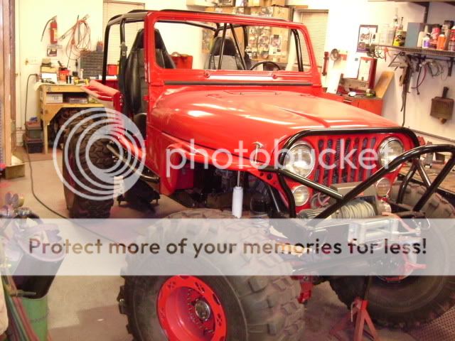

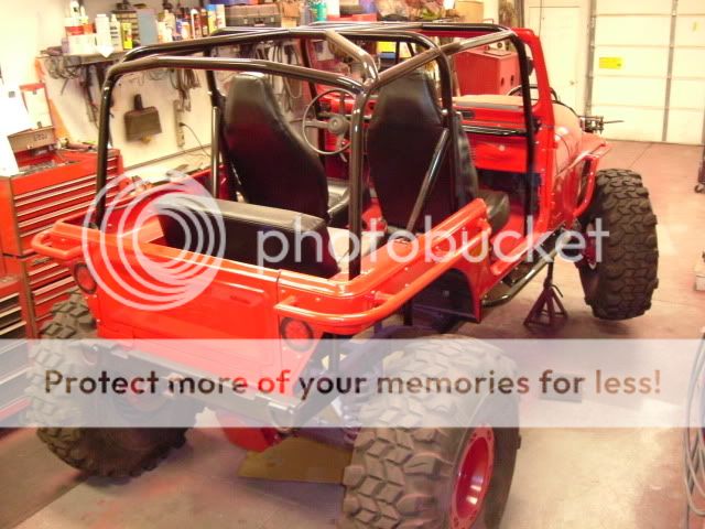

Here's my basic set up:
YJ frame with all brackets cut off and re-welded
Front frame third cut off and raised 3" to make room for lower front links without being lower than frame.
Upper front, rear of the wishbone mounting was inset into inward into frame to miss exhaust
Front is a 3 link wishbone type with no track bar. I'm ordering Full Hydro Steering this week.
Rear susp is double X 4 link.
3" TJ coil front with spacer
3" TJ coil rear over axle
Frame straightened in back
Tires are slightly in front of front frame
Tires are slightly behind rear frame (90 degree approach and departure)
Body was moved back about 2"
401 was moved back about 3"
dual front driveshaft with hangar bearing to miss rocks
rear axle is 14 bolt with dualie hubs for 63" WMS to WMS
front axle was bought with C's. Spose to be 63", but ended up 62", oh well
Tires are 42" TSL's on 16.5" Stazworks double beadlocks
I am now 82-83" outside of tire to outside of tire
My trailer has removeable fenders

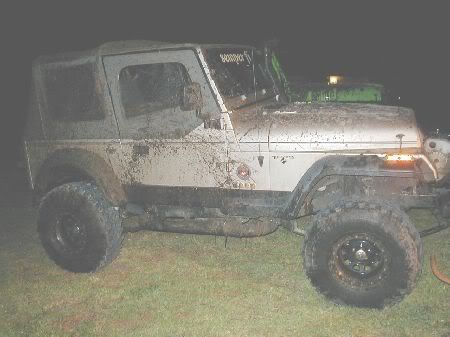

I'll post a few other stored pictures. Some stuff has changed a little since I took some of these pictures.
