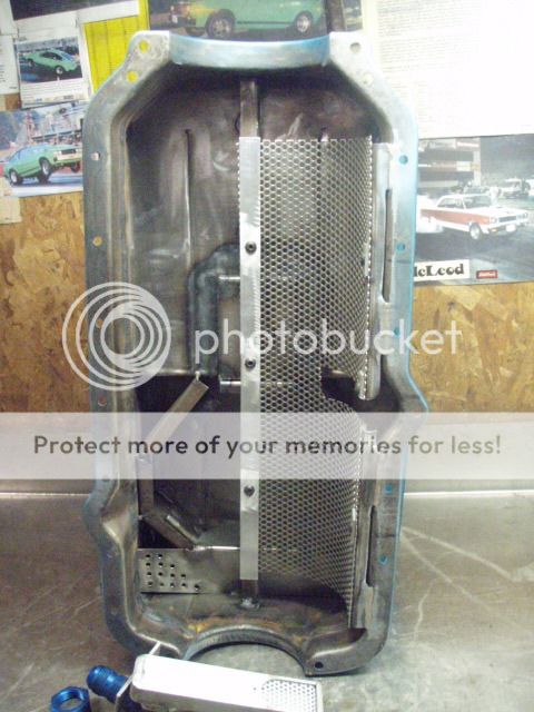

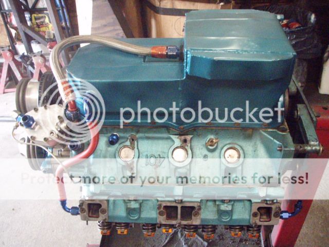

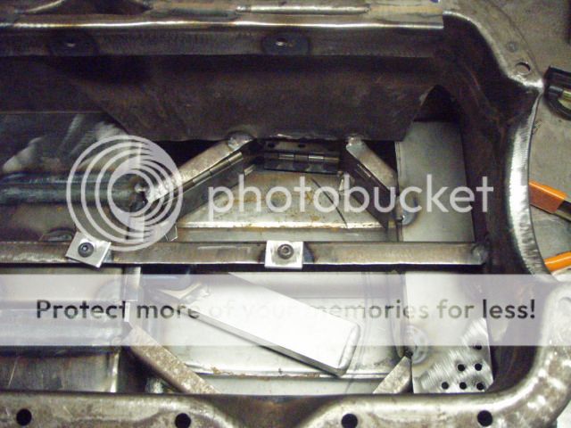

Here is my homemade circle track set-up. Heads drilled and tapped for return,swinging side to side pick-up. No accumulator. The accumulator is a double edged sword. They are great for pre-oiling and they will pump oil in the engine in the event of a loss of pressure. BUT it only is insurance if you shut it down quick. If you los oil pressure and the acc. dumps oil when pressure resumes it has to refill the canister. so then your splitting oil between the engine and canister. I ran one 5 years and removed it. It wasn't worth the hassle for me.

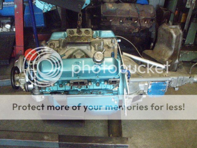

If you run return lines run them into the left side of the pan when possible..I do have the right front line ran in the the right front side of the pan. But the rear head lines run to the left where the most oil is coming out. You can see in this pic where my pan return fitting are even though I didn't have the lines connected yet. The right front pan fitting is also the oil level check hole. I also run restricted pushrods from smith bros. I drilled the heads to keep the minimum amount of oil in the heads. If you return from the valve cover you have to have an enormous amount of oil fill the head before it can get out the line..
