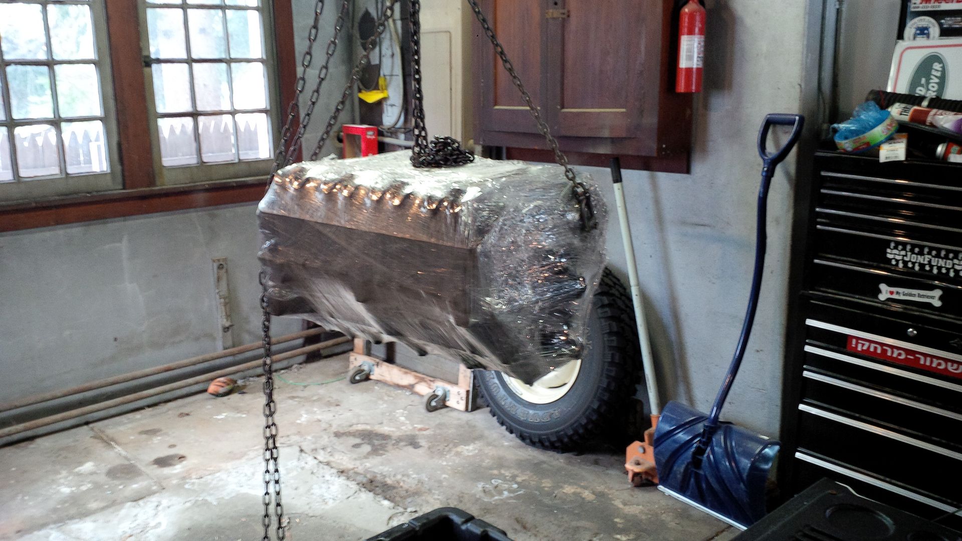

Finally started my 1973 CJ6 build and Just picked my motor up from the machine shop..
AMC 360 Stock rebuild
Bored 30 over, Sealed Power everything, including stock grind cam.
Balanced and assembled..
waiting on a brown box from our hosts with all my nickel plated doo dads etc....
So here lies some of my questions… I have the motor home now, still in shrink, assembled long block..

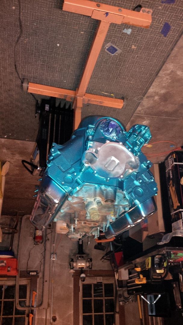

Taking advantage of the last few 40-50 deg days in Rochester…
got engine masked off and painted last night...
waiting for my new timing cover to get started...

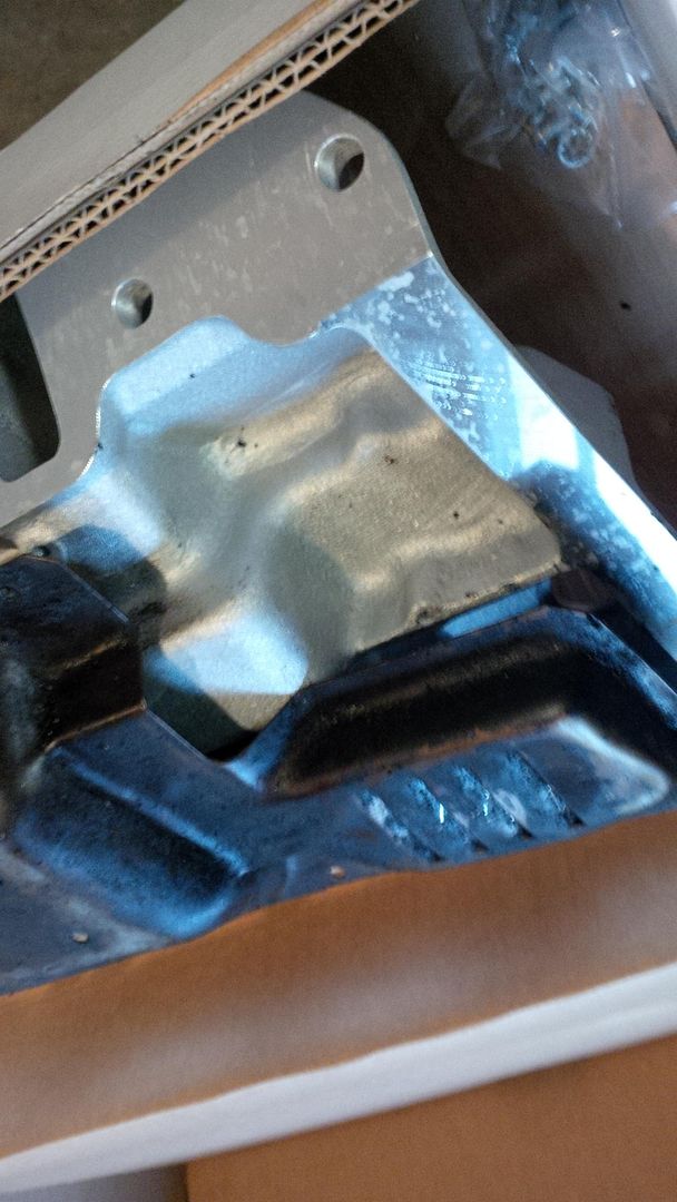

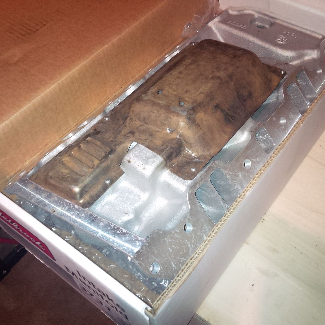

Is the stock manifold oil baffle an easy fit on the edelbrock or is this something I will have to work at...
If you bought the Edelbrock new, it should have come with some small rivets. You'll need to grind or drill the rivets from the stock manifold and rivet it to the new one. I didn't have rivets for the Offenhauser, so I tapped the holes to a #8-32 and used some small screws with Locktite.

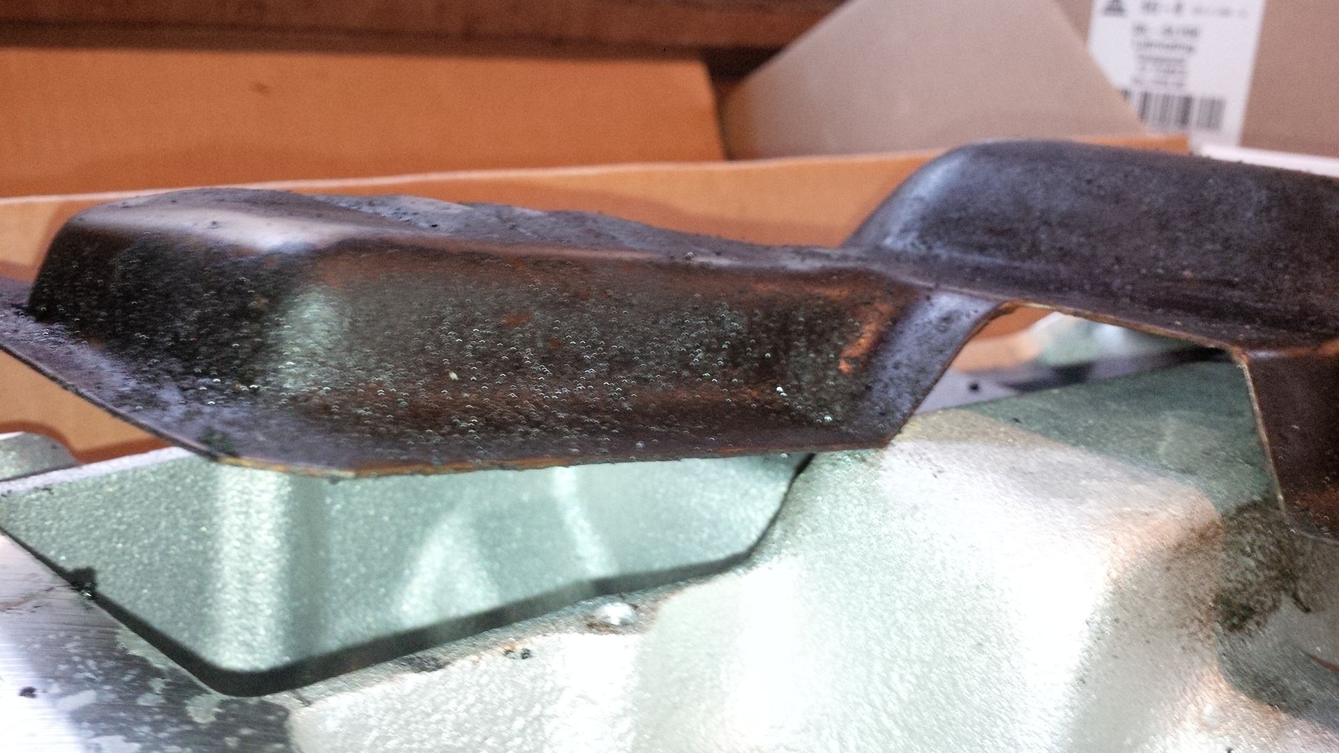

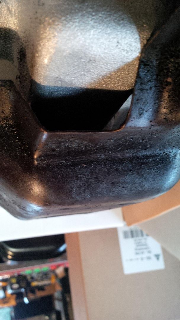

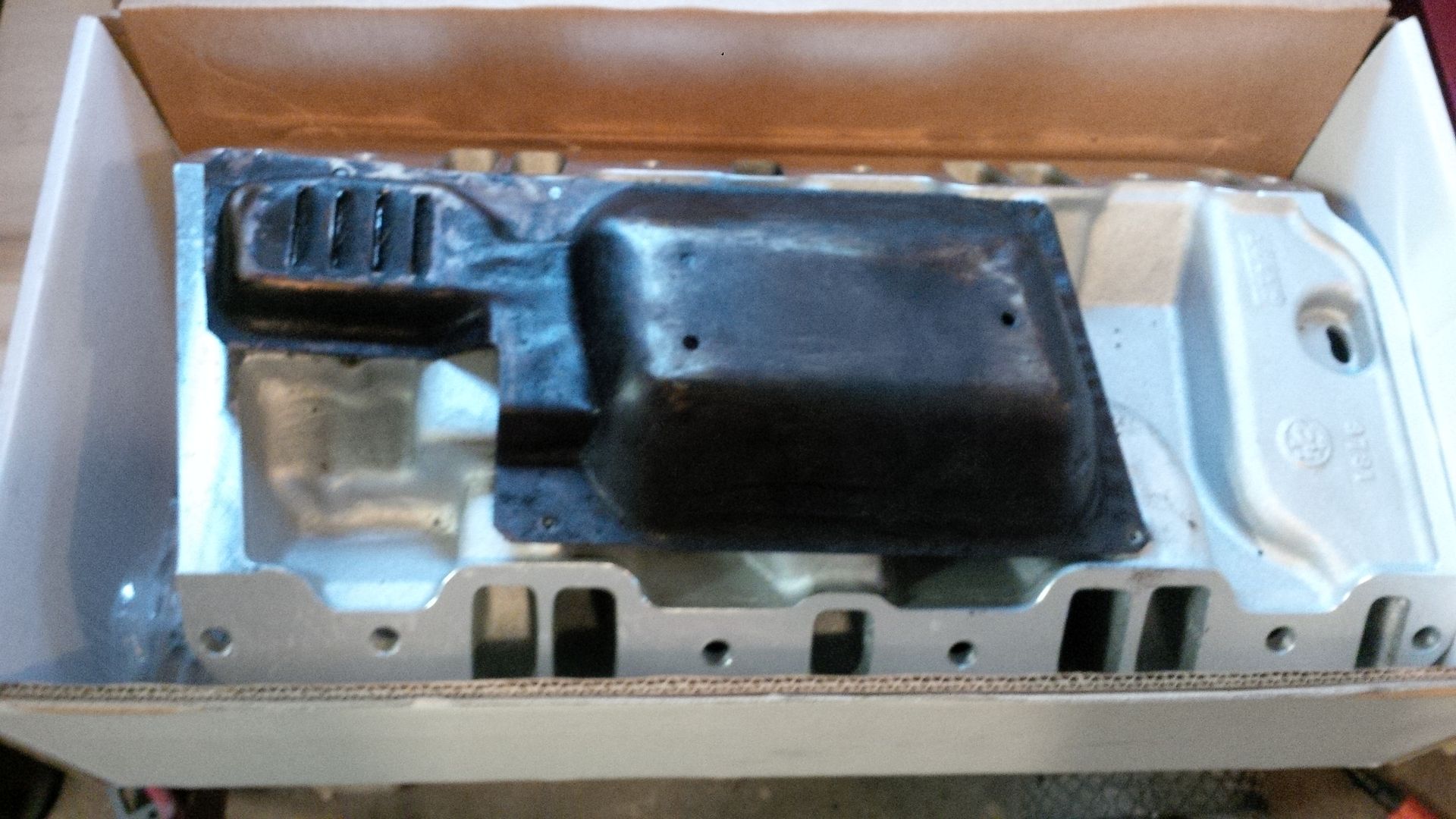

Intake oil baffle issues...
fabrication required...

I know there are 2 styles of baffle. Guess I've been lucky and mine have fit. It shouldn't be too hard to trim that corner with a dremel or snips. The purpose of it is to keep oil from splashing into the PCV.

intake baffle cleaned, mangled and riveted into place...
