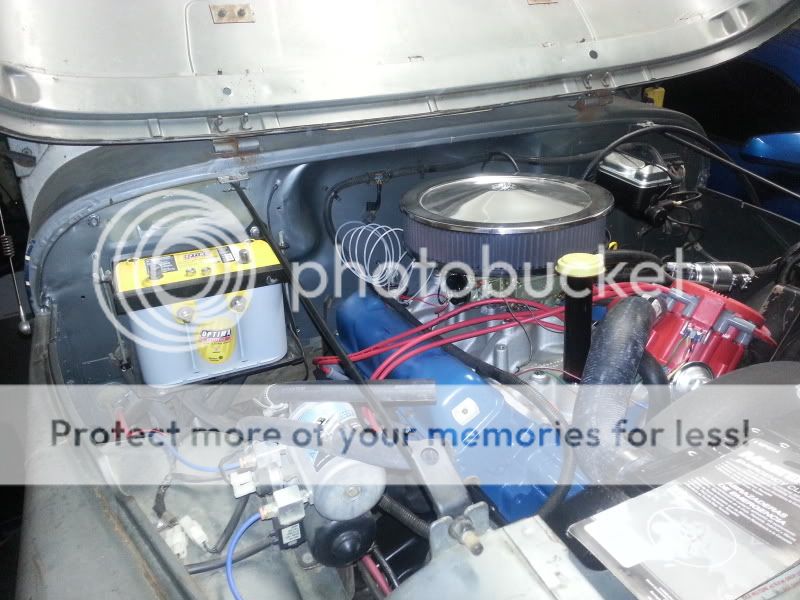

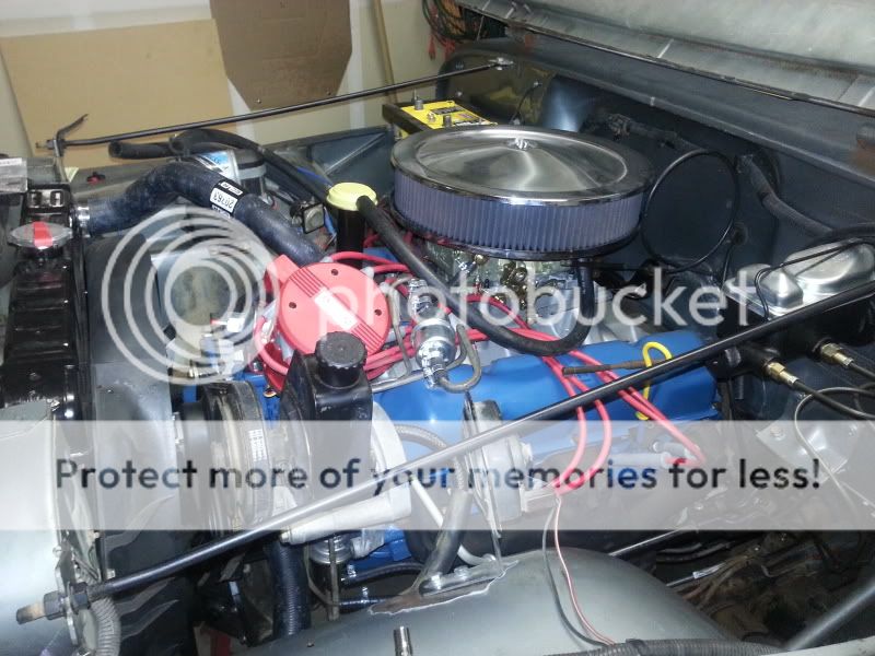

Here is mine as of right now..
[IMG]http://img.photobucket.com/albums/v117/rsbad454/20130722_045646.jpg[/IMG]
[IMG]http://img.photobucket.com/albums/v117/rsbad454/20130722_045634.jpg[/IMG]
rollbar
SWEET !
