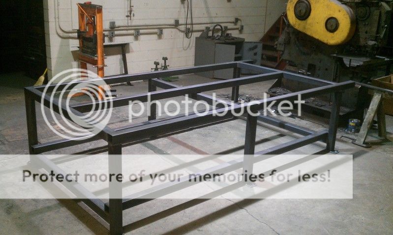

[IMG]http://i78.photobucket.com/albums/j118/jamscal/Cars/Tools/IMAG1004_zps0dd3630b.jpg[/IMG]
[IMG]http://i78.photobucket.com/albums/j118/jamscal/Cars/Tools/IMAG1005_zpscf38a6b3.jpg[/IMG]

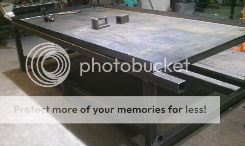

Table and computer... the latter is from the link above on ebay.
Just flipped the table, haven't welded the top joints yet.

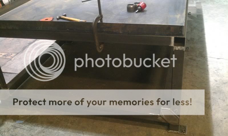

Water table arrived today... they didn't break the ends per the drawing but included the end caps I'll have to weld on. Got a start on it.
They knocked $60 off the price. Said they couldn't bend it.

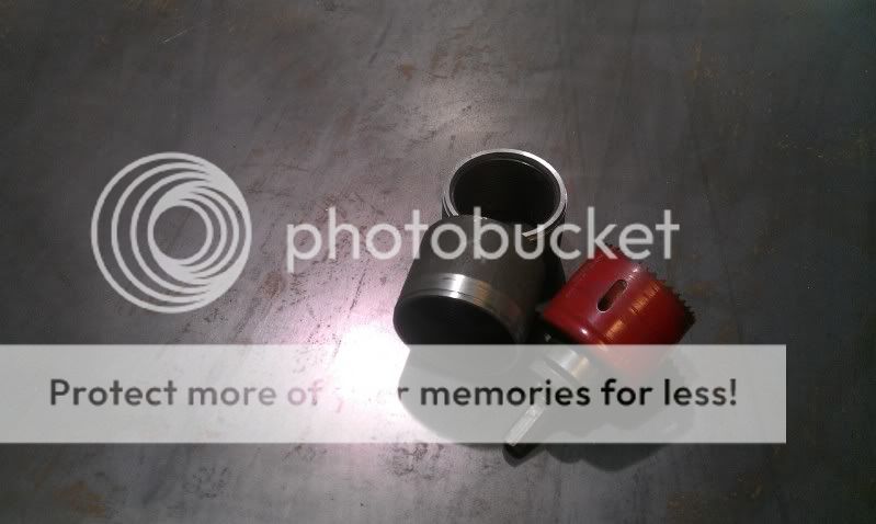

Found some pipe couplers and turned them down on the lathe to fit into holes I've yet to drill. I'm going with two drains at opposite corners.
[IMG]http://i78.photobucket.com/albums/j118/jamscal/Cars/Tools/IMAG1031_zps848637a3.jpg[/IMG]
[IMG]http://i78.photobucket.com/albums/j118/jamscal/Cars/Tools/IMAG1032_zps6c51196c.jpg[/IMG]
Capped the lower tube ends with more of a fish plate. A little overkill but better looking than a square. I want to cap the uppers but think I may need access inside the tube???
[IMG]http://i78.photobucket.com/albums/j118/jamscal/Cars/Tools/IMAG1030_zpsf78ef50a.jpg[/IMG]

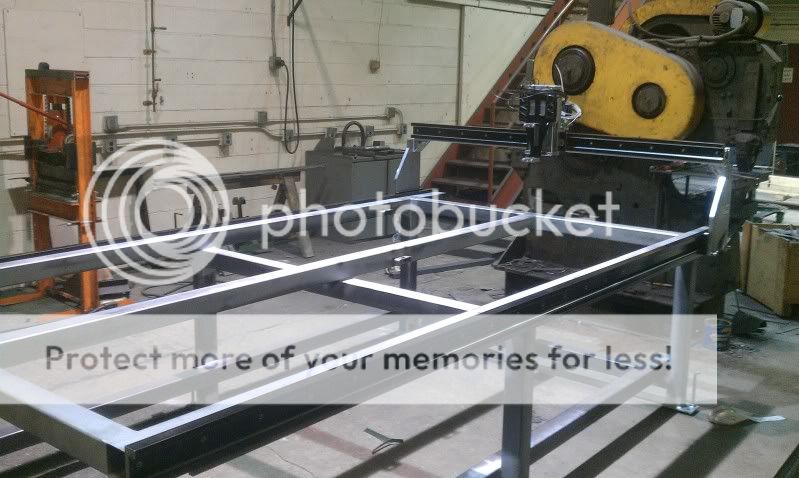

Started unpacking, looking around and getting the table ready to bolt the rails on.

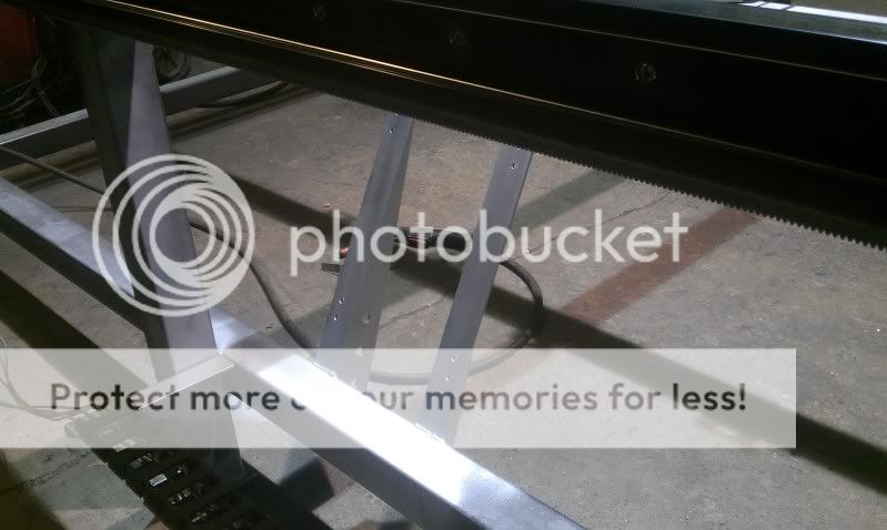

jamscal
My dad came out today and drill and tapped the holes while we worked, then we quit an hour early to do some more work on it.
Rails and sides are on. Set some other stuff too:
[IMG]http://i78.photobucket.com/albums/j118/jamscal/Cars/Tools/IMAG1045_zpsfef55eef.jpg[/IMG]
Everything seems to run up and down smoothly.

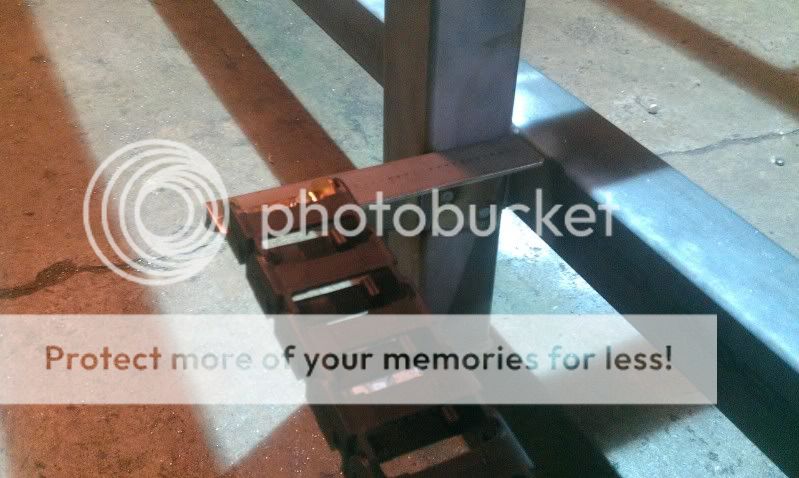

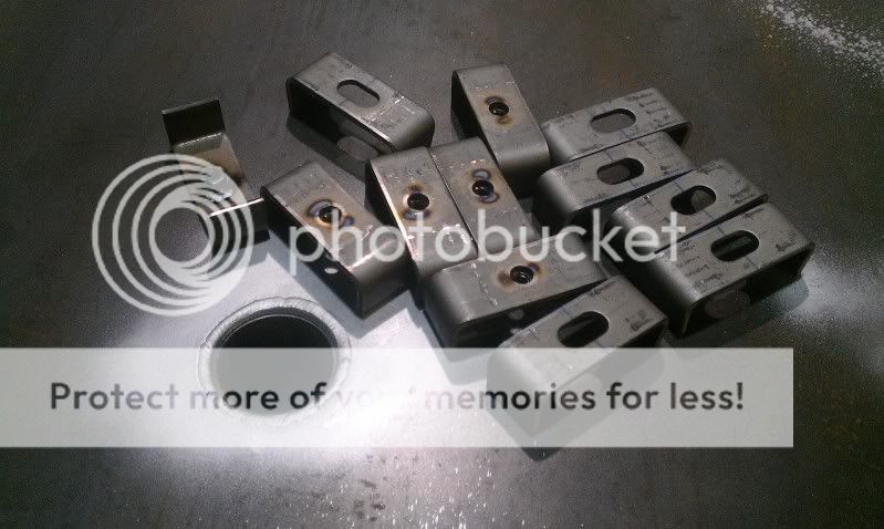

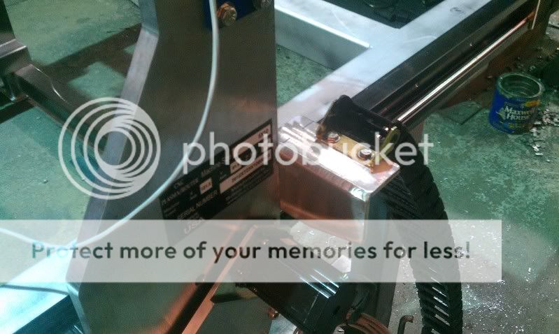

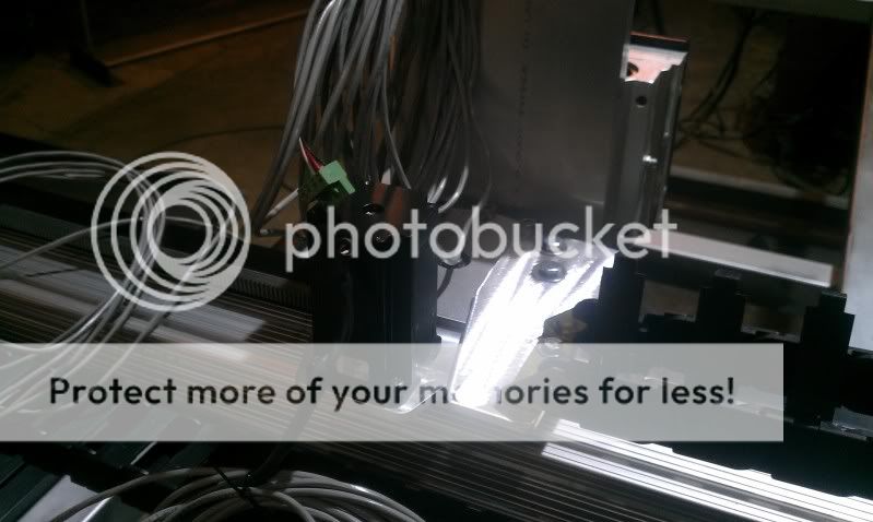

Various shots of some of the brackets that need made. Also, the control box mount (mounting on an angle)
Feel free to point out if anything looks off :)

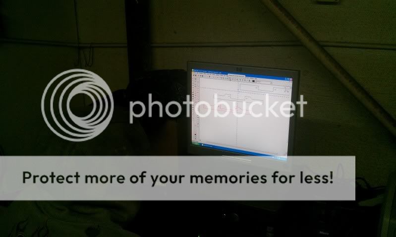

hooded employee playing with the bobcad:
[IMG]http://i78.photobucket.com/albums/j118/jamscal/Cars/Tools/IMAG1051_zps78dd0d6d.jpg[/IMG]
Thats right! Looking good!...very good!
