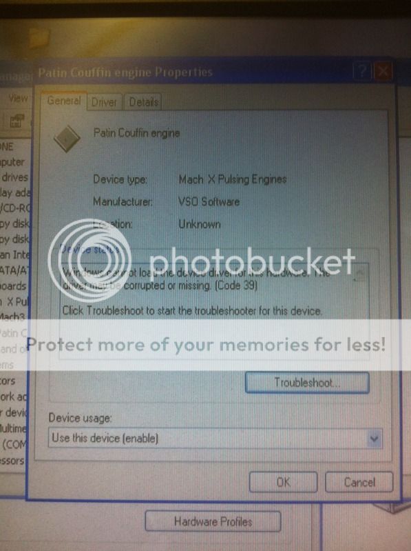

Yes i pressed enter, it had saved before but for some reason it went back to 1 inch. The reason i checked it was because it raised the torch .20 and i had the max set on .12 i was just trying to stop it from raising too far till i get the thc figured out. I was looking around and i found this driver problem maybe it could be the problem but i am not sure.

Hmm it could be that plug in. Contact Tom and CandCNC and see what he says about it. My guess is that the conflict will cause the issue.
