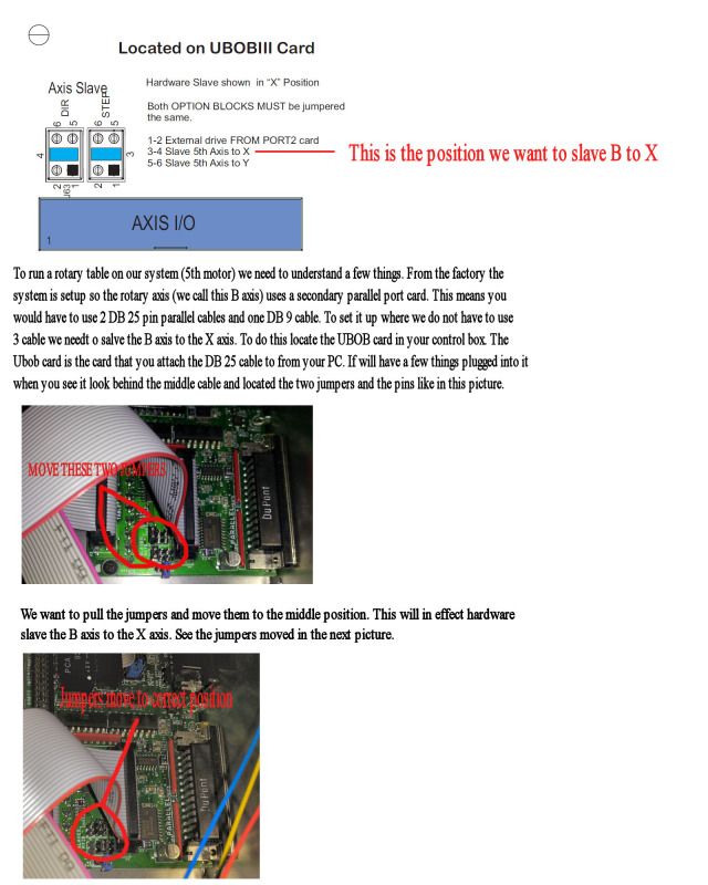

First make sure your not slaved to any axis. Go to config/slave axis and uncheck any slaved axis. This is to be used with the plug in we send you for rotary cutting.
[IMG]http://i2.photobucket.com/albums/y29/bulltear/aaxisrotaryinstruction.jpg[/IMG]

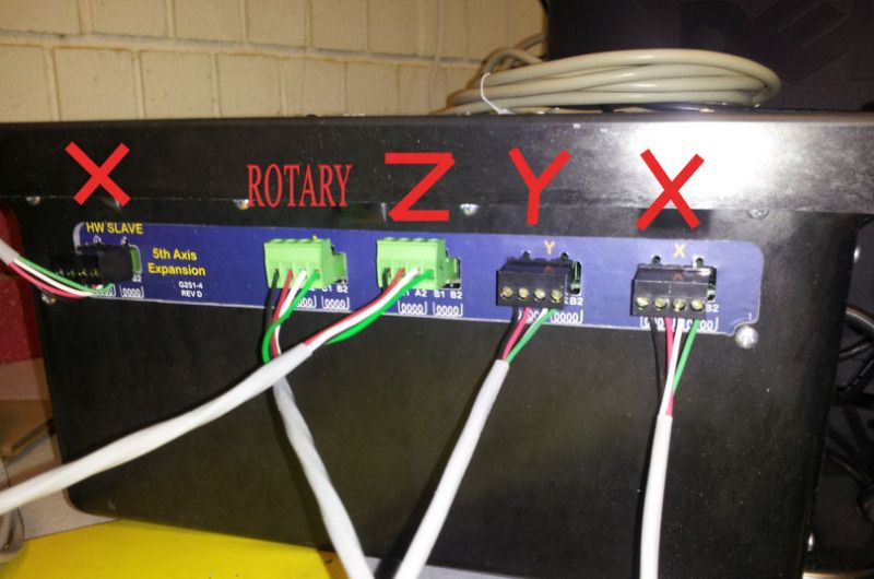

Here is how we are runnning our motors for tube cutting. We no longer slave the A axis to X axis it is hardware slaved.
[IMG]http://i2.photobucket.com/albums/y29/bulltear/rotaryplugin.jpg[/IMG]
[B][I][U]A word on software
[/U][/I][/B]When you install the bladerunner software plug-in from the Support disk you will see that it iwll pop up two different shortcuts on yoru desktop. One will be "Blade runner AIO DTHC" or similar and one will be "Bladerunner rotary". When your using a rotary table an you have hardware slaved the A axis you no longer need to software slave it for use with the STD DTHC Bladerunner profile. You will need to put in motor tuning, accel and velocity numbers for your machine on both profiles to use them correctly. You will also need to set your Z home low active and your limit switches for your Mag-Lok in each profile. Once set they will be there for use at any time.
