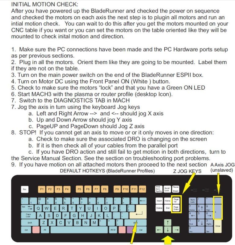

These machines are setup so you cannot crash them. They are also setup from the factory so you can use your keyboard to move them. If you do not like the direction they are moving where you orient your PC in relation to your table you can change the direction by going to Config/Hotkeys and using that menus to change direction of your jogging motion. Here is a copy and past from the manual for jogging.
[IMG]http://i2.photobucket.com/albums/y29/bulltear/jogmachine.jpg[/IMG]
