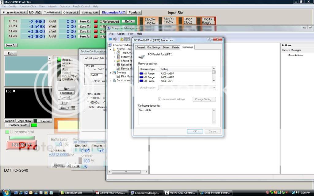

Now I have another issue - Can't get the motors to move and the torch fires by itself every 5 seconds for the first minute or so of logging in to my computer, I followed the troublshooting procedure in the LCTHC manual and tried changing the Hex address in Mach 3 for the DB25 PCI card that is installed in the new PC but that didnt do anything. Tried re-installign the MAch 3 software, nothing there either. Any ideas?
werks
Checked for currently installed licensed file, trying all sorts of port settings but still can't get it to go???
Current Port address of LPT1 -
[IMG]http://i259.photobucket.com/albums/hh308/PerformanceAutowerks/Shop%20Pictures/LPT1Settings.jpg[/IMG]

That damn Windows Vista...:(
