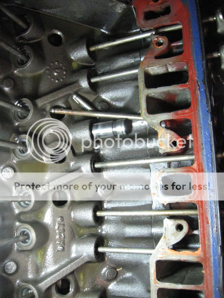

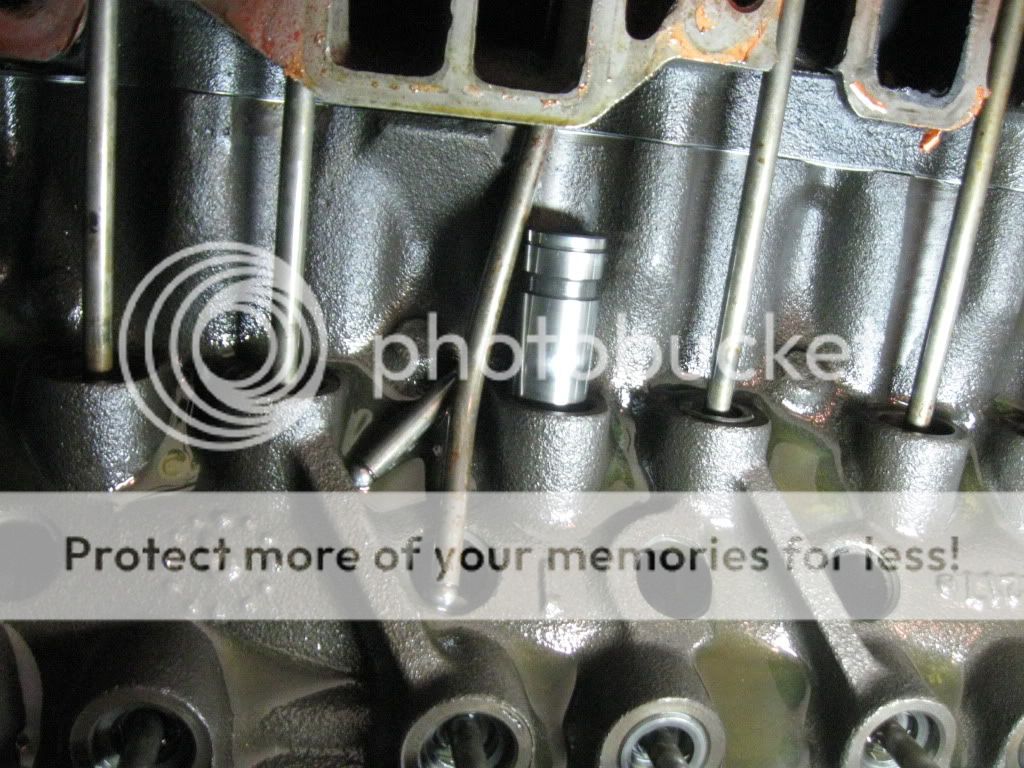

Pretty sure I found the problem, which I was not expecting because I honestly did not notice a difference in engine sound, I reckon I'm just deaf or something.....Now.....What all do I need to replace/check? Obliviously all new push rods, those are the factory original ones with spacers under the rockers to make up length. Should have gone with new hardened ones when I rebuilt.
Should I buy a tool and measure for new ones, go original length and use shims again, which may be easier. Any company ya'll recommend to order push rods from? What was the probable cause for this? Too much HP/RPMS for 30 year old stockers or something I did wrong during assembly?

I had the same thing happen in my CJ when one of the rocker bridge bolts broke.
Why spacers under the rockers? Was a lot milled from the heads or block? They will usually tolerate a .010-.015 total milling without shims. What's the closed pressure on the valve springs? How much lift on the cam?
Could be too heavy of springs. Could be the valve retainer hitting the valve guide. Could be simple metal fatigue. I'd do a leak down test to be sure the valve hasn't hit the piston and bent, check springs and valve guide to retainer clearance. If that all checks out, throw new pushrods in it and run it.

Thanks for the suggestions. Springs are stock replacements that's all I can tell you about them. Spec sheet from machine shop said deck height is 9.190" which is .015" shorter than stock I think. Heads where surfaced by .010" for a total of .025" taken off.
Machinist said to install push rods and tighten to zero lash, or just where the lifter was not pushed down at all and measure the distance between the rocker and head. He said the distance needed to be no more than .030" and no less that .015." My gaps where around .040" for most cylinders so the shims went in, which is what the machinist suggested. Odd thing was cylinders #3 and #5 were right at .030" so I did not use shims on those cylinders, intake or exhaust. Broken push rod was #5 intake.

With that cam, there shouldn't be a retainer to guide problem. Stock compression? Stock style pistons? I had flat top pistons in a 304 that had to have reliefs cut with just a .468" lift cam. You might want to look at the top of that piston with a bore scope.

the pistons are. 030" over stock compression. I don't have a bore scope but I think my neighbor has a leak down tester. I think that would be a good idea. With the intake off it would be obvious if the intake valve is damaged and leaking at all. Thanks for the suggestions.

glad you found the problem.
i nailed it with my first post LOL not saying you over reved it but i had the same thing happen to me LOL

You did hit it on the first post 390spirit. It is possible I over reved it, cam is rated for 1500-4500 rpm. Pretty sure I hit 5000+ a time or two. I got to remeber I have a CJ7 and not a race car sometimes. I ordered new push rods made by comp. hopefully will be able to put it back together, test everything and fire it up next week.
