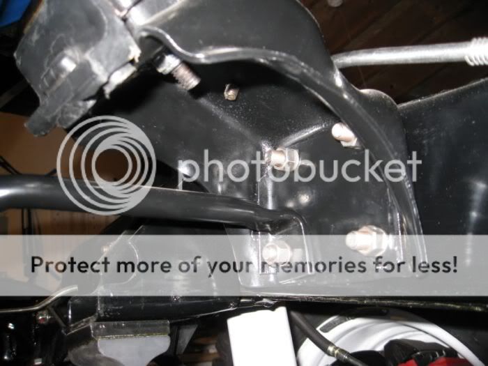

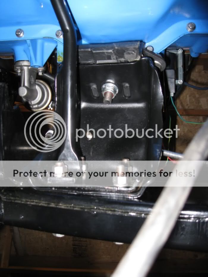

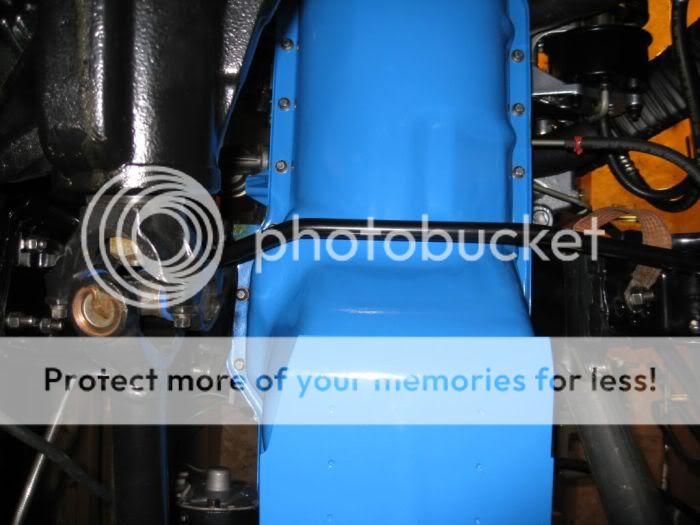

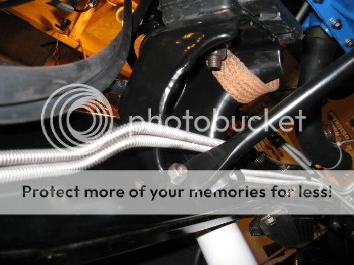

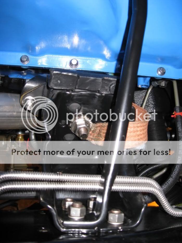

[QUOTE=tufcj;130872]Is there a metal rod between the motor mounts? There was from the factory on 76-up CJs. If it's gone, chances are the rails have flexed. I've seen variances of more than 1" in vehicles with the rod removed.
tufcj[/QUOTE]
That's interesting. I bought this frame (frame only) used, and it did not have that crossrod that you mention. So, that's what those rods do?
Didn't those rods only come with 6 cyl. engines? Did the 304's come with them?
Anyway, if that's the case, and the frame DID flex inward, I could possibly porta-power it back out and bolt up the engine.
