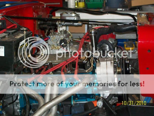

I wish I could find a "better" low mount alternator bracket. Mine keeps breaking the brace between the main bracket & the block. No offence mc but I'd rather keep my alternator down low & somewhat out of sight.

[QUOTE=BREK;130641]I wish I could find a "better" low mount alternator bracket. Mine keeps breaking the brace between the main bracket & the block. No offence mc but I'd rather keep my alternator down low & somewhat out of sight.[/QUOTE]
Do you want it lower than this? I don't think there is room. You will run into the heater hose. :crazyeyes:

I made my own lower bracket and used Bulltear's upper for this 140 amp Delco.l

ORC, I got mine much lower than that. The heater hose goes over the top of the alt.
