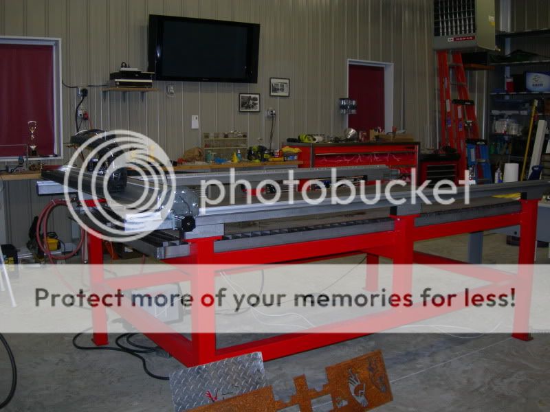

Here ya go. The heat was off in the garage and I got one picture before the batteries went dead in the Nikon. Once I get some projects I'll post some more.... I'm learning more and more everyday. You can see some cuts in the rusty metal on the floor...
[IMG]http://i70.photobucket.com/albums/i97/fiveojoe/DSCN3086.jpg?t=1292891526[/IMG]
Nice shop!! I love TV!!! Your spoiled Joe...lol
More pics when you get rolling please :D
