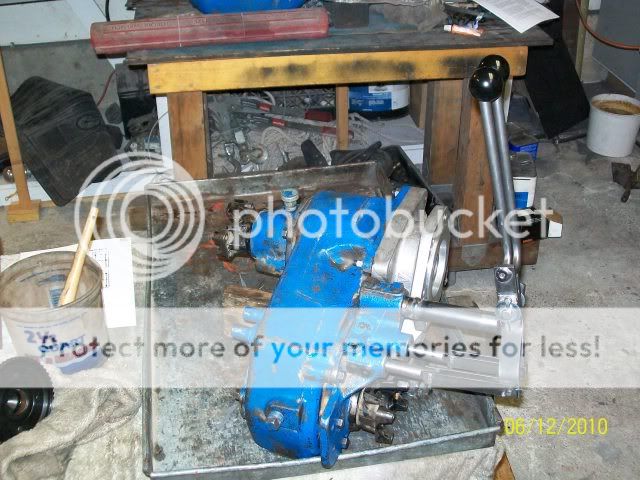

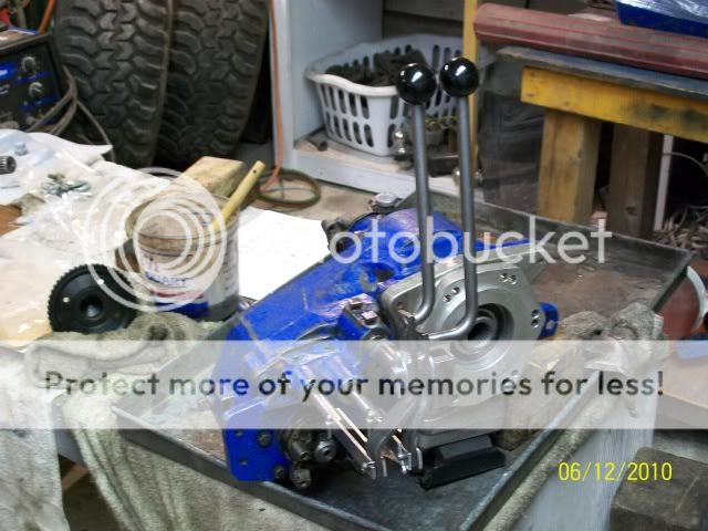

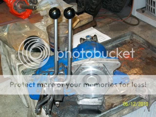

Hey guy's I just thought I would update my post on this thread. I just finished installing my Dana 20 twin stix shifter. I have included several pictures of Don's twin stix shifter that you have been talking about.
While I was at it I put in a master rebuild kit and installed my Advance Adapters Dana 20 to TH 400 trans adapter. I will have to say that the instructions supplied by Advance Adapters fell woefully short on instructions. They completely missed several steps which left 3 items to install in my hands without a clue. Also, I caught a misdirected instruction that only made the install harder than it had to be. I called their teck line and the salesman-teck that I talked to was very short on knowledge of their product and was belligerent and defensive. I finally had to go over his head to get my answers and then only very defensively. I guess they did not want their short comings brought to light. I finally told them that next time I would try Novac. Here's the pic's:
IMG]http://i908.photobucket.com/albums/ac282/lvanyi/Jeep%20Mecanicals/000_0004.jpg[/IMG]
[img]http://i908.photobucket.com/albums/ac282/lvanyi/Jeep%20Mecanicals/000_0003.jpg[/img]
[img]http://i908.photobucket.com/albums/ac282/lvanyi/Jeep%20Mecanicals/000_0001.jpg[/img]
