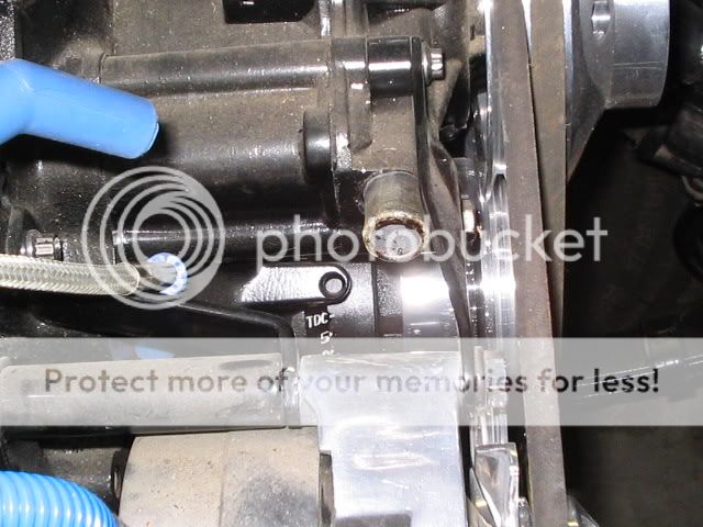

[img]http://img.photobucket.com/albums/v153/fuzzgremlin/CJ%20Alternator%20mount/100_0003.jpg[/img]
AMX69PHATTY
Sometime in the past couple years asked on one of the forums and someone posted that diagram and I saved the image file. Have the 1967-72 AMC Illustrated Parts Manual on CD in pdf format, it has exploded assemblies, but haven't found or bought the 1973-78 Parts Manual or others.
AMX69PHATTY
Thanks Fuzz :t: And the "Mystery Bracket" bolts to the back of the Alternator, huh. First time I've seen that.
Is that a Delco or MotorCraft Alternator ? Looks like a Delco ?
fuzz401
delco and what I have is the set up jeep used in the late 70's

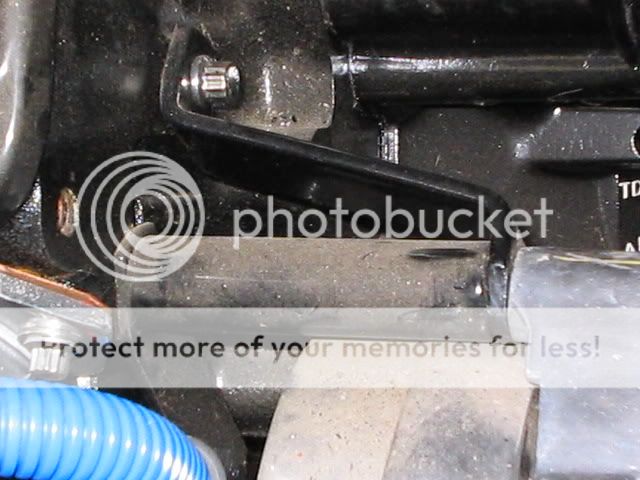

[img]http://img.photobucket.com/albums/v153/fuzzgremlin/CJ%20Alternator%20mount/100_0002.jpg[/img]

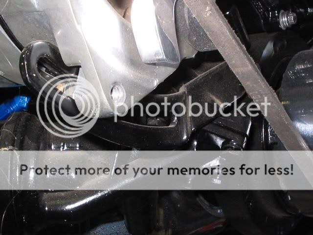

[img]http://img.photobucket.com/albums/v153/fuzzgremlin/CJ%20Alternator%20mount/100_0008.jpg[/img]

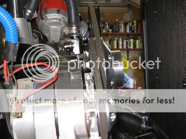

[img]http://img.photobucket.com/albums/v153/fuzzgremlin/CJ%20Alternator%20mount/100_0001.jpg[/img]
[img]http://img.photobucket.com/albums/v153/fuzzgremlin/CJ%20Alternator%20mount/100_0007.jpg[/img]
AMX69PHATTY
Thanks for the additional pictures.
I've got some 1986 brackets, just about the same, but from an engine with A/C.
The extra pics show that I need to get or make the top strap piece that goes from
inbetween back of the Alt Boss & Spacer and zigs back to the head.
Only have the A/C style diagram and that "zig" piece is different and isn't shown.
Those extra pictures help out alot. :t:
