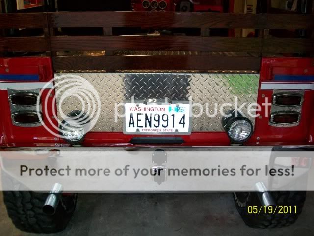

[B]RIPPLES BELIEVE IT OR NOT[/B]
This post is about how to use an old tool in a new way.
Have you ever had trouble cutting sheet metal without bending it up while using snips? I think we all have. Here's how I cut my sheet metal. I use my table saw or hand skill saw. When I first was instructed in this I was told to reverse the saw blade, which I initially did. Then I decided to try it with the normal blade installation and I couldn't find it made much difference. The only thing I would say is that you might need to feed the material to the saw blade a little slower.
If you are going to try this I fully recommend using all safety precautions--eye protection and arm and face protection as it tends to spit hot bits of steal. Also a slow feed is needed or you will overtake the blades capability and jamb it. When done properly it works beautifully. You get nice straight cuts and your sheet metal does not get wrinkled up.
I have even cut .120 square tubing and angle. I use a carbide steal blade and believe it or not it really does not affect it. A plywood blade works best for sheet metal. However, I have used ripping blades with success.
