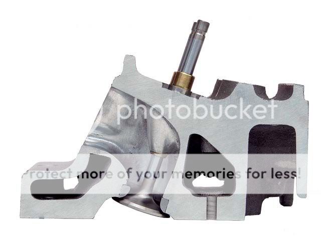

Indy 401-SR The intake floor on the Indy 401-SR head is smoothly radiused in its approach to the valve bowl. It has generous 235cc intake runners -- 69 cc's larger than typical high-perf AMC heads:
[img]http://i908.photobucket.com/albums/ac282/lvanyi/360-401%20Stock%20Heads/154_0412_amc_07_z.jpg[/img]

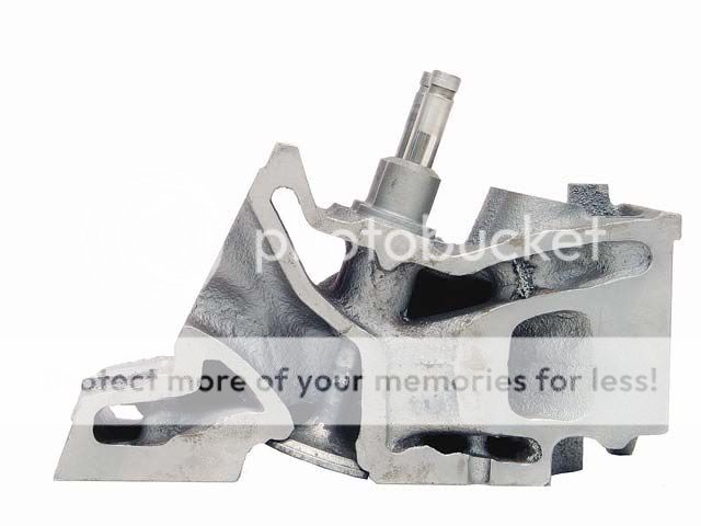

Stock head intake:
[img]http://i908.photobucket.com/albums/ac282/lvanyi/360-401%20Stock%20Heads/154_0412_amc_06_z.jpg[/img]

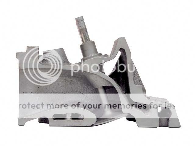

Stock head exhaust:
[img]http://i908.photobucket.com/albums/ac282/lvanyi/360-401%20Stock%20Heads/154_0412_amc_08_z.jpg[/img]

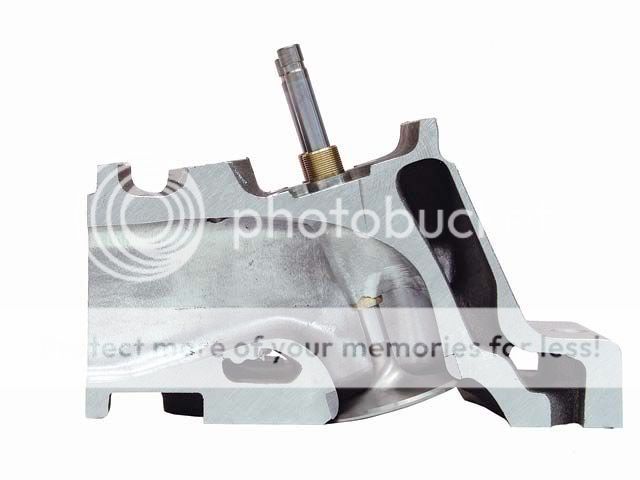

Indy 401-SR
The exhaust side has the most "sweeping" changes. Note the Indy 401-SR head's smooth and consistent cross section. As-delivered volume on the enlarged port is 105 cc's, yet it still exits in the stock location:
[img]http://i908.photobucket.com/albums/ac282/lvanyi/360-401%20Stock%20Heads/154_0412_amc_09_z-1.jpg[/img]
