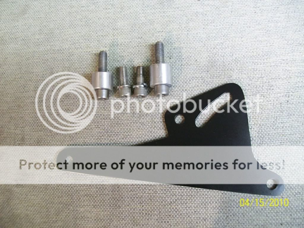

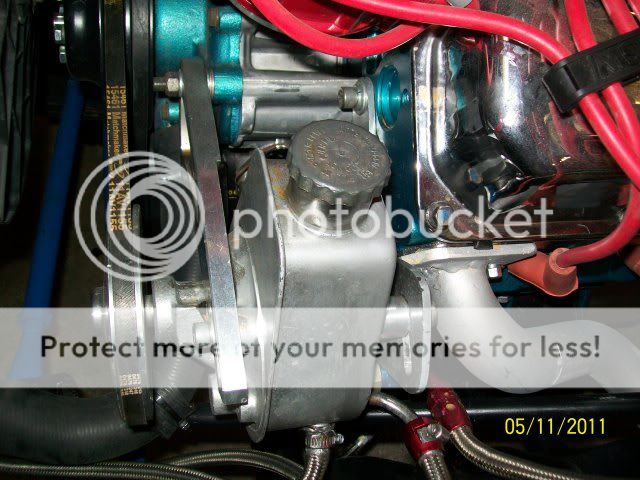

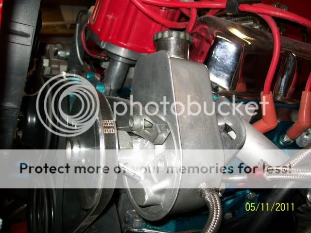

MC. I have a pattern for you of the PS pump relocation bracket I have made. I see lots of guys asking for it so it should be a hot item. I needed more room for my HEI dizzy as do others. It moves the PS pump down about 5-6" It still leaves room for the fuel pump.
It is simple and should be made out of 3/8" alum for rigidity. It could be made easily on your plasma table. It could be offered with 3 socket head 3/8" bolts and 2 round tube spacers to adjust for fan belt lineup.

Here are some pic's of the installation with the new bracket:
