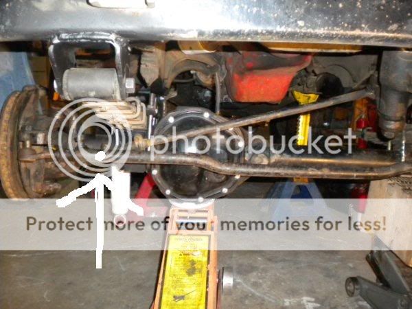

I'm in the middle of a axle swap on my CJ and I'm would like to get some input on my possible design.
I'm in the process of putting a Scout D44, SOA using YJ springs in my 74 CJ. Without changing knuckles and using as much stock parts as possible, I came up with the deisign of putting the draglink end joint into the tie rod. I would fab up a mount and weld it in or find a simalar tie rod with the hole already in. I know newer YJ & TJ use this system so I'm thinking it would work for me. The way I'm set up now would be extremly difficult to put the drag link on the knuckle. But I will go that way if there is no other choice. So my question is, should it work? I drive this about 50/50 on the road/trail.
Edit - It looks like I might be able to use a Waggy tie rod?
[img]http://i423.photobucket.com/albums/pp315/northplainsdrifter/Jeep%20Rebuild/steering001.jpg[/img]
The Waggy tie rod is meant to drop in from the top, not come up from the bottom like the scout. The taper for the drag link would face the wrong way with scout knuckles. Not to say you couldn't re-cut the tapers in either the arms on the knuckle or the tie rod, but it would be more than a drop-in. Remember you're talking control of the vehicle here, so be very careful, failure means loss of control.
One problem with the Scout knuckles is the long length of the arms takes more travel to turn, so you need a longer pitman or your turning radius is decreased.
Here's my CJ with high steer and Waggy tie rod and drag link (both shortened about 5"). Arms are from Tri-County Gear.
[img]http://img.photobucket.com/albums/v475/tufcj/Jeep/SOArfront.jpg[/img]
[img]http://img.photobucket.com/albums/v475/tufcj/Jeep/SOAfront.jpg[/img]
northplainsdrifter
I'm taking the steering issues very serious since my family will be riding with me! That is why I'm asking questions BEFORE I do things!
I thinking the Waggy tie rod might work beacuse at one point I moved the steering box backwards putting the pitman arm behind the tie rod, thus when flipping it over it should have the taper on the back side to match up with the drag link. I might have clearence issuses with the diff cover but I'll see. Still might have turning issues but will see. I have more time than money! I did find a knuckle with a hi-steer arm for $175 so I might have to go that way if all else fails.
Thanks for the feedback Tuf!
The only problem I see there is bump steer. Ideally, the drag link and tie rod should be parallel. The bigger the angle between the two, the more bump steer you'll get.
With the drag link behind the tie rod, you're pitman and steering box will need to be high to avoid the tie rod hitting them during flex.
I tried several configurations (including the Scout 44) before I finally broke down and bought the high steer arms and built my 44. The housing you see is a Chevy 44HD, which is factory SOA, which makes for a very clean install. I had all kinds of clearance, turning, and bump steer issues. My high steer isn't perfect either. If I was to do it again, I'd extend the drag link out to the steering arm. I can't turn fully left if the right tire is at full droop, the drag link is too short. After I installed the high steer, I stood back and asked if I should paint a target on the diff cover (hence the rock slider).
Keep us updated. I'd like to see the solution you come up with.

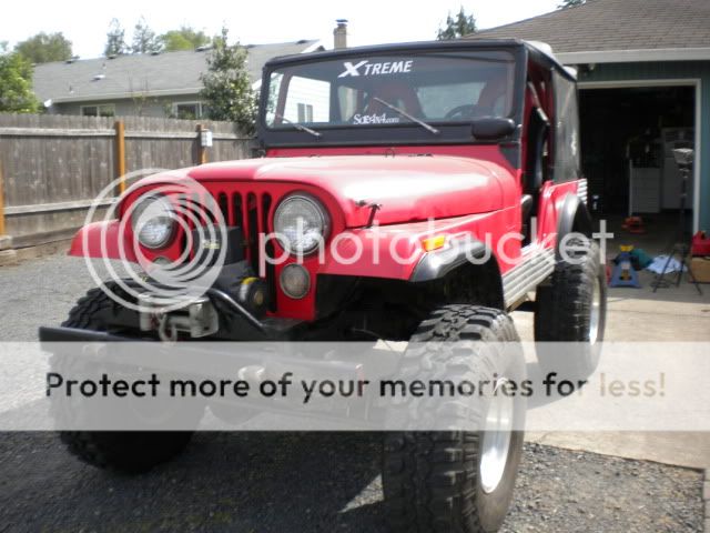

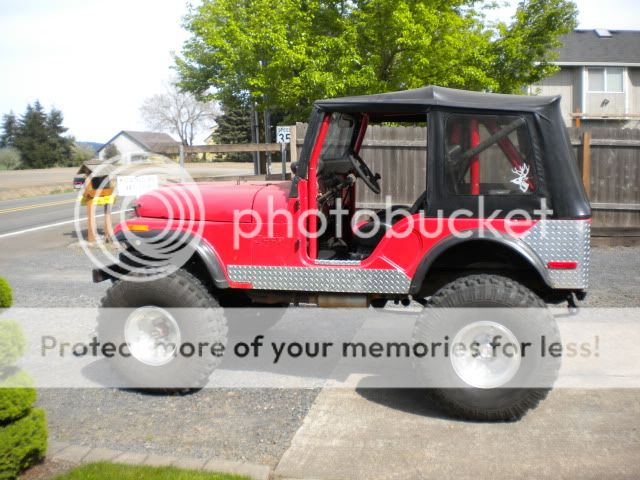

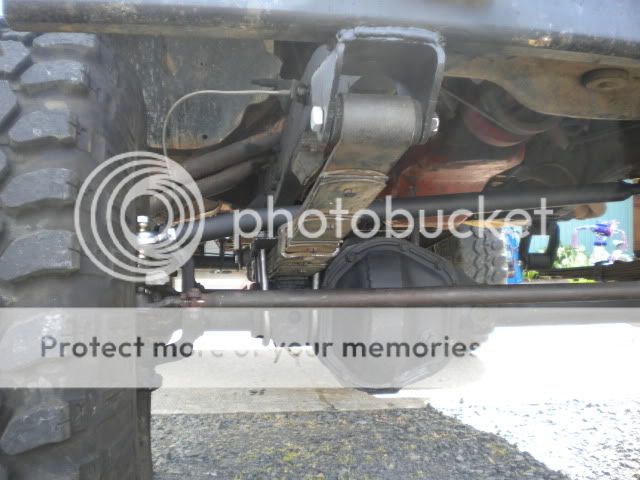

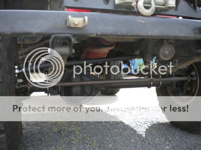

Finally got the CJ out of the gargare after the axle swap. For the drag link I ened up drilling a new hole in the knuckle and put in a heim joint. I like how it came out. I still have lots of little things to do, BUT IT MOVES!
[img]http://i423.photobucket.com/albums/pp315/northplainsdrifter/Jeep%20Rebuild/Jeep014.jpg[/img]
[img]http://i423.photobucket.com/albums/pp315/northplainsdrifter/Jeep%20Rebuild/Jeep015.jpg[/img]
[img]http://i423.photobucket.com/albums/pp315/northplainsdrifter/Jeep%20Rebuild/Jeep012.jpg[/img]
[img]http://i423.photobucket.com/albums/pp315/northplainsdrifter/Jeep%20Rebuild/Jeep013.jpg[/img]
You'll love the SOA. Best mod I ever did to my CJ.
Just looking at the front spring hangers. Did you rotate the knuckles enough to get the caster right? Looks like the pinion angle is good.
I didn't like having the front shackles below the frame on mine, they became rock catchers. In it's second incarnation, I moved the top of the shackles into the frame rail by welding in some tubes, which also lowered the back of the spring, and helped with caster and pinion angle.
Looking good. Got her going just in time to enjoy the summer sun. :t: :t:
northplainsdrifter
I ground and moved the c's to give me about 6 degrees caster, this did allow better pinion angle. Because of the Scout front end, I had to outboard the front springs a bit otherwise I would have moved the shackles into the frame like you said. I used YJ springs in front and XJ in the rear. It's still a little too soft in back, I'll throw another leaf in hopes to stiffen it up. I still have lots a minor things to finish. So far I'm happy with it, it made it to the store and back for a 12 pack!
