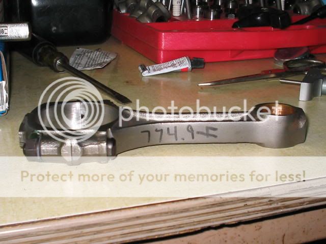

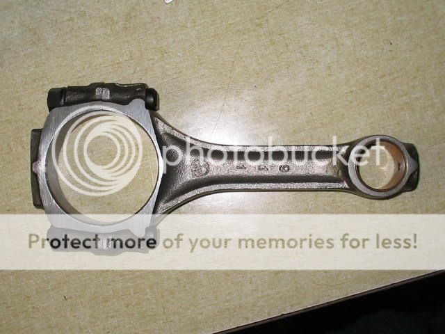

balanced / polished rods with ARP bolts - just get them to flycut the cap were the nuts go to make it flat and use the ARP lube - I am also running bushed rod ends for free floating pistons
[img]http://img.photobucket.com/albums/v31/fuzzcj7/Picture011.jpg[/img]
[img]http://img.photobucket.com/albums/v31/fuzzcj7/Picture012.jpg[/img]

[quote]I am runing the factory rods shifting around 6000 - 6500 rpm
balanced / polished rods with ARP bolts - just get them to flycut the cap were the nuts go to make it flat and use the ARP lube - I am also running bushed rod ends for free floating pistons[/quote]
Thanks fuzz for the info! I am going to go that route for sure, where did you get the bushings or did your machine shop supply them?
