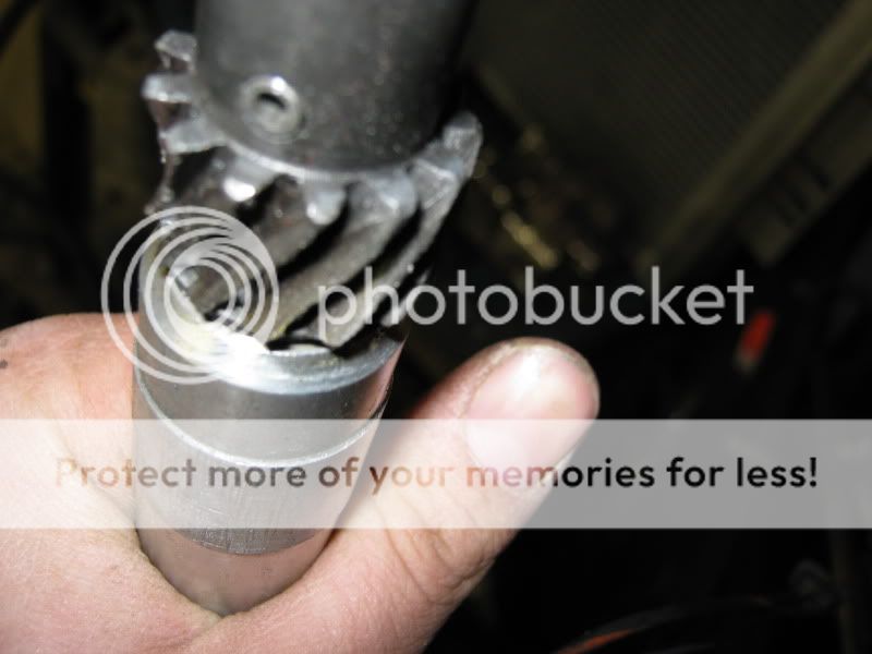

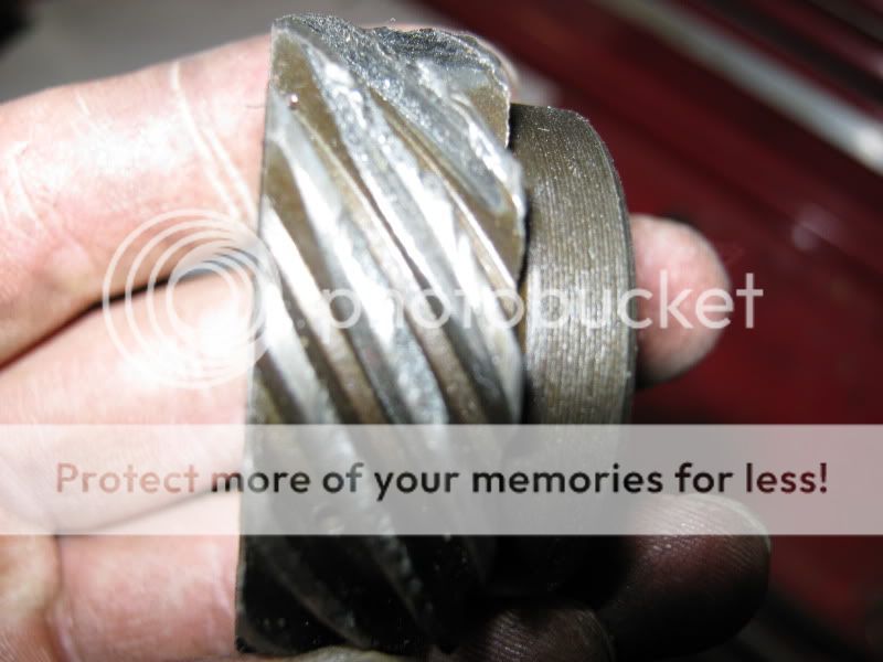

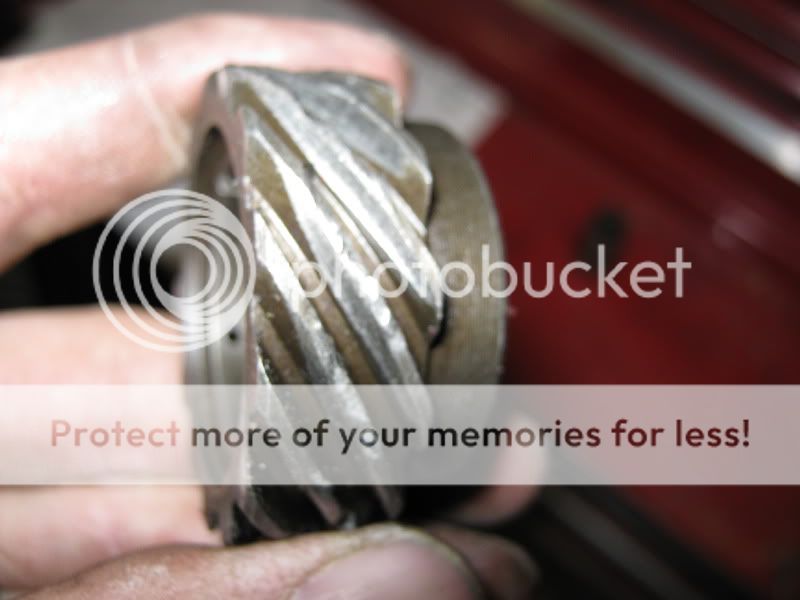

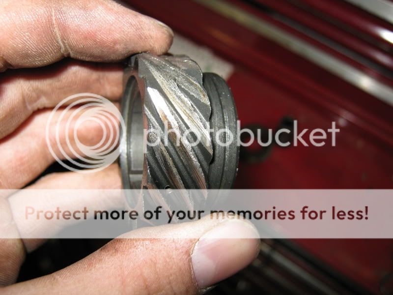

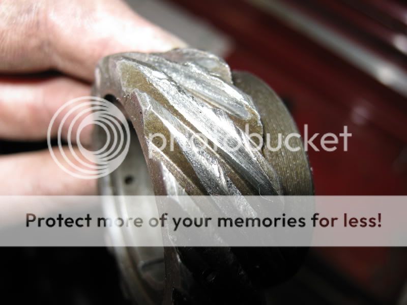

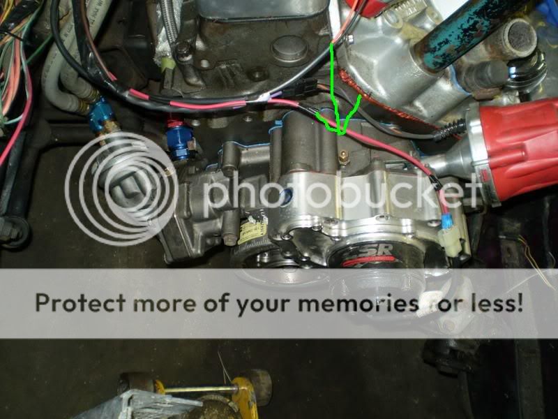

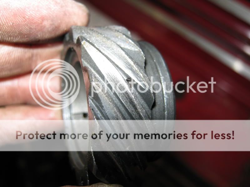

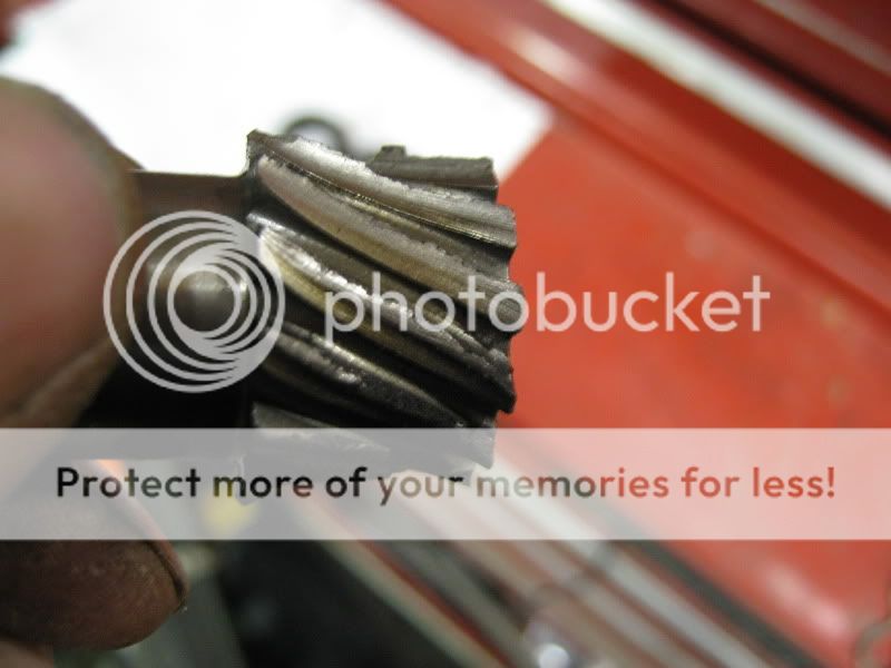

ok so i am going to post some pictures of the couple sets of cam and dizzy gear that got chewed up in my motor. I know that oilling was not the issue because i had between 40psi at idle and 80psi at high rpm and i had the little hole drill above my dizzy for extra oiling
[img]http://i43.photobucket.com/albums/e353/pongopig/dizzyoiling.jpg[/img]

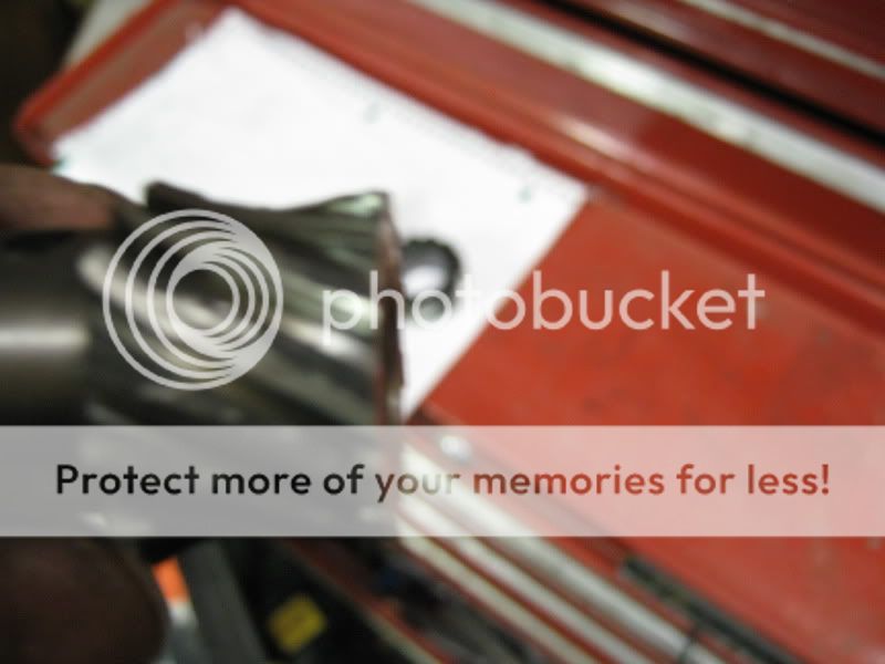

so my question is what else could have caused this. if i order the matched cam gears and new timing cover from bulltear will that fix it? i use a msd dist ( the amc style one).

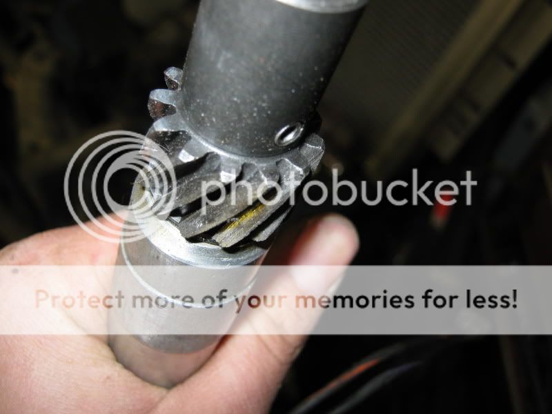

these two were a set both amc brand gears

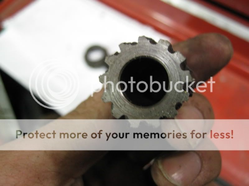

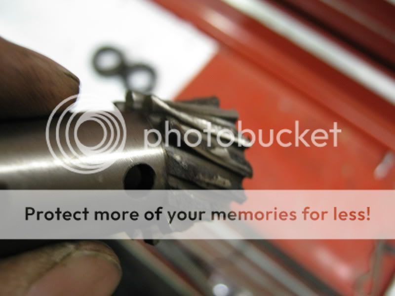

and these two were a set the dizzy gear was msd and the other one cam with the motor
the first set lasty say 5 or 6 pass down the track and the second last 10 -15 can exactly remeber

Several things.
Do you have the positioning dowels in place for the timing cover? They are critical for the proper alignment of the gears.
The dizzy gears drive the oil pump, too much pressure puts too much strain on the gears. My AMX ate a set with pressure similar to yours. I went back to a standard pressure relief spring when I replaced the gears and haven't had a problem since. Also make sure the relief plunger is in right (point forward), and it moves smoothly in the bore.
Gears. They MUST be a matched set. There are at least 3 different known tooth pitches used by different manufacturers. Different mismatched pitches = extreme wear. I think the MSD gear is a variant of a Chevy gear.
Make sure the oil slot in the upper cam gear is open. A lot were blocked by casting flash. This feeds oil from the front cam bearing thru to the inside of the dizzy gear. There's more than enough oil flow if this passage is open.

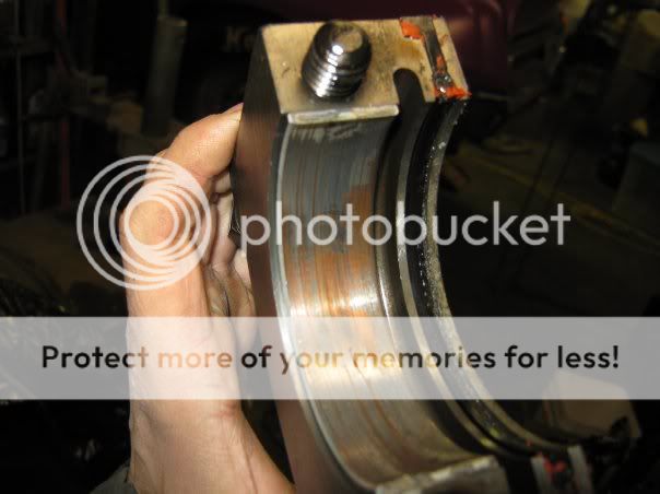

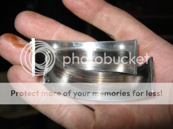

here at the last main and #8 connecting rod bearing

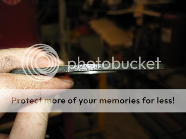

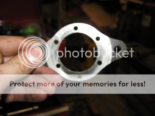

also i had a anti cam walk plate in there
[img]http://i43.photobucket.com/albums/e353/pongopig/my%20javelin/18037_396599060506_780350506_104158.jpg[/img]
[img]http://i43.photobucket.com/albums/e353/pongopig/my%20javelin/18037_396599065506_780350506_104158.jpg[/img]
would that have affected anything?

This is what I did..pulled everything apart, washed everything and brushed all the passages replaced the cam bearings, checked cam & lifters replaced mains and rods. :smile: But I'm picky about a clean engine inside. Those bearings look toasted to me...my guess is the cam bearings are bad also as those get the oil first.

you may have a partially blocked oil galley. AMC motors oil the mains from the lifter galleys and cam. they are backwards of most others the oil flows to the cam first and then down to the crank and rods from the lifter galleys. The first bearings to suffer from oil starvation are the ones at the end of the line the 7 and 8 rod bearings and the last main bearing starve first from lack of pressure or blocked passages. High rpm's regularly will make the problem worse.
