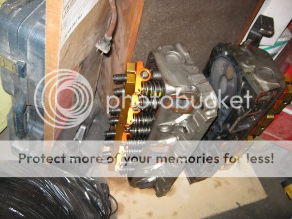

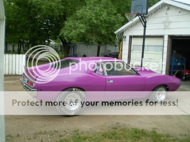

and the rest of the pictures are here. My car has changed alot from those pictures now tho. i have since put in a sheet metal dash in, and in the process of putting in ladder bar system, lexan windshield , and a wire "tuck" also. hoping for mid tens this coming session

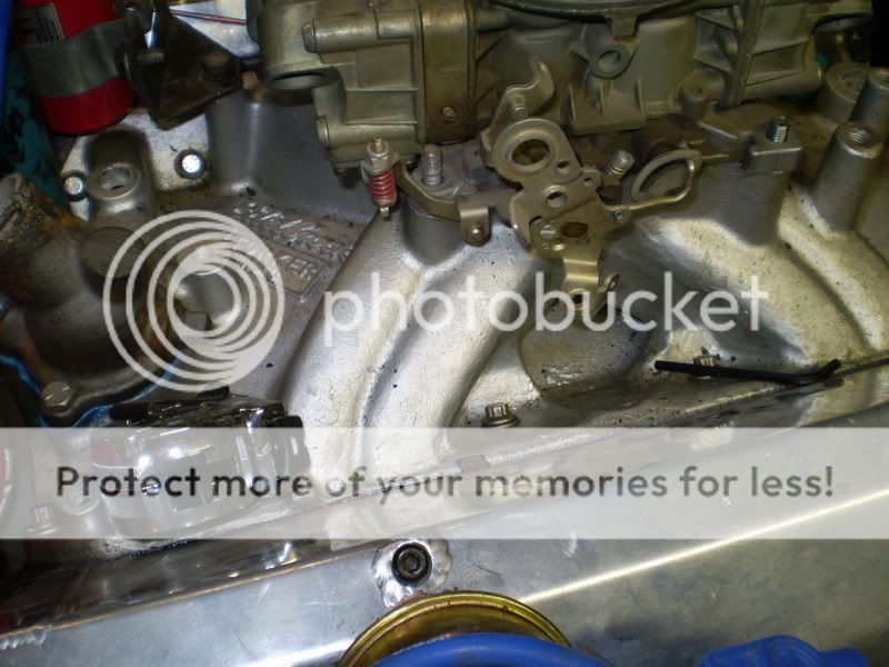

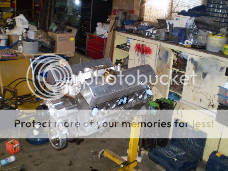

Oiling system... can you give me a low down of what you are using?
amcjunky
bulltear timing cover
high pressure spring
#533 dry sump midplate from bulltear
milidon deep sump oil pan with there external dual line oil pick up
[url]http://www.milodon.com/oil-system/chrysler-amc.asp[/url]
i also drilled a hole right above were the cam and dizzy gear meet and have tapped it for an oil line.
hope that helps....o and at idle when hot i get 40psi of oil pressure but my car also ides at 1200rpm and close to 70 at WOT. i run 20W50 lucas racing oil and a lucas zinc addtive
mikesramblur
very nice. is that a mezire waterpump? what cam/convertor?
amcjunky
nope its a csr
and 596 lift and 262 dur intake and exhaust with 110lsa
my converter is at 4500 i want to put it on the dyno soon to see if i need to change it or not
