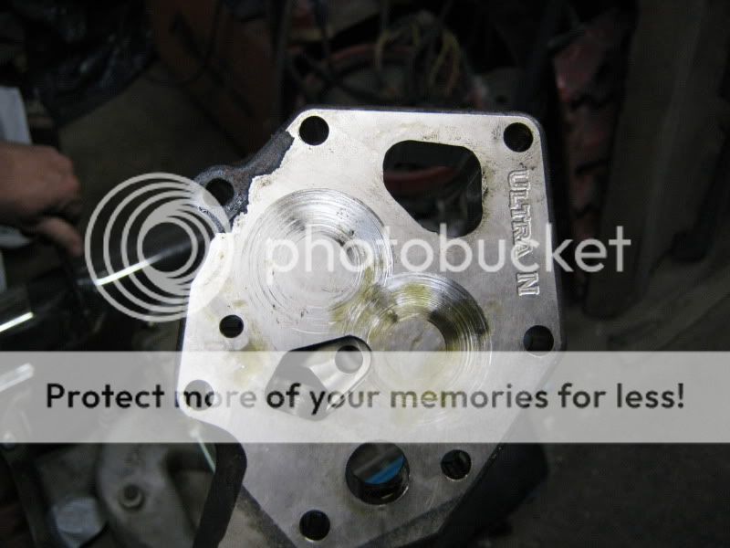

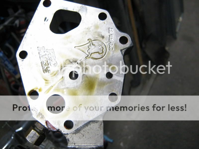

cool i am probly going to have to buy that lol also i am uploading a picture and what i need to know is with this new timing cover pkg can i use this peice with it if i buy it
[url]http://www.bulltear.com/catalog/product_info.php?cPath=21_35&products_id=136[/url]
i am pretty sure this is what i am going to get just i have some seconds thoughts so i figured i would ask
[img]http://i43.photobucket.com/albums/e353/pongopig/my%20javelin/IMG_0011.jpg[/img]
[img]http://i43.photobucket.com/albums/e353/pongopig/my%20javelin/IMG_0010.jpg[/img]
thanks for the help
