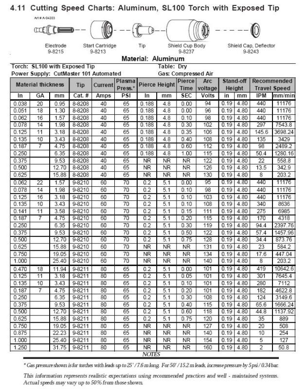

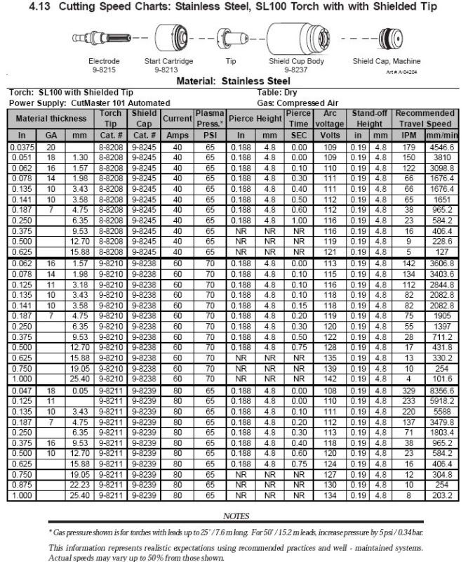

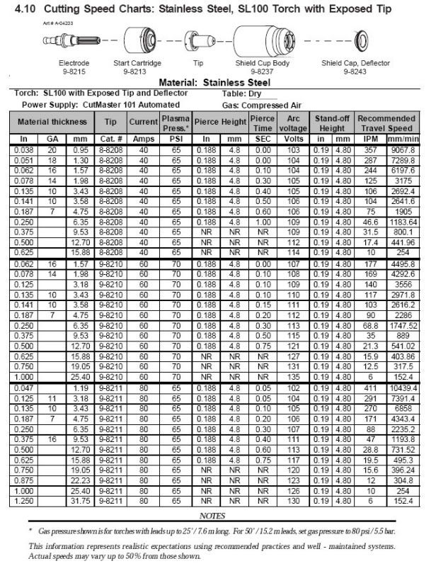

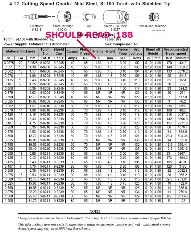

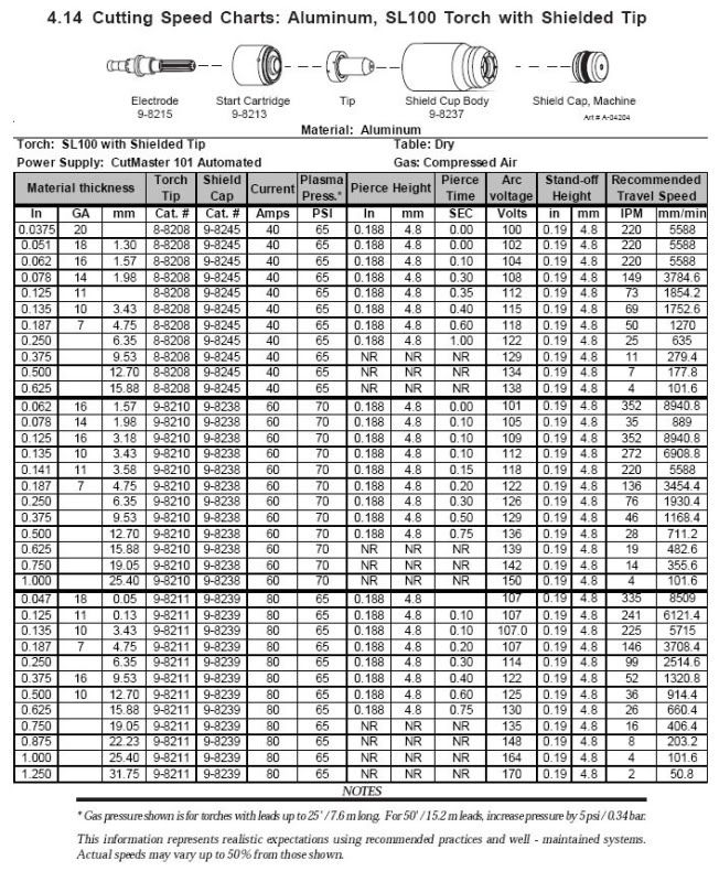

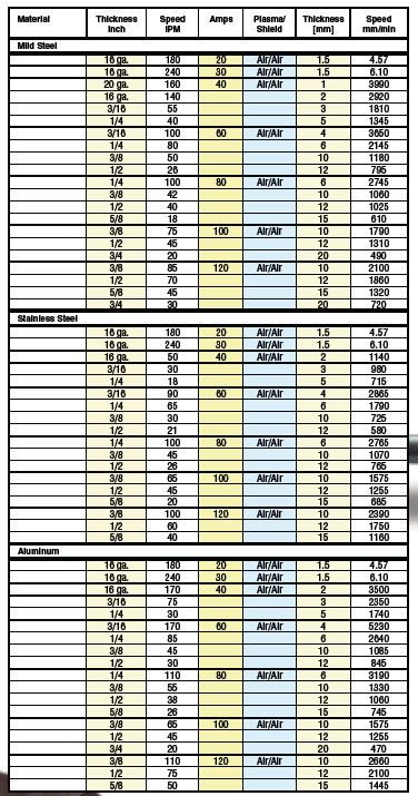

Thermal Dynamics
[img]http://i2.photobucket.com/albums/y29/bulltear/plasmapresets.jpg[/img]

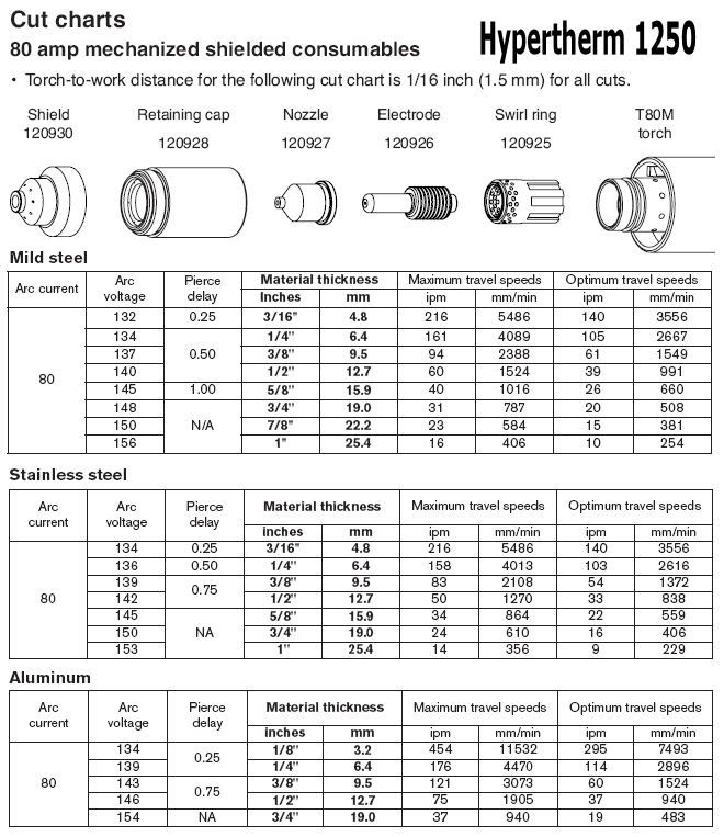

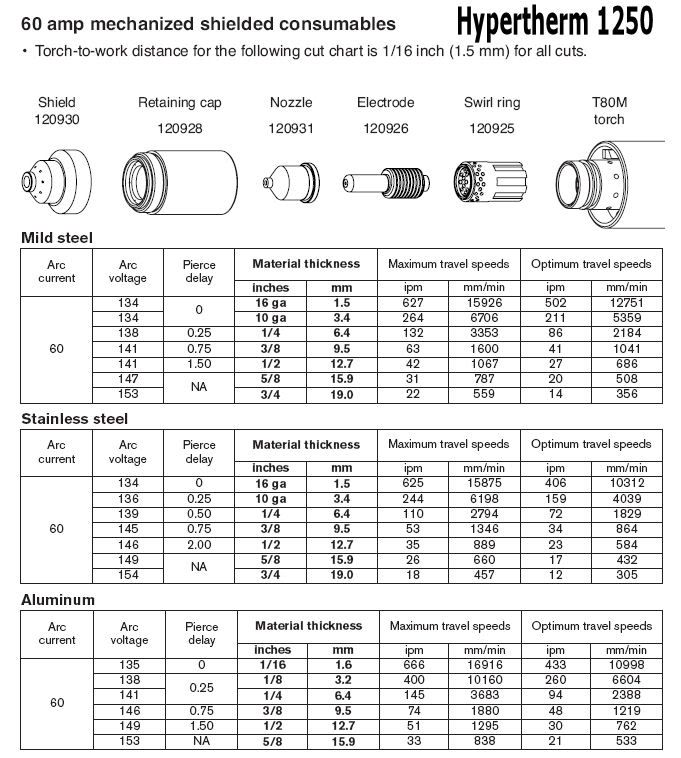

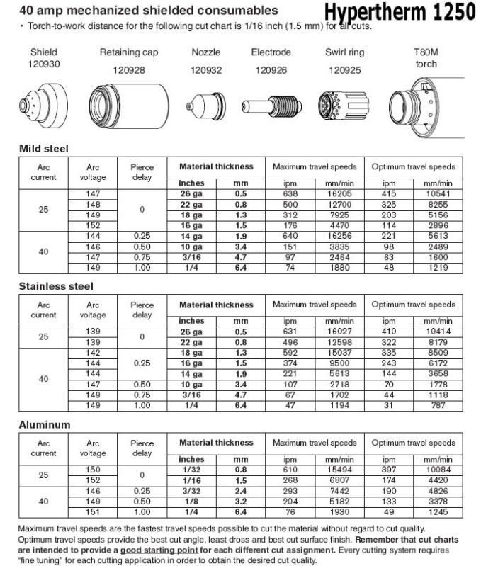

Have a table like that for a Hypertherm 1250?
[img]http://i2.photobucket.com/albums/y29/bulltear/hypertherm12502.jpg[/img]
[img]http://i2.photobucket.com/albums/y29/bulltear/hypertherm12501.jpg[/img]
[img]http://i2.photobucket.com/albums/y29/bulltear/hypertherm1250.jpg[/img]
