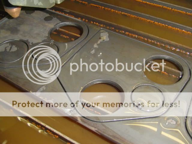

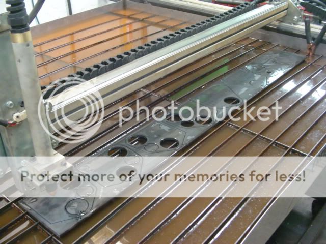

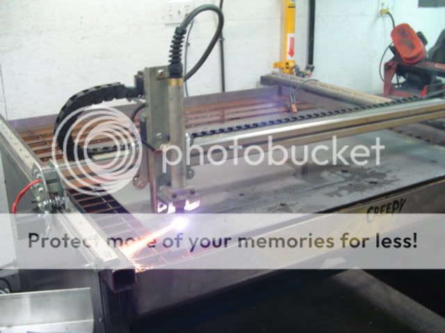

Table is workin sweet. No problems once major construction was completed. Still picking at stuff like limit switches. You need two on the gantry ends, I racked the shit out of the gantry trying to home to one switch. Didn't like that, both motors need an input. one switched direction and the other kept going straight! The table seems pretty tough up against the inevitable crashes.

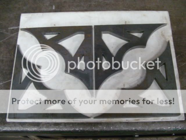

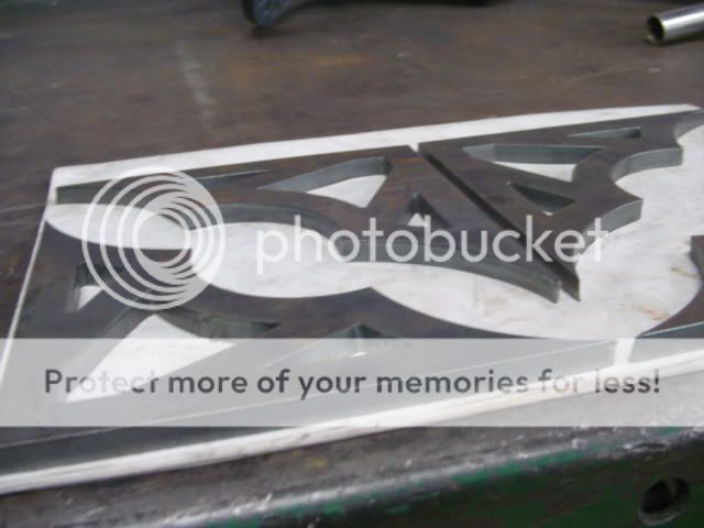

you can see the leadin/out in the windows of the closer piece. not bad.

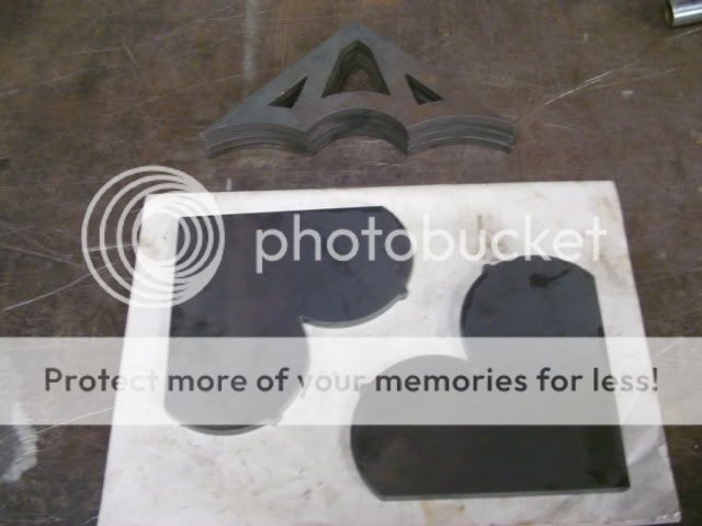

Decorative Celtic art for a fundraiser for my Gf's Scotland trip. Failte means Welcome in Gaelic. 16G mild steel @ 225imp. I don't use the THC on this intricate stuff, only on long travel cuts.
