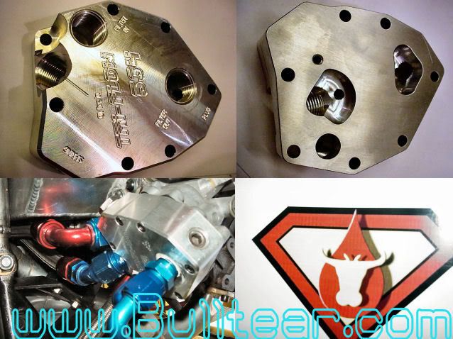

After 4 months my engine builder calls me and says I have good news and bad news..... Good news.. motor is finished minus valve covers (legends from bulltear) and the bad news is that when priming with a drill and break in oil the pressure goes right up to 60psi and after a few minutes drops to 20psi and fluctuates low. I am running a new Bulltear "Ultimate AMC oil pump (with upgrade options) $499.00. This is a collaboration of the best we make and offer in our shop. The kit includes a Ni plated oil pump/timing cover, A set of our HRC oil pump gears, A Ni plated #626 oil filter relocation plate, A Derale dual filter remote mount, Fittings for the plumbing, A new polished plunger and a new pressure spring and the gaskets for the Timing cover to block and the timing cover to water pump!"
My engine builder thinks the problem is in the oil filter relocation plate. Any advise?

Welllll...... Put the stock oil filter adapter on and "we have 60-70psi. We took apart the remote housing and could not see a problem. Untillll... I noticed the #'s on the housing...... 534 WTF..... Bulltear sent the wrong adapter plate!... The "ultimate kit" comes with the 626, or supposed to. My engine builder did not know this. He just put on what was sent to him. Problem fixed...... Wrong part.
Negative the #534 replaces the #626 by use of 1/2npt plug supplied with kit. If you read through the explanation it answers your issue and helps diagnose.
cj5doc
Wrong part ..... and no further argument! What the heck is a '626' and a '534' anyway with no description... just numbers.... no instructions. I even asked by phone and email for instructions. How do you make a custom piece with different parts not assembled and missing the plunger and the spring and expect someone to know the difference between the '626' from a '534' if it was shipped wrong? BTW...No mounting screws were ever sent with torque settings that I had asked for. The "Ultimate kit" should have "Ultimate instructions" for the novice or the expert and the user can throw them away if they dont need them.

Instructions are engraved on the part "To filter" "From filter""Spring""plug""oil line in". We do this so you dont have paper instructions you can loose. The #626 is the same part minus the auxillary hole to pickup oil from the oil pan. When you use a #534 in place of a #626 the only change is plugging the "Oil line" hole.
The "Oil line" in is the pickup from the pan (not used unless you have a swiveling pickup) and is the only difference between the #626 and #534. The "plug" hole can either be plugged or used with an oil accumulator or oil pressure sending unit. The "Spring" hole is where you put your spring and plunger and has a very nicely machined mating surface for the plastic or copper washer. The "To filter" is where you send oil to the remote filter and the "from filter" is where the oil comes back. You dont need a torque wrench on these items they just need to be snug. Sorry you didnt have any luck.

Those are pretty pictures =D>
