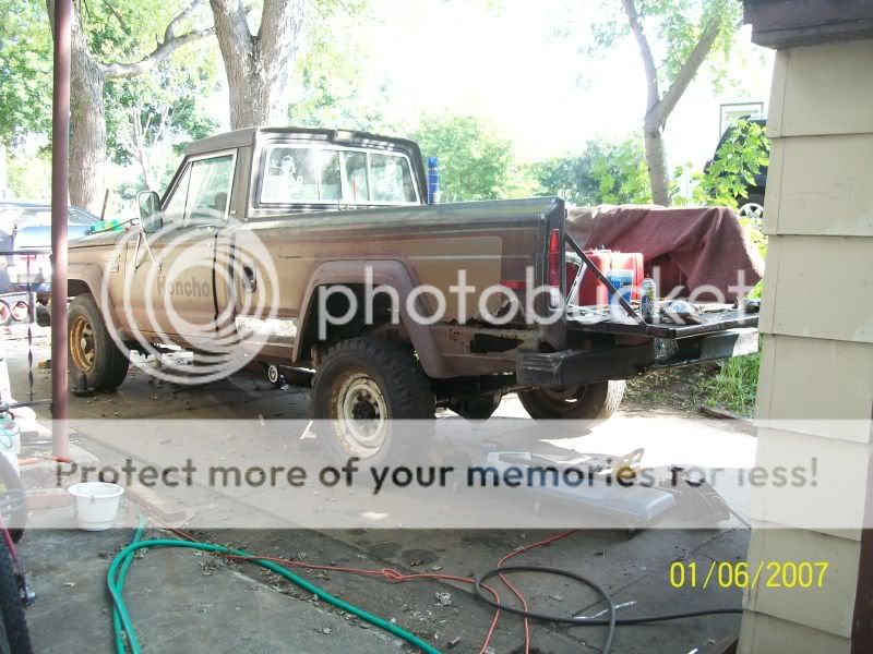

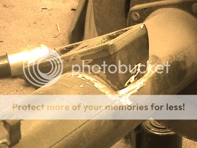

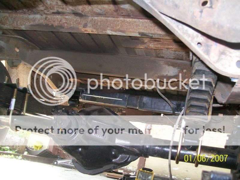

Well slow going but it's going to fit. :lo1l: Have the front mounts worked out, just have some more grinding, some sandblasting and welding. Then there's the back mounts to work out.

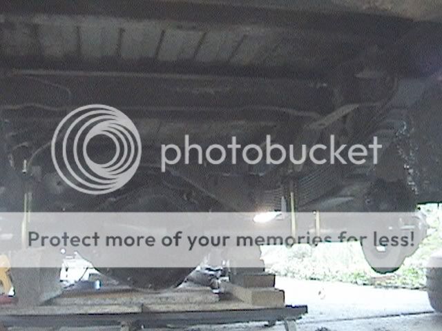

That little creeper sure is holding up good considering the weight. Wondering if shocks are even necessary with these springs. ha ha I think my carrying capacity just jumped dramatically.

I hope to use the stock quadra-trac cross member to mount the np205...at least in some capacity. I suppose a hole in the floor now and maybe a short shifter thats out of the way. No twin stick here though...Going to try CV joints front and rear...swapping out the slip yoke on the transfer case. Going to be some spendy drive shafts I suppose. Also need to swap out the Dana 44 gears up front to a 4.10 set (already have)...but if anyones got a dana 44 locker for cheap? :idea:
