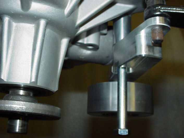

[SIZE=6]Idler pulley and bracket installation[/SIZE]
The idler pulley bracket uses the factory power steering bracket retaining stud found in the front of the motor on the drivers side upper bolt of the water pump. This stud is 3/8-24 fine thread on the outer end. This stud has an incorporated hex head and has course threads. Its main job is to tighten the timing cover and water pump and on the outer most end mount the power steering torque arm. We will be using this stud for the serpentine idler bracket installation as well as the lower 3/8" water pump bolt hole but not the lower 3/8" bolt.
[IMG]http://i2.photobucket.com/albums/y29/bulltear/idlerserpinstall2.jpg[/IMG]
Remove the upper 3/8-24 retaining nut on the power steering torque arm located onthe water pumps drivers side. Remove the 3/8 bolt located directly underneath the water pumps main cavity. Place idler bracket on the power steering torque arm stud and let it swing. Using the 6.5" long 3/8" bolt and the 1.25" long aluminum spacer install the bolt thorugh the idler bracket and the spacer behind it. Tighten this bolt to 35-40ft lbs. Next using the OEM 3/8-24 (fine thread) nut tighten the top hole of the idler bracket against the power steering torque arm and tighten to 35-40 ft lbs.
