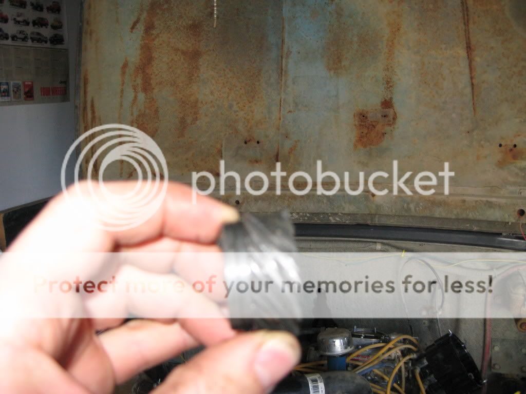

I made sure the dowels were alright, I bought new tight fitting roll pins at the hardware store & tapped them in before tightening the timing cover on with a mallet. the holes int he gear I did'nt check but the keyway was aligned properly. since it only fit one way...
Im going through the cam & oiling passages/galleys monday after I get out of work in the morning. going to use some pipe cleaners & "WD-40", "Deep creep" to see if I can't free up the passages some more.
I have all the pipe/fittings to do the oil splasher should need arise.. but doubt I'll be able to make it work effectively. will probably bleed too much oil pressure.
