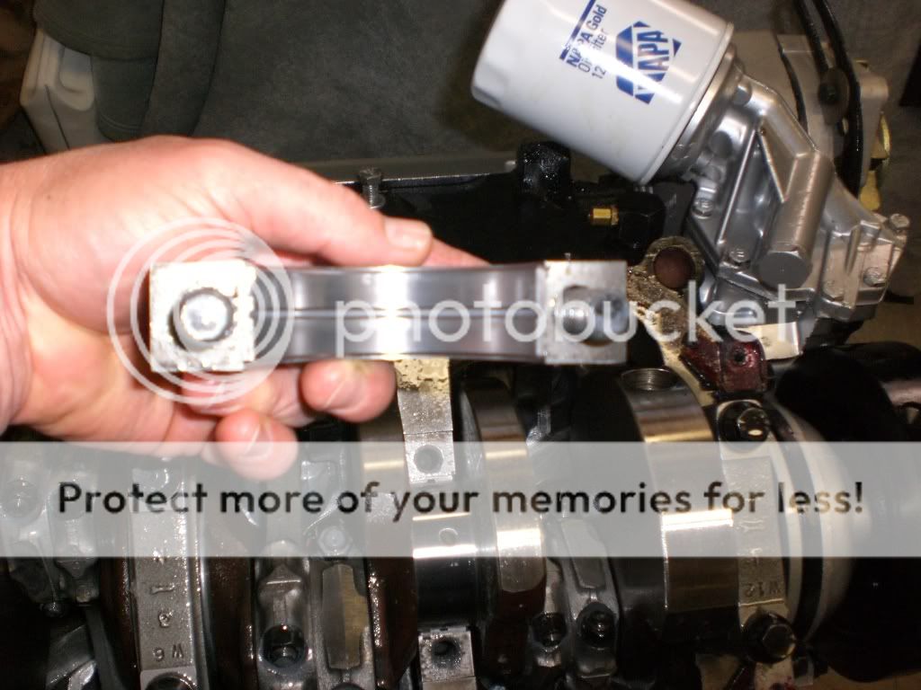

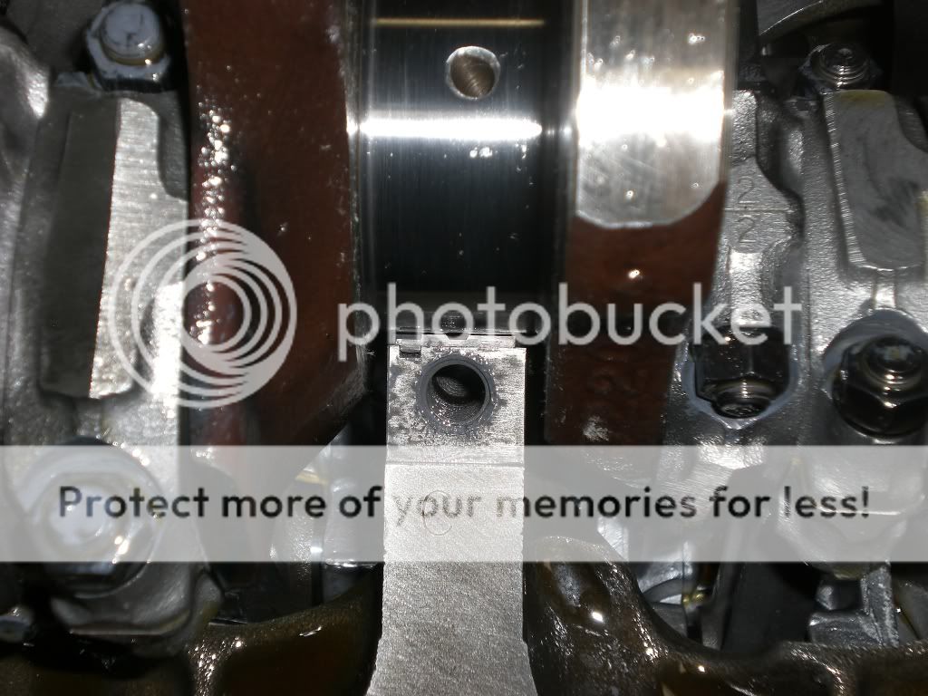

O.K., I pulled the oil pan and removed main caps two and three, so far. The mains were assembled with ARP bolts and moly lube by the machine shop. The ARP catalog lists 3 separate torque values for that size bolt: 95, 107, and 119. I believe factory torque specs are 95-105 so for plastigauge purposes I used factory torque specs on #2, which I believe may be excessive for ARP bolts/moly, and 95 lbs/ft for cap #3. The reading on cap 2 indicates between .002 and .003 clearance (even with the higher torque of 105), and cap 3 indicates .002 at the 95 lbs/ft torque. This seems sloppy for a new build, but the clearances seem to indicate that standard bearings were not used on an undercut crank, correct? Also, the bearings have an oil groove running the entire circumference of both bearing halves, is this correct? Should I also be concerned about connecting rod clearances as it relates to excessive oil bleed off?
