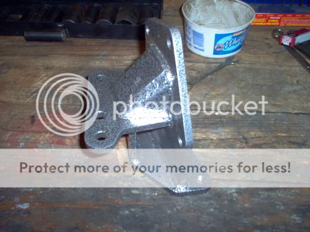

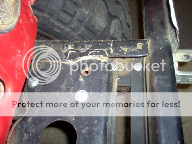

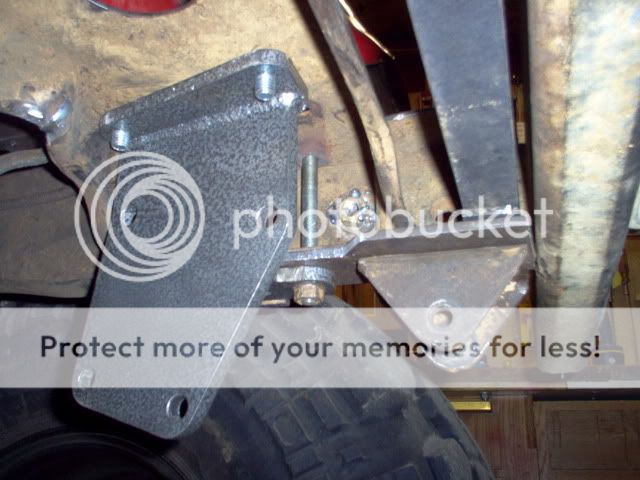

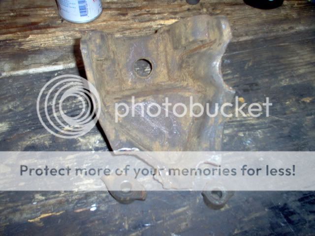

northplainsdrifter The last time I was out I broke the steeing box off the frame of my 74 CJ5. The 72-75 CJ's have a cast mount that is sandwiched between the frame rails. It only utilizes three of the four bolts on the steering box, not very strong. After I put the 35's on it wasn't strong enough, should've had a brace. I bought a after market brace for a 76 & up which is different but I should be able to make it work. At the same time I'm going to do a shackle reversal so I can hopefully get this thing to drive better down the road. It should be a interesting project as I have primitve tools, welder, some air tools and a sawzall. And the interweb for a some helpful hints. I'm not buying a SRS kit. For the SRS I'm taking the spring mounts from the back and putting them up front. I'm moving the spring mounts forward an 1" or so to clear the new steering mount. This is changing the pitch of the 3rd member and moving the axle forward which should keep it from hitting the inner fender wells. The article I read said I might have to put some shims in to adjust the driveline angle. I was wondering if anyone else has done this type of SRS? Any hints would be appreciated. I will post some pics of my progress later.

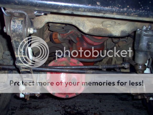

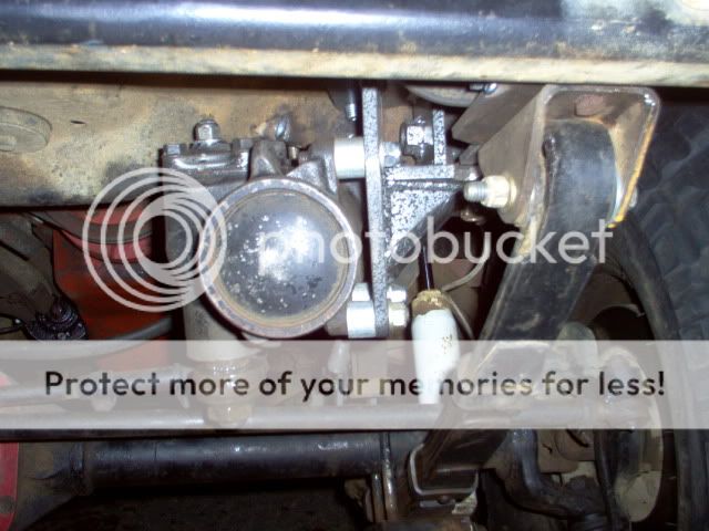

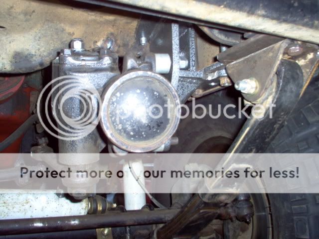

northplainsdrifter I worked on it all last weekend and only ran into one problem. 🙁: It's the only thing I didn't check while fabbing things up. Couldn't get the tierod to connect to the pitman arm because the draglink was in the way. When I moved the axle 2 1/2" forward to the end of the frame and the steering box back about an inch it made the rods cross each other. Damn it! The easy way was to switch the rods around. I had to adjust the toe in/out but it made the steering alot more responsive, probably not a good thing. This is not permanent, just a temporary thing till I can figure the best way to change it. Gofoeit Inc makes a kit to move the rods on top of the knuckles, might do that. http://www.goferitoffroad.com/products.htm I did take it for a spin and I'm really happy with the SRS! It drove straight down the road! No more two hands and white knuckle trying to keep it straight! Here's a few pics. I still have to weld everything up.
tufcj I didn't think of that. When I did the SOA/reversal on mine, I tried the tie rod/drag link in the stock position with a dropped pitman and they did interfere. That's why I went to the high steer. I did it using shortened Wagoneer parts (solid steel) instead of the stock CJ stuff (hollow tube). I think the way yours is now, the tie rod will hit the pitman when it flexes, so no 4-wheeling until it's fixed. Bob tufcj
