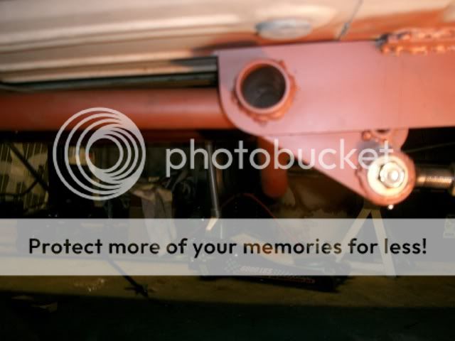

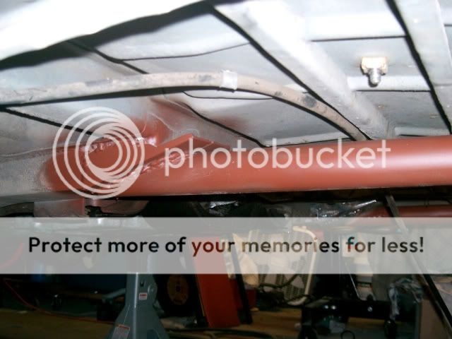

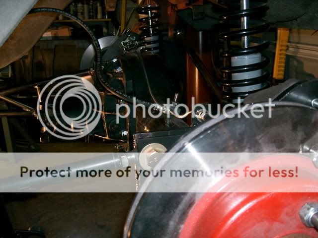

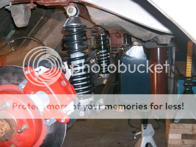

Pulled out the stock torque-tube suspension and installed a Ford rearend, ladders, coilovers and panhard. Also connected the subframe. My under car (overhead) welding is butt-ugly but I had the welds inspected by a pro and he deemed them sound. Here's the pics of the work I did:

Nice job :lo1l: & sweet car!!!

I love that body style. Nice meats on the rear, looks great.

what did you set your pinion angle at? i just finshed mine and set it 1/2 deg down
ed455
1-1/2 degrees. I have always gone between 1 and 2 degrees on the street. If I was racing it could probably go anywhere from 1 and 3 degrees (in a ladder bar car). There's a TON of different opinion on this, so I can only speak for me.

Thanks. Just Put 275/60R15's on the back a couple of days ago. With the skirting or those fenders, that's as big as I can go without mini-tubbing.
